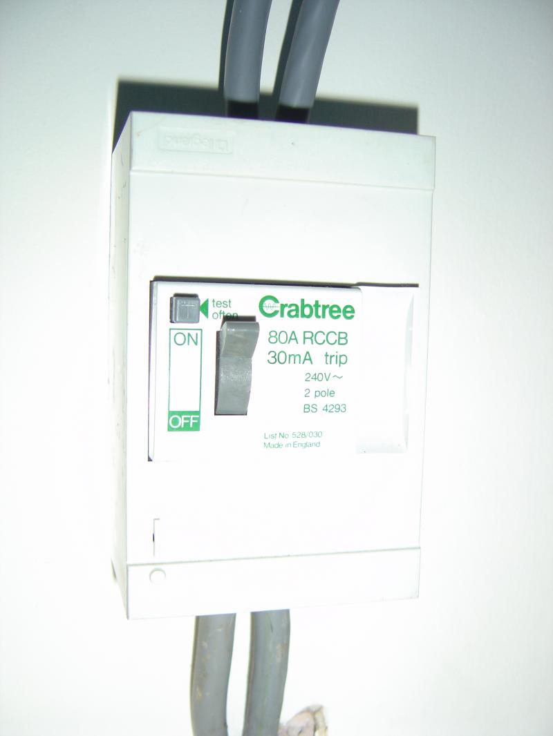

I had a new CU installed when I had my kitchen replaced recently, as the old one was of the rewirable variety. I never saw the guy who did it, but I do have the Part P paperwork.
Last night the wife turned the steamer on to cook the veg for dinner, and the whole house was plunged into darkness. Nothing had tripped in the CU, but a 30mA trip which had been left between the meter and CU had tripped. (I describe it as a trip because I'm not sure what it is.)
No realising the issue was the steamer, we plugged it in again. This time both the external trip, and half the CU tripped.
My question is should the extra trip have been removed? I can see the attraction of it being there for the guy working on the CU change, but should it have been taken out?

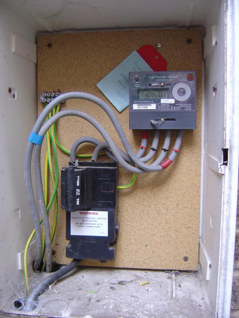

If you can upload a picture of your CU, and this extra 'trip', and also any pictures of the service head (the bit that sits on top of the cable coming in from outside that then goes to the meter etc), we can probably tell you if it's required or not...
Thanks for your replies. Have taken some pictures as suggested. I think they are self explained. In case anyone is wondering, the earth cable which goes through the cutout with the incoming feed is to earth the gas supply.
No, that trip should not be there and should have been removed. Even if you were on a TT supply, the fact that all your outgoing ways in the CU appear to be protected by a pair of 30mA RCDs negates the need for another device upstream.
