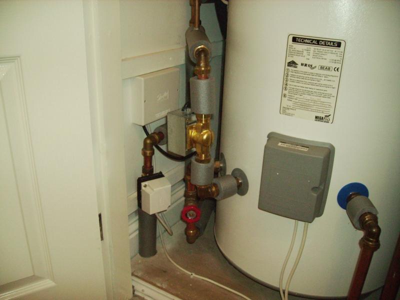

Hi, new on here but have a valve which appears to be in the primary feed to the hot water storage tank which opens / closes every 2-3 min's clunking with pressure when closing. I have turned the main pressure down to quiten it a little but would welcome any ideas why does it keep operating so often?

may have the wrong terminiology for valve, but it is electronic in the airing cupboard and appears to be regulating flow from main supply to tank via primary inlet to storage tank

if its the first one (the two port ) then there is a chance its been fitted the wrong way round.
It is not a new installation, nearly 5 years old and has only recently started the banging, if remove the electronic bit and turn the valve manually it bangs / hammers but less now mains pressure is lower. Has not done it since turned up the room stat to max. But when turning back to normal temp comes straight in
To reiterate, the mains pressure should have nothing to do with this, and what you're saying is getting thoroughly confusing. Can we perhaps have some photos of the offending item and the area surrounding it?
from your photo it looks like the danfoss valve is for the central heating (there is what looks like a honeywell valve adjacent feeding the cylinder)
have a look at the danfoss valve, there will be an arrow stamped on the valve body,whitch way is it pointing? from the looks of the photo it should be down
