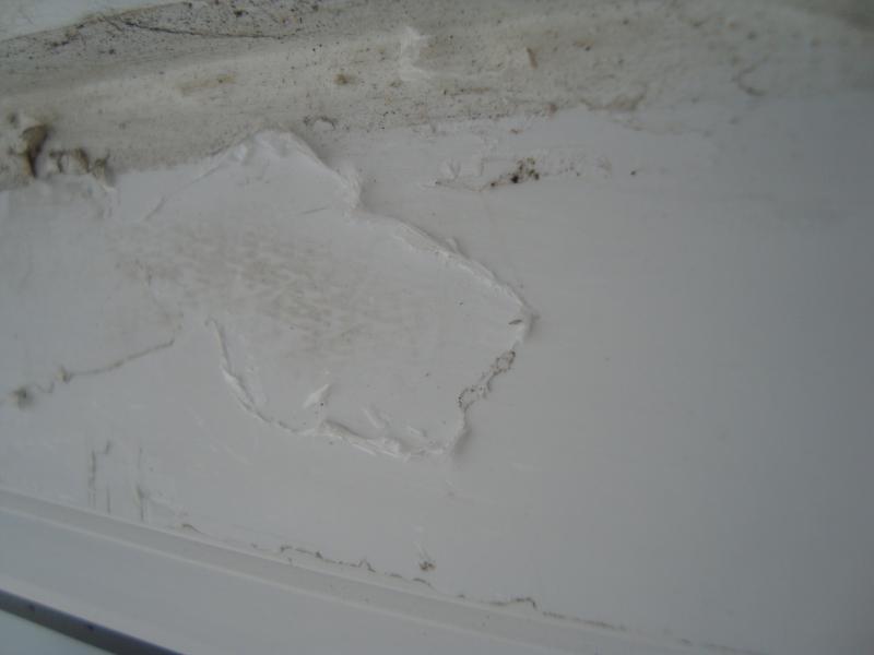

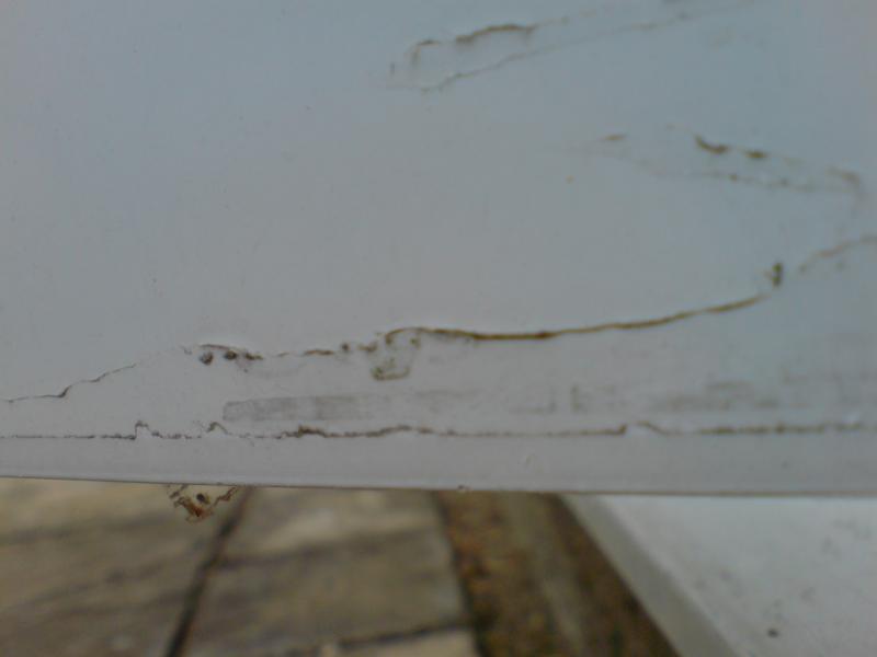

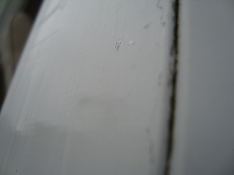

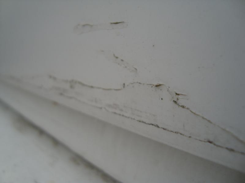

Just moved into a house that has two sets of French doors at the rear. Just got round to giving them a clean and noticed that what looks like the protective film is still attached to them.
The only problem is it seems to well stuck/baked on. It does come off in very small bits with a thumb nail. Any other scraper I've tried to use scratches the UPVC. I've tried UPVC cleaner, while it does clean the film it doesn't remove it.
Any ideas on how to get rid?
I've attached a few photos to show what i'm trying to describe.
Cheers
Plastic scraper and plenty of patients unfortunately, have come across this a few times in my time, shoddy fitters want sackin for leavin it on. Went to a job once that Coldseal had just done, went to peel the film off and it left the coldseal logo on the white pvc like a tattoo

Was hoping for a miracle cure. Cheers for the replies.
There are solvents you can buy that are very good for removing sticky labels from products: sold by Maplins and similar cos.
No idea if it would work in your situation as the glue is going to have been baked/aged.

Seriously I have a major major problem, or rather the client I am working for does. The external windows on my project which face south/east/west have the same problem as many have mentioned, the p/film is baked on, cracked, brittle and just wont come off without endless hours of treatment and with solvents and scrapers. One sample has destroyed the frame with scratches, the samples using solvents take like 10 hours per frame...now here's the real problem, we have quite a few apartments and this problem could break his bank if he needs to replace every window...the delay was caused by the project being stopped for 2 years. Also every apartment has floor to ceiling windows and doors looking over the sea and will cost a fortune to replace.
Please let me know asap if anybody found any solutions to this problem!!
