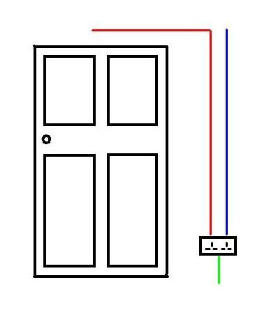

Hi,
Doing a bit of work in my lounge at the moment, and would like to replace a single double socket on a spur with 2 doubles and 1 single. I figure that the best way to do this is to remove the spur, and extend the ring.
In the attached drawing I have shown in red that the ring enters the room above the door (from the CU which is on the other side of the wall directly above the door), runs along the top of the door, then down the wall to a socket, then exits back up the wall (shown in blue).
The existing spur (in green) then runs down from the socket, under the floor to the spurred socket.
My questions are:
Can I leave the exisiting wiring above the socket although I know it is routed incorrectly? - not sure how I could route it any better without major upheaval!
Can the new returning section from the ring run to one side of the pictured socket, or will it have to be chased deeper to run behind behind the back box?
Am I ok to join the return from the extended ring to the cable shown in blue using a crimped connection, then bury in plaster?
What colour crimp connection is used for 2.5mm T + E - is it the blue sort?
Thanks in advance for any help!
Dave.
How did you know the cable to the ring runs across above the door like that is the plaster off the wall?
How far down from the ceiling is the Red Horizontal run?

The plaster isn't off yet, but I have followed the route with a (admittedly fairly naff) cable detector, - I appreciate the situation may be different when I do remove the plaster.
EDIT: Thinking about it though, as there are plenty of wires hidden on the other side of the wall where the red cable runs horizontally, it may be within 150mm of the ceiling, and I've been getting a confused reading from the detector.
Approximately 300mm below the ceiling.
If you intend to remove the plaster the cable can be run across the wall as long as it's higher up as long as it doesn't run anymore than 150mm from the ceiling as this is in a safe zone.
Also if you are removing the plaster or just chasing out why don't you dispense with the blue cable altogther without a join;
Run one from what is at present the spurred socket to the new single then from that single to the where the blue cable terminates?
Is that do able??
Good plan, when I've removed some plaster I'll see if this is feasible - is it acceptable to run this cable horizontally below the ceiling, then turn 90 degress and run vertically downwards even though all the cable is hidden under plaster? Or would I need to place a blanked off outlet at the turn to show where it was?
Is that do able??
Would rather avoid that if possible, as the cable terminates in a junction box under a newly fitted wooden floor, which I'd like to avoid interfering with!
Ok instead of joining the blue run a new "red" cable straight to the existing spur then onto the new single then from the new single back to socket in your picture is that clear and do able?
That sounds like an excellent plan, though I've never terminated to a CU before, but I'm sure all will become obvious! FFS - I should have come and asked here before ordering a ratchet crimping tool this morning!
