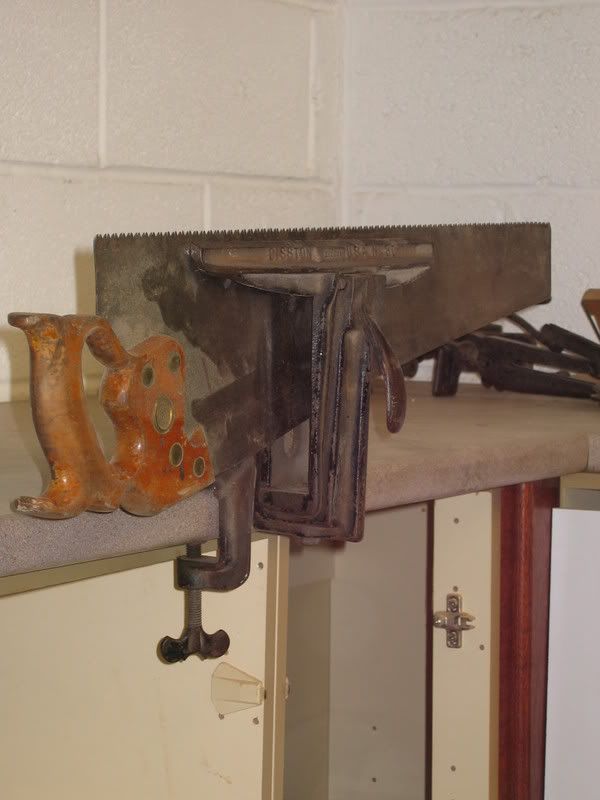

Even in the days of CV (chrome-vanadium, remember them) circular saw blades most joiners sent them out as they require a specialist grinder to sharpen. However, there is no way you can hand sharped a carbide-tipped circular saw. Period. There are four facet angles per tooth times however many teeth. Get the angles wrong and the blade cuts like sh*t. And last time I looked saw files didn't work on carbide tips......
anobium wrote:
You will be telling me next that you send your hand saws away to be sharpened, or even worse you buy those throwaway type from B@Q.
Don't we?
and for your benefit that is a pre-WWII Disston in a Disston saw vice. icon_lol.gif

My apologies lads, I stand corrected, for some reason I missed the tct reference, but honest I do resharpen my high speed blades and they cut perfectly. icon_redface.gif icon_redface.gif
Scrit when did you last use that saw, not recently I think, and the teeth, from what I can see look slightly uneven.
Interesting saw vice but not as good as a wooden home made one which keeps all the blade rigid. icon_wink.gif icon_wink.gif
That was taken just before I started to top and refile it. Every time I buy and old saw they're the same - badly out. As to rigidity - you just move the blade along a bit when you need to.
Incidentally how do you set your CV blades? I haven't seen a circular saw anvil setter for thirty odd yaers
