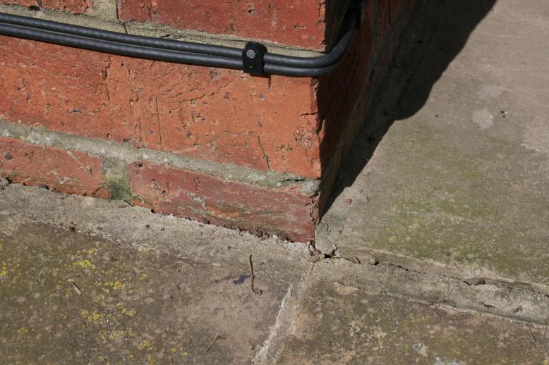

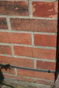

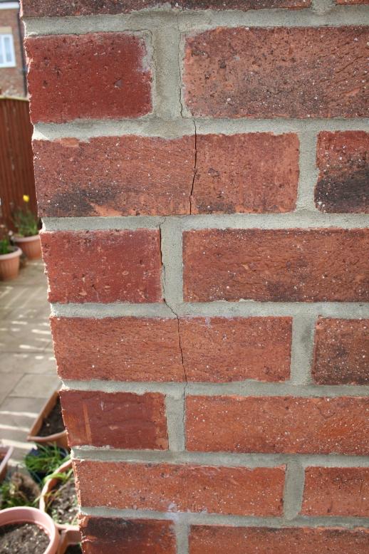

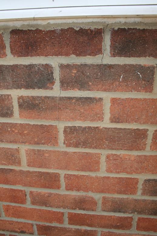

A homeowner looking to buy a detached house – only eight years old – spotted vertical cracks on the external brickwork near a corner. The south-facing wall had two cracks, each around three feet long, one low down and another about four feet up. The east-facing wall had a crack near the same corner and another running below a window. The patio slab at the base of the corner had dropped slightly. An extension joined the east wall about six and a half feet from the cracked corner. The rest of the brickwork looked fine. The homeowner wanted to know whether this was serious enough to justify a structural survey before making an offer.

This is a common one in UK houses, and the pattern here is textbook. Vertical cracks close to a corner, running through the bricks rather than following the mortar joints, point strongly towards thermal and moisture movement in the outer leaf. When brickwork heats up during the day it expands, and when it cools at night it contracts. Over months and years that cycle builds up stress, and the weakest points give way first – corners and the areas below window openings.
There’s another factor that catches people out on newer builds. Fired clay bricks come out of the kiln bone dry. Once they’re laid, they gradually absorb moisture from the air and undergo a small but permanent expansion. It’s irreversible – nothing to do with the daily heating and cooling. On a relatively long wall panel with no movement joint, that expansion has nowhere to go, and the corner acts as an anchor point. Something has to give, and usually it’s the bricks nearest the quoin that crack.
On top of that, if the mortar mix was too strong for the bricks – and that grey colour in the joints is a giveaway for a cement-heavy mix – the mortar won’t flex with the brickwork. Soft clay bricks paired with a hard mortar is a recipe for exactly this kind of cracking. The mortar wins the tug of war and the bricks lose.
The good news is that in most cases like this, the movement has already happened. It’s a one-off event in the early life of the wall, not something that gets progressively worse.

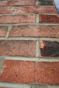

  • Check whether the cracks pass through bricks or just follow the mortar joints. Cracks through the brick faces suggest movement in the panel rather than settlement. Settlement cracks tend to follow a stepped pattern along the bed and perp joints.
  • Look at the crack width. If you can slide a pound coin into it, that’s worth investigating further. Hairline to a couple of millimetres on a newer property in this pattern is generally cosmetic.
  • See whether the cracks extend below the damp proof course. If they stop above the DPC, it’s very unlikely to be foundation movement. If they carry on down into the substructure, that changes the picture entirely.
  • Check the dropped patio slab separately. Patios settle on their own – the sub-base compacts or gets washed out. A dropped slab next to a cracked wall looks alarming but the two aren’t necessarily connected.
