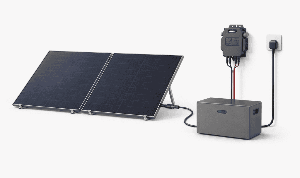

A typical plug-in solar kit: two solar panels, a microinverter, a battery unit, and a cable plugged into a standard wall socket
A battery-equipped plug-in solar kit showing the complete setup – panels, microinverter, battery and mains plug

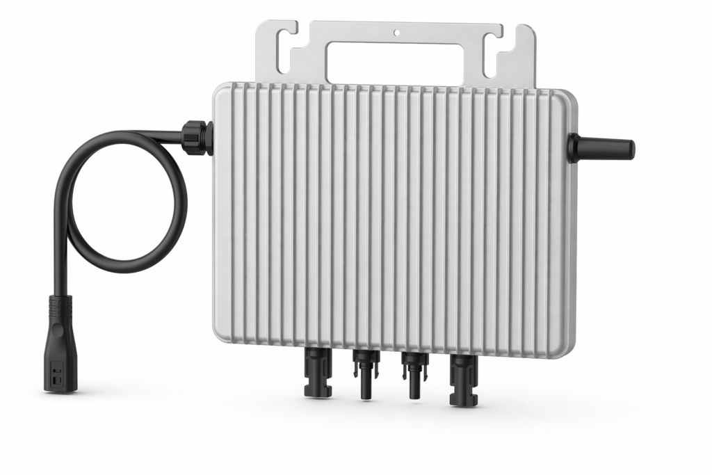

A plug-in solar microinverter showing MC4 panel inputs on the bottom and the AC output cable on the left
The microinverter is the key component — it converts DC from the panels into 230V AC and includes built-in safety shutdown. The MC4 connectors on the bottom connect to the panels; the cable on the left carries AC to the mains plug.

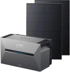

What about battery kits?
The idea of a battery is appealing, especially if your house is empty during the day. The panels would charge the battery while no one’s home, then the battery would discharge into your circuit in the evening when you’re actually using electricity, so you’d use far more of what you generate. That’s the model that’s taken off in Germany.
Here’s the catch, and it’s caught a lot of early UK buyers out: battery kits do not qualify for the new plug-in route. The law that legalises plug-in solar from 27 August 2026 covers solar-only devices, panels, a microinverter and a plug. It specifically excludes anything designed to import electricity, store it and supply it later. A compliant solar-only kit’s instructions even have to carry a warning against pairing it with a battery storage system.
That doesn’t make home batteries illegal. It means a battery system can’t use the plug-and-play socket route: it still needs a conventional installation by a qualified electrician, wired in on a dedicated circuit, exactly as a home battery always has. So the battery-integrated kits you’ll see on Amazon and elsewhere, EcoFlow’s STREAM battery range, Anker’s SOLIX Solarbank and similar, are not something you can legally plug into a wall socket and forget about. Buy one expecting the DIY shortcut and you’ve bought the wrong thing.
Why the split? The government took plug-in solar through a safety study, a consultation and a product specification before legalising it, and chose to handle solar first and storage separately. Batteries raise their own safety questions, so they’re expected to follow the same path: a study, then their own amendment and specification.
When might that happen? No official date has been set. Industry commentators expect a legal route for plug-in battery systems to emerge in 2027, the thinking being that the government can run the battery safety work in parallel now that solar has cleared the way. Treat that as an informed guess rather than a firm timetable. Separately, some in the trade expect Ofgem to open a simplified export-payment route for plug-in solar during 2027 as well. Neither is confirmed, and both could slip.
The practical takeaway: if you want storage now, budget for a proper electrician-installed home battery and don’t expect the socket shortcut. If the whole appeal of plug-in solar for you is that you can do it yourself, stick to a solar-only certified kit for the time being and keep an eye on the 2027 rulemaking.
Anker SOLIX Solarbank 3 E2700 Pro battery-equipped plug-in solar kit with two 445W solar panels
A typical battery-equipped plug-in solar kit — two panels and an integrated inverter/battery unit. Anker SOLIX Solarbank 3 E2700 Pro shown. Image credit: Anker SOLIX
