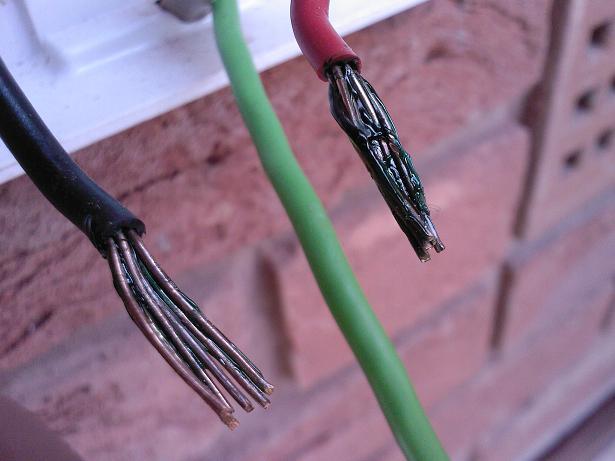

Photo by Click-Sure:
The pic was taken on the side of the unfused spur that was in a conservatory (the other side was not as green) and had been installed for around 12 years (DIY old cable re-use job) so had been subjected to a lot of heat during the summer hence the volume of ‘fairy liquid’ that had acumulated in a relatively short time.
http://www.diynot.com/forums/viewtopic.php?t=128061
