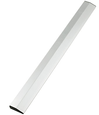

Darby
A Darby is used for smoothing undercoat plaster. For example when patching plaster, the edges of the existing plaster can be used as a guide to work from.
Usually 1200mm in length.
Straight or Feather Edge
A straight edge can be used similar to a Darby for smoothing undercoat plaster/render, but can also be used for helping to align plasterboards in dry-lining or Dot & Dab. Straight Edges can be 1200mm or even 1800mm in length.
