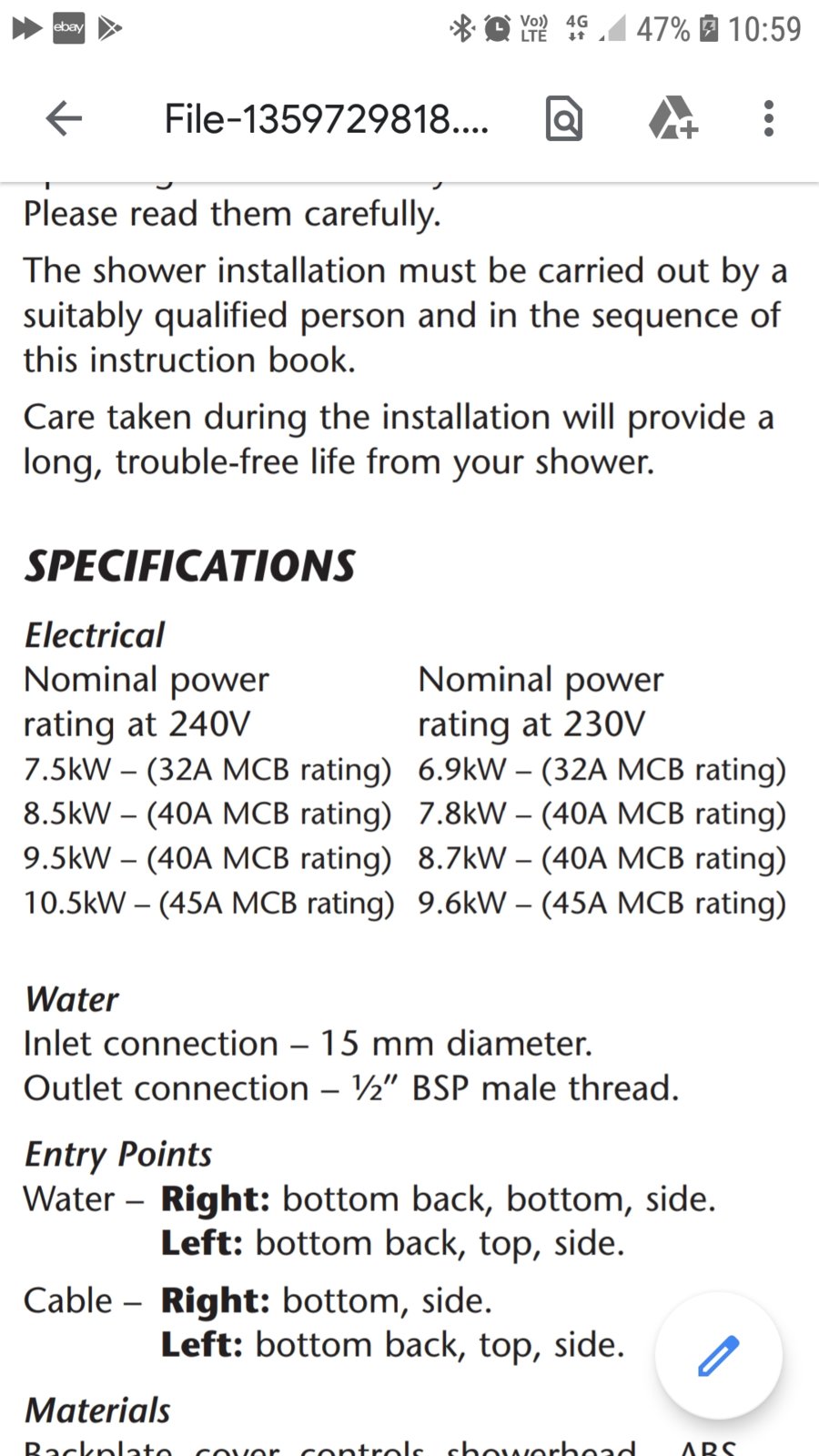

as per title.. is this safe?
its on a 10mm² cable laid across loft on top of insulation, approx 8m run (1m from shower to 45a isolator switch, then 7m from switch to c.u). I know it should be on a 45a mcb, but it's not. never had a problem with it tripping etc.
shall I replace to 40a mcb with a 50a (they don't make a 45a for my unit)? if I put a 50a mcb in do I need to change the 45a isolator switch to 50a too?

Technically it is not right. 43.8A @ 240V but 42A @ 230V so just over.
Not unsafe as such but might weaken the MCB after a time.

many thanks for your reply. I'll get the 50a, it's only a couple of quid. I must've done my calcs wrong, at 230v I made it 45a?
What voltage is quoted for the 10.5 kW rating, it will be either 230 volts (A) or 240 volts. (B)
(A) 10.5 kW at 230 volts is 45.65 Amps Element resistance 5.03 Ohms
(B) 10.5 kW at 240 volts is 43.75 Amps Element resistance 5.49 Ohms
The maximum supply voltage of 253 volts ( 230 +10% ) must be taken into account when calculating the trip time of an MCB .
(A) For the 5.03 Ohm element the current when the supply is 253 volts will be 50.29 Amps A 40 Amp MCB would trip after approx 10 mins
(B) For the 5.49 Ohm element the current when the supply is 253 volts will be 46.08 Amps A 40 Amp MCB would trip after approx 1 hour
From the manufacturer manual...
Putting in a 50a mcb still best way forward then?
Yes putting in a 50 Amp MCB is sensible, ( 10mm cable is just acceptable in terms of voltage drop but safe ) )
the 50 Amp MCB would not trip even when the supply was 253 volts.
thanks, will do that for now then.
