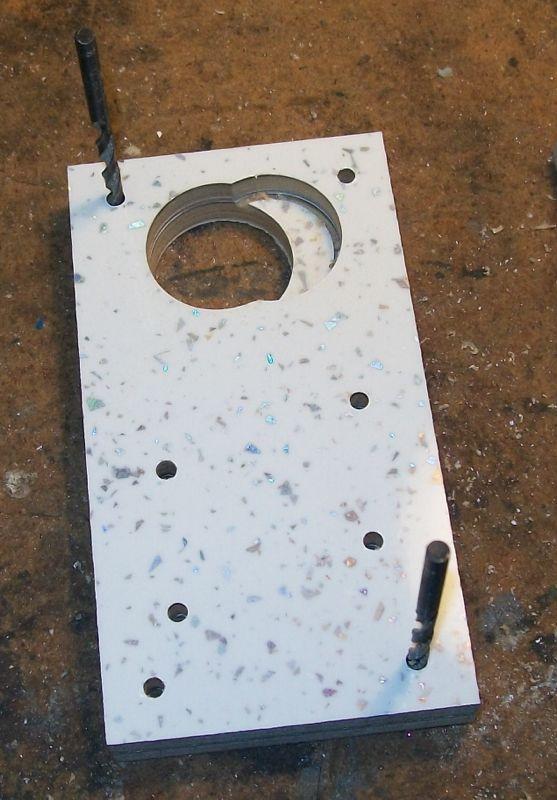

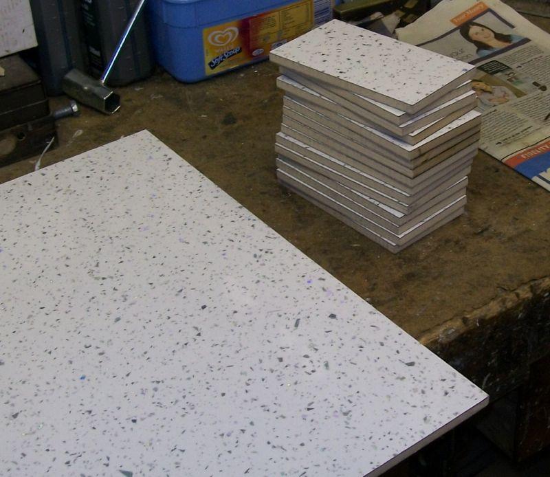

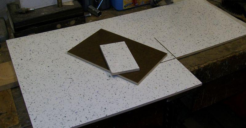

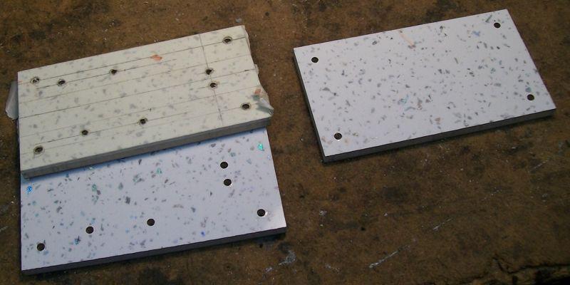

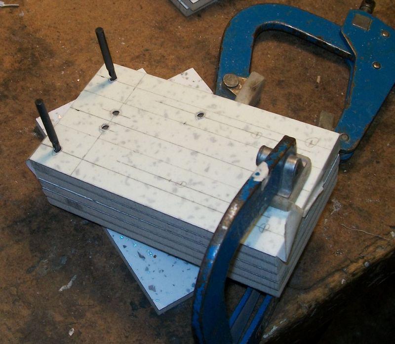

Having decided on the size you need, which in my case was largely determined by the size of the offcut I was using, you need to cut some blanks.

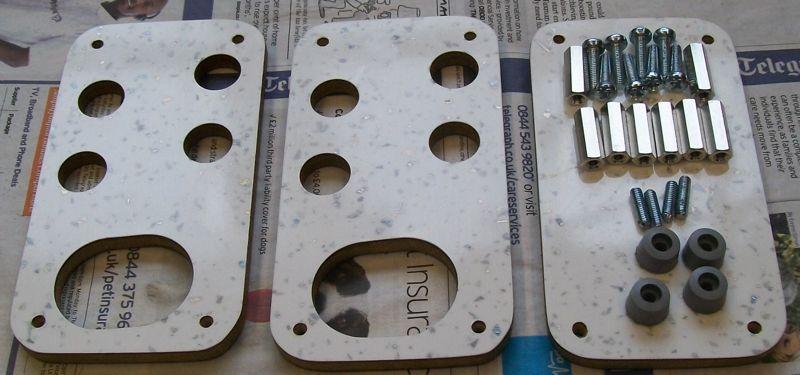

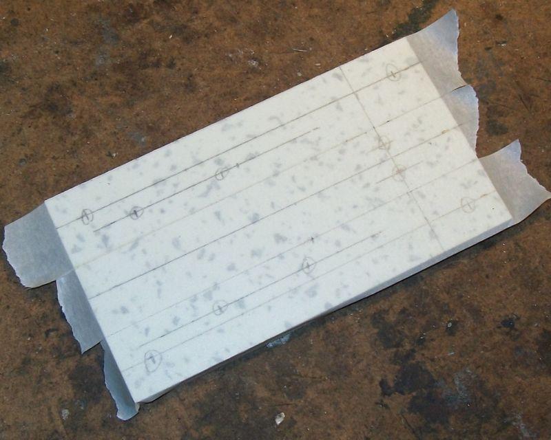

Then mark out what holes you'll need

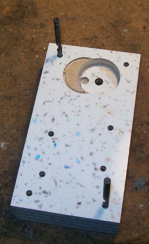

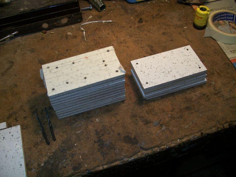

and start drilling

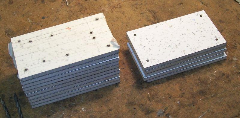

Note how I've clamped several pieces together, and uses spare drills to keep everything lined up.
Important Don't forget that every 3rd piece has only the 4 corner holes drilled !

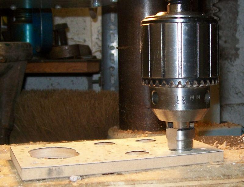

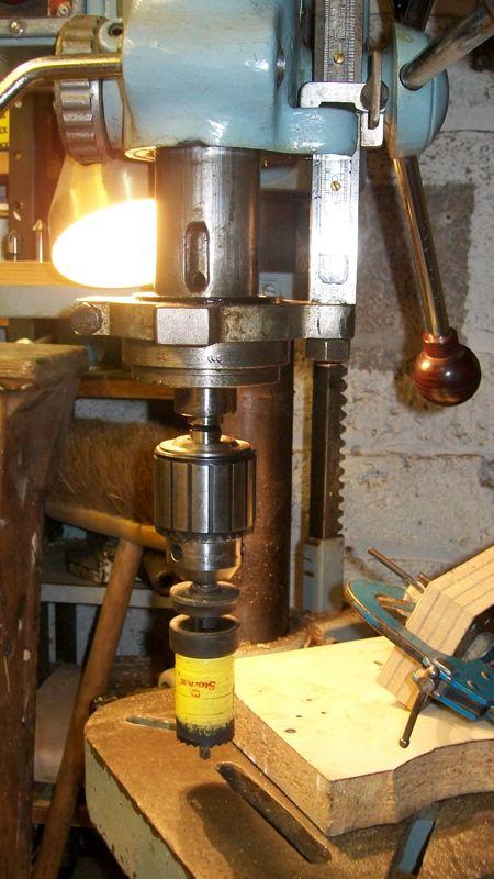

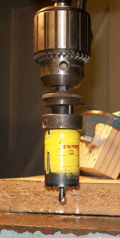

When cutting the large holes, I set the depth stop appropriately, and then started cutting. Note that when you cut the first hole, it removes the pilot hole for the other. So I cut nearly through on one hole, then did the other - this way, the existing saw cut guides the saw without the need for the pilot drill while you complete the cut.

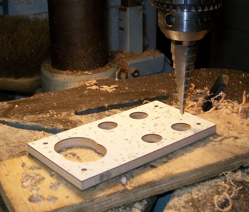

For the brush holes, I used a step drill to enlarge them. Again I set the depth stop appropriately, and cut from both sides as the thickness fo the board is more than the length of each step.

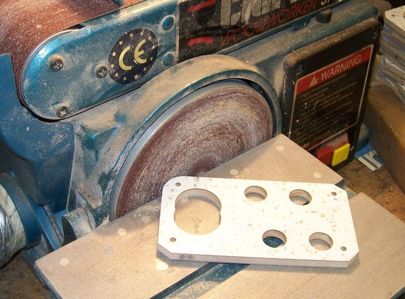

Use the saw to take the corners off, and then round them off (in this case with a bench sanding disk). Then I fitted sets of 3 together and sanded off the sides and corners so they all match.

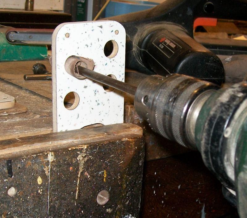

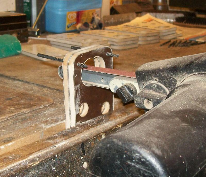

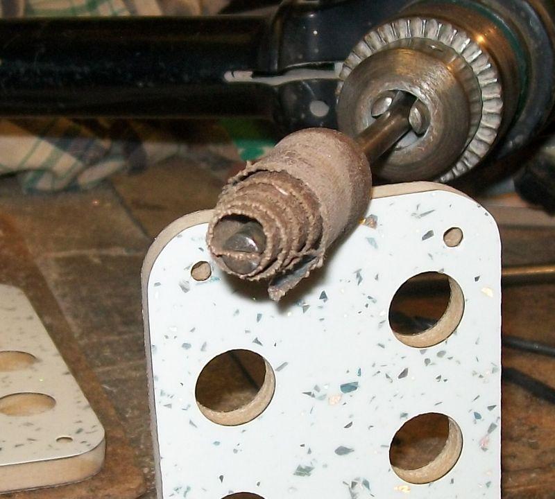

And I cleaned out the holes with a homemade tool - it's just a length of bar with a saw cut down the end. Thread a bit of abrasive tape into the slot and wrap it round the bar.
Finally, by hand go round all the edges and holes taking the sharp edge and any flash off. The hole saw in particular tends to leave quite a flash sticking up.

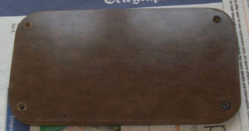

Now we've finished working the parts, the edges need sealing. I used 3 applications of Danish Oil, though I suppose varnish or similar would also do. I found that fitting a strip of cloth in the same tool I used for sanding out the holes earlier made application of the oil easy - even inside the holes.

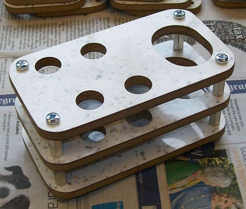

The complete assembly needs 8 spacers and some screws. For the middle, I cut the heads off some screws to make short bits of threaded bar.
As a tip, unless your marking out and working is far better than mine, then the parts won't be identical. So I marked the bottom piece to show which way round it goes - as an easy way to do it without it showing, I just used a marker pen round the holes at the "big hole end" of the unit.
And the finished item

Suggestion:
Try it with cap or dome head screws instead of pan - might be a better look?
It certainly looks better with stainless screws. Standard bright zinc goes "off coloured" when exposed to standard bathroom cleaners.
