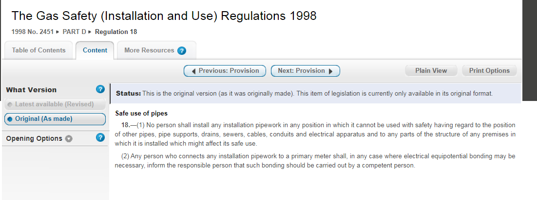

Note for information wiring regs not a legal document whereas GSIUR is.
bonding-png.150030
Electricians argue come what may the above is a requirement gasmen have to comply with. Start another thread if need be but above are the facts we have to comply with.
To be accurate, only the first paragraph is a gas regulation.
The rest is waffle and dependent on preferably.
More importantly it would appear to differ from the actual law -
as is usual with the plethora of guides which abound and confuse everyone.
Also I have answered in the other thread.

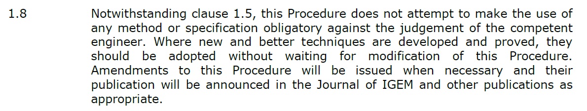

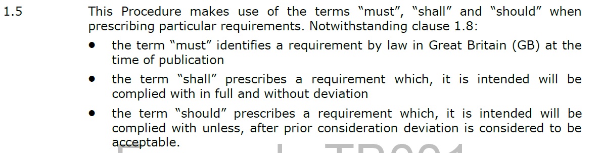

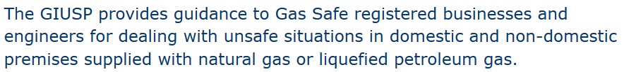

I see that is from the "Gas Industry Unsafe Situations Procedure" pdf (formerly TB001).
It's own webpage states it provides guidance. (taken over now by IGEM)
That document states near the beginning...
And, seeing as they reference clause 1.8...
Note for information wiring regs not a legal document whereas GSIUR is. .... Electricians argue come what may the above is a requirement gasmen have to comply with. Start another thread if need be but above are the facts we have to comply with.
Indeed - but think about what it actually says.
It is talking about equipotential bonding, and that is applied to extraneous conductive parts, not to any pipes come what may.
That guidance does not mean that bonding conductors have to be attached to the incoming pipework of all gas installations.
