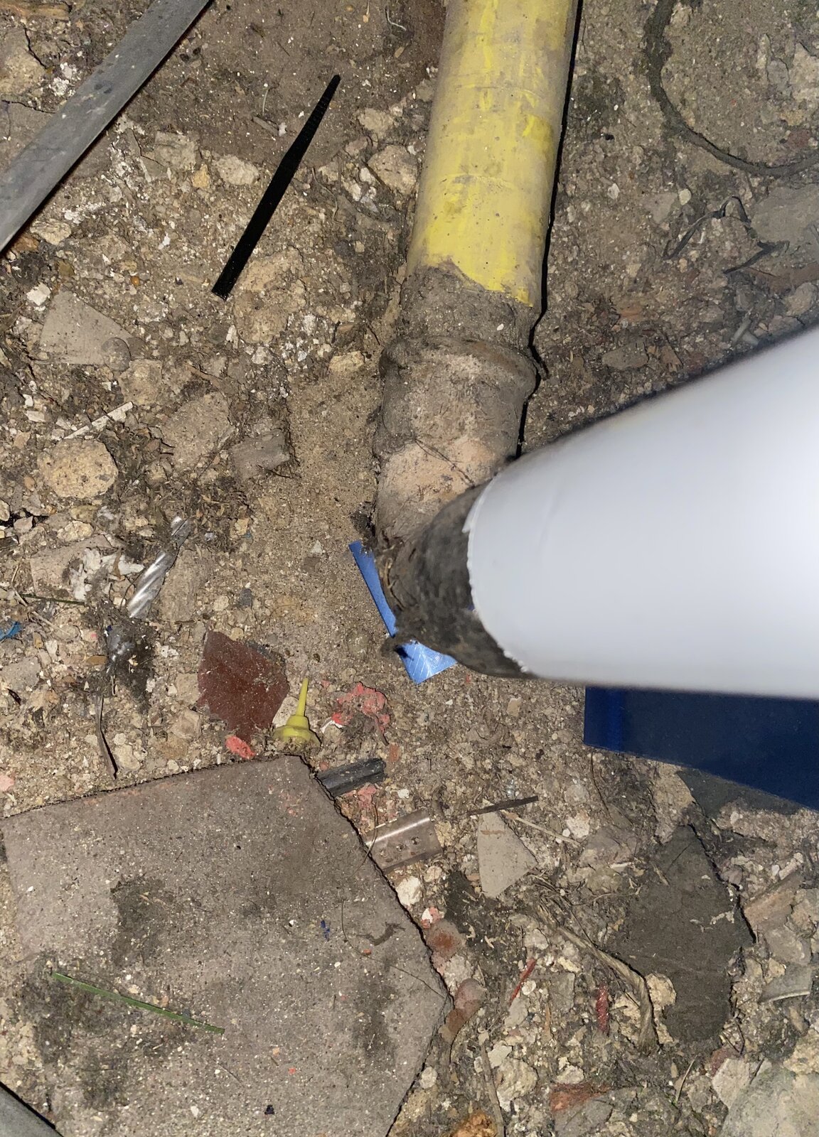

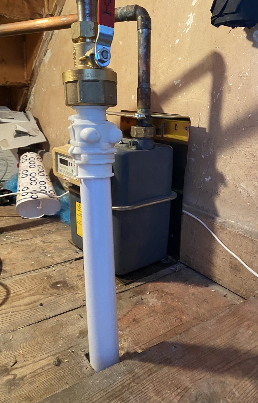

Thanks all for your replies.
Update - within 24 hours of calling, SGN have promptly sent the contractor back and they have wrapped the exposed pipe in a plastic sleeve and the valve in a silicone type purpose made cover.
The only bit now exposed is the old elbow at the bottom of the floor void below the new sleeving. I think tape there would suffice as it is unlikely to be disturbed or touched.
I believe the white sleeve is what they are supposed to fit in the first place.
I love the moulded cover.

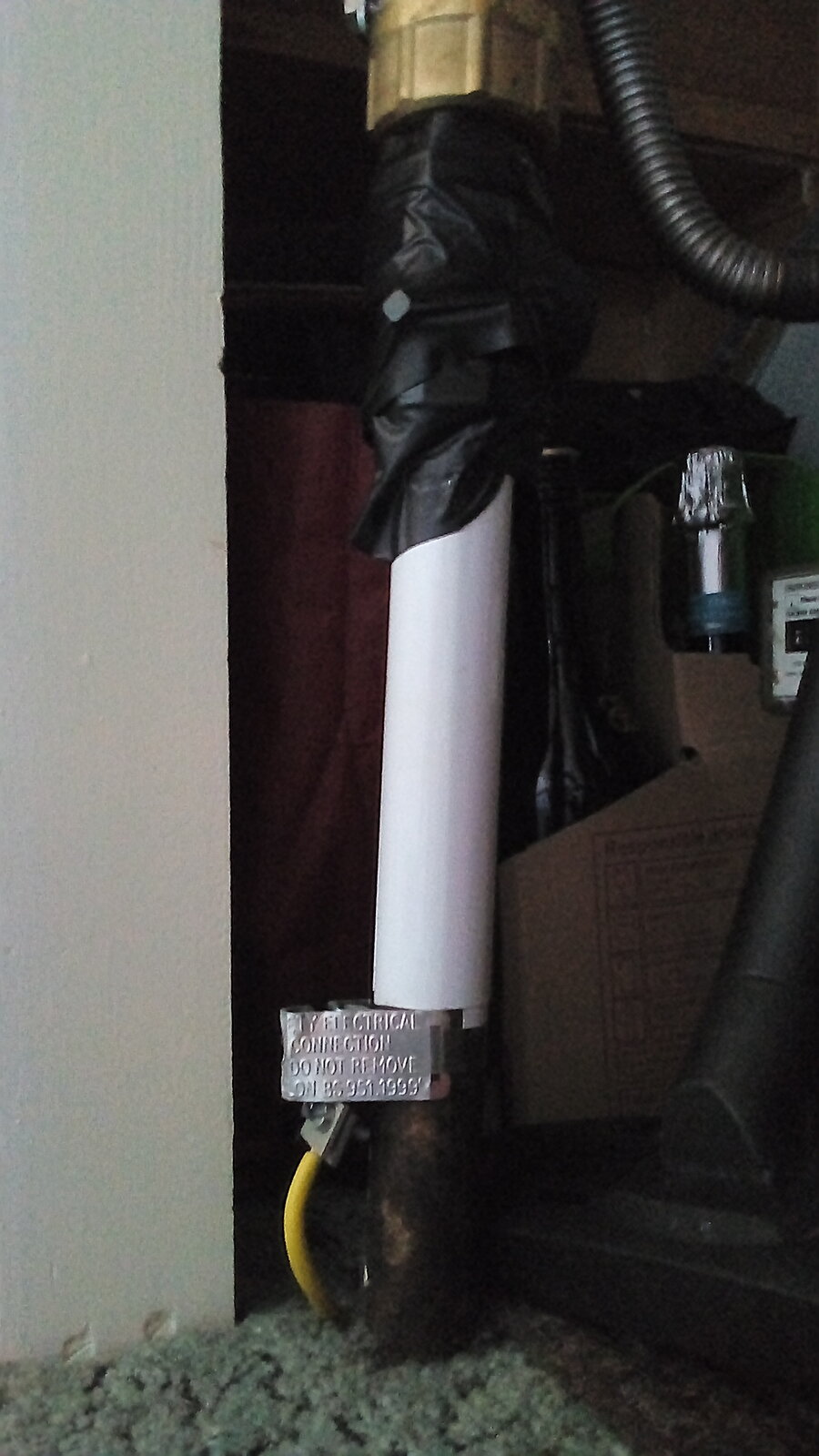

it's a shame the SGN guys aren't trained in the electrical bit too,else they wouldn't have done this:
Indeed. My first impression on seeing it was to wonder whether it was heat shrink.
Kind Regards, John
I understand that, 2nd looks it seems to be that it's 2 halves [which don't quite line up correctly] filled with something like glue or silicon and held in place by 3 cable ties.
Overall a much, much nicer solution than a rough ol' bit of black sticky tape.
