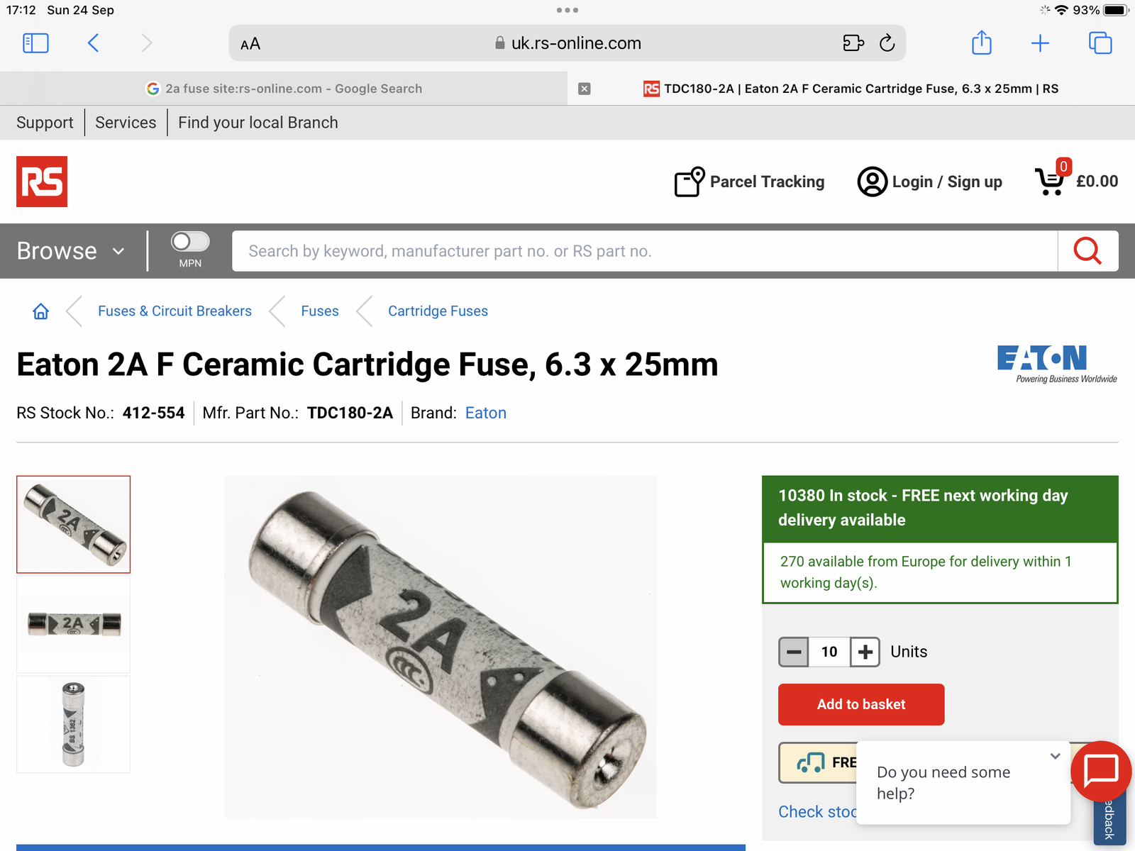

Fit a Fused 2a plug....they are available.
With a 2/3 amp fuse fitted
%A plugs with fuses are certainly availableee, but I'm not so suree about 2A ones - havee you found theem?
However, in both cases above, someee clever clogs willundoubtedly make the point that fuses can be changed for ones of higher ratings ;)
Kind Regards, John

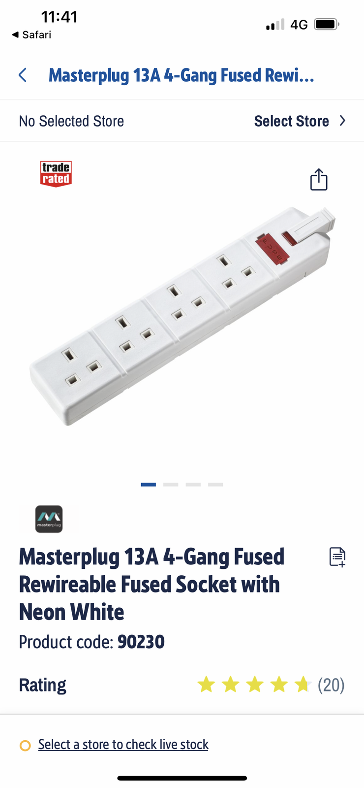

Mind you, in terms of the second suggestion (a fused 4-way trailing 'extension socket'), a 13A fise would obviously fit!

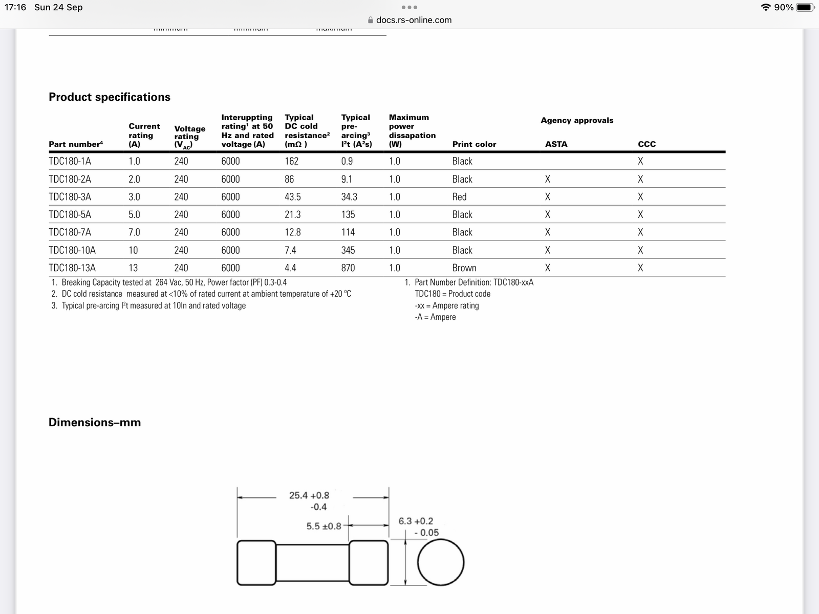

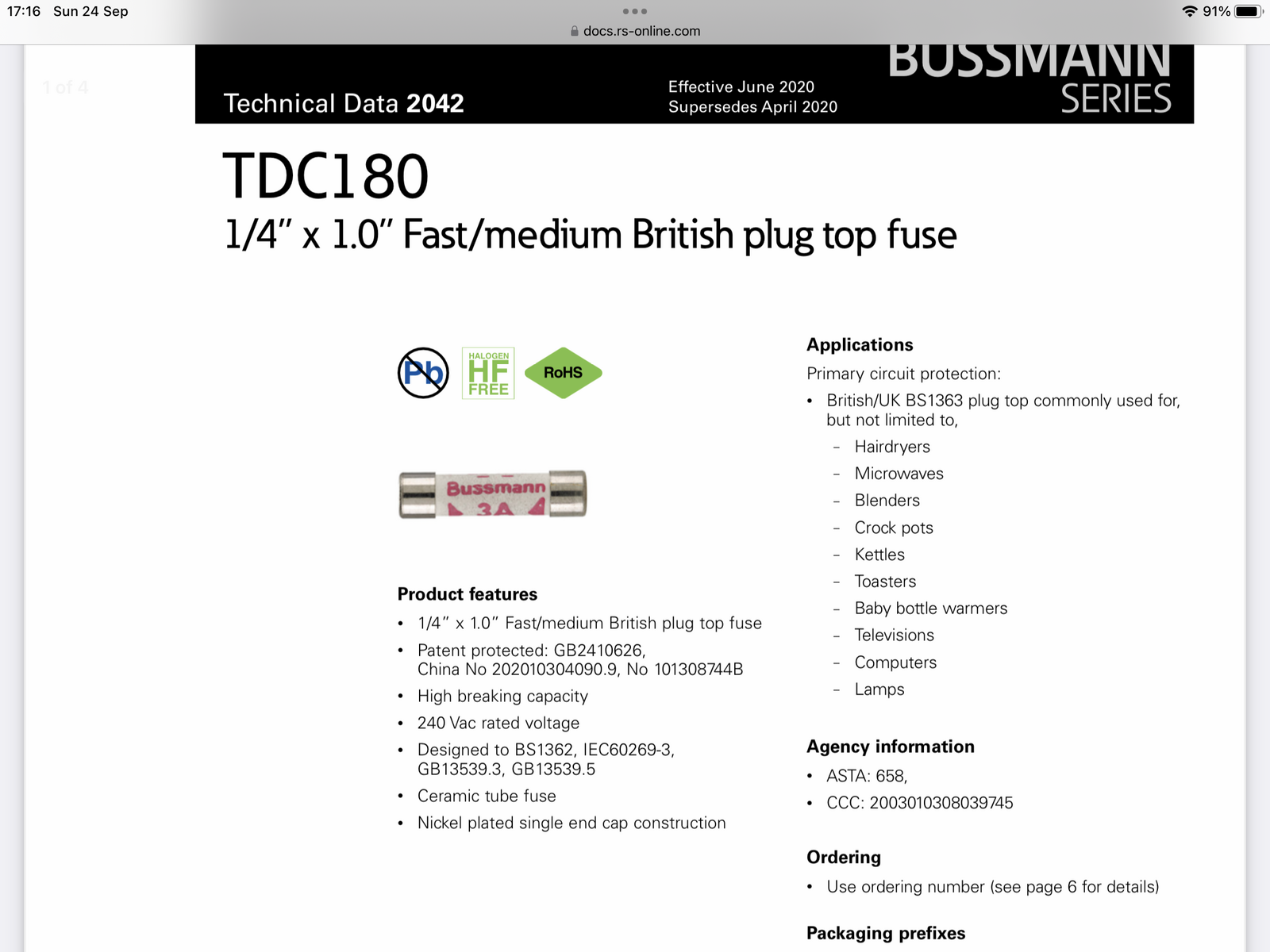

As below
