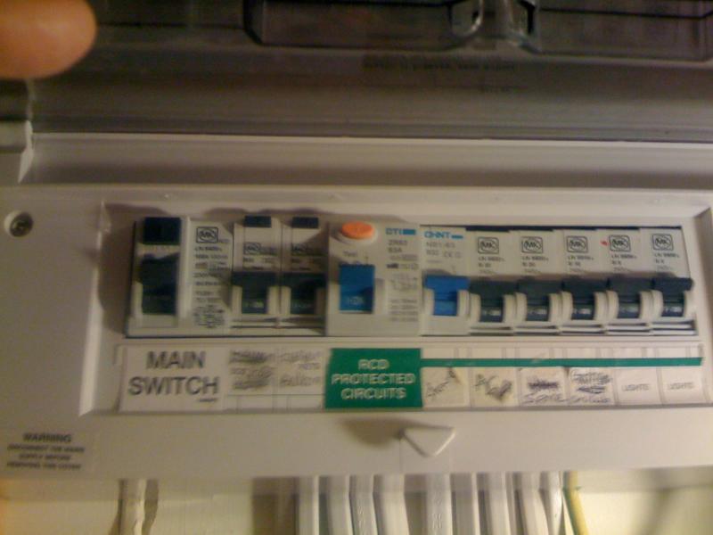

Right, well, I have looked in the fuse box, and we have two switches labelled "lights". The one on the right turns off all the downstairs lights, no problem. The one on the left switches off all the upstairs lights, plus the 2A and 5A lighting sockets downstairs.
So I guess that means the 2 amp sockets are running off a ?5 amp circuit. From what has been written above, it is OK to use plugs and sockets that are rated lower than the circuit, as long as you do do not overload them. So as long as we keep under, say, 150W per socket, we should be OK.
Please let me know if I have got that wrong, as you may have guessed I am a complete electrical dunce trying to figure this out for myself.
I have attached a photo of the fuse box for what it's worth.
Thanks for all your help so far.
Mark

Can you tell us what is printed on the main switch?
I'm thinking it looks similar to what may be put on a TT system, I don't like people using other brands in a consumer unit as it means it is not fully type tested. Using Chint too, urghh! What does it say on the front of the Chint RCD?

Spark123 I will have a quick look at the CU tonight and let you know what it says.
