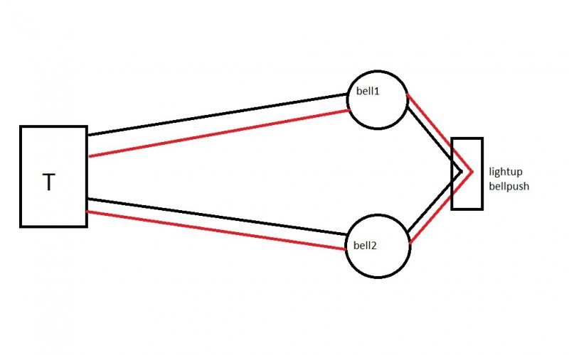

I bought a Friedland 8volt 2 amp transformer to run my 2 Byron 771 doorbells, but it dosent seem to have the power to operate both bells, I was given a Byron 778 to put in place of one of the 771's but still the same. today I bought a Byron 1200 underdome which works great on its own but as soon as I connect either a 778 or 771 they just click.
I have wired them in series as I didnt want to run two sets of wire from the bellpush and transformer. I'm tempted to buy another byron 1200 but I'm concerned this wont work either. I used proper bell wire for this also but seem to be stuck with only 1 bell working, any ideas?

As you have wired them in series they have only got half of the output voltage from the transformer across them, they need to be wired in parallel although the transformer may not be able to power two sounders.

thanks again! this worked ok,
the only thing the lightup bellpush does'nt light (the Mrs likes this bit) the bulb is ok any ideas?
I will draw a diagram and try to post up how my wiring is.
That doesn't show whether you have, or have not, connected both conductors from the transformer to the terminals in the switch.
If the bellpush doesn't light up but pressing it causes the bells to sound, then either the lamp is broken, or the lamp is not connected to the terminals properly.
thanks for the reply, I'm sorry I dont really understand what you mean there.
One side of the Transformer goes to the switch and then onto the bell the other side of the transformer goes to the other terminal on the bell the other bell is then wired terminal 1 to 1 and terminal 2 to 2 first to second bell.
I also tried this way but no light either
I have exactly the same setup with 2 bells and an illuminated push, and it works just fine. There's no reason why it shouldn't, if wired as per your first diagram.
Your attempt at the second setup may have put the push directly across the transformer's output, which certainly wouldn't do the switch contacts any good, and may somehow have damaged the lamp as well.
As you don't really seem to understand series and parallel circuits all that well, it might be best to revert to your original wiring that was known to work with one push and one bell, and see if the push lights up.

Just spent the last hour or so rewiring and testing, I can report all working perfectly now!
