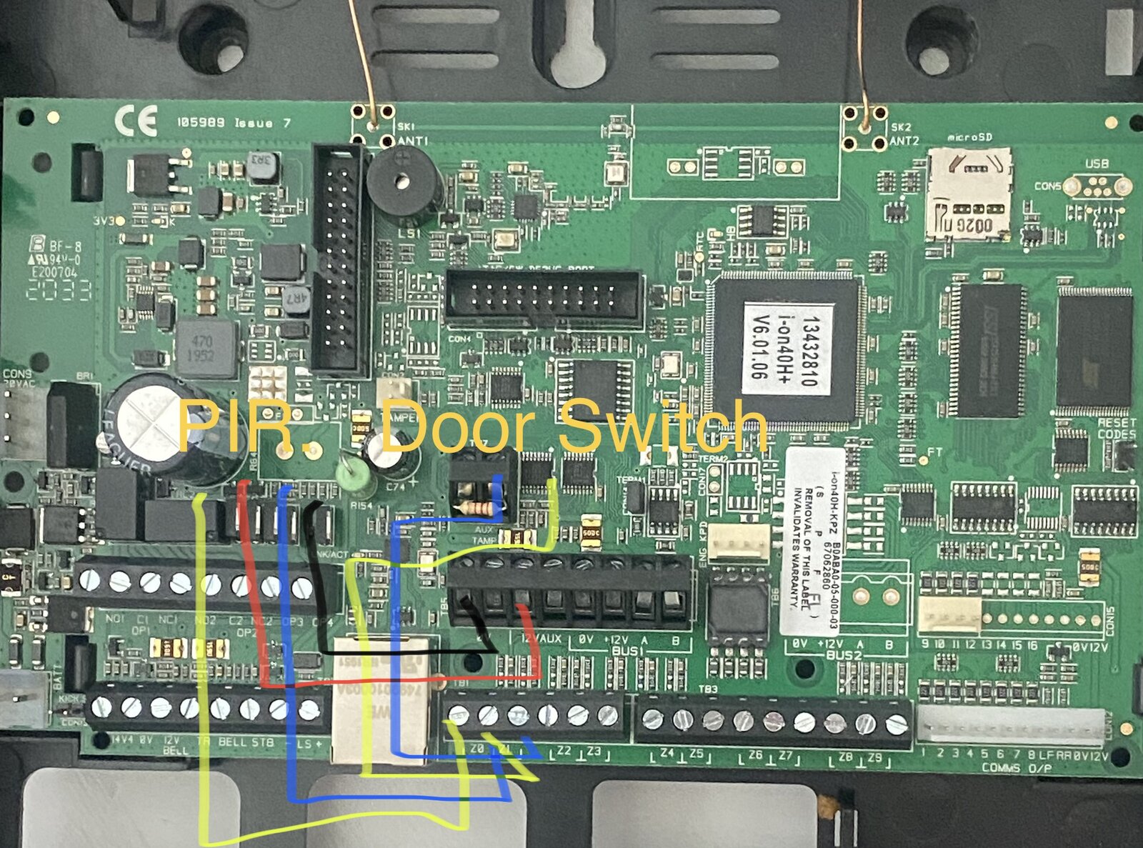

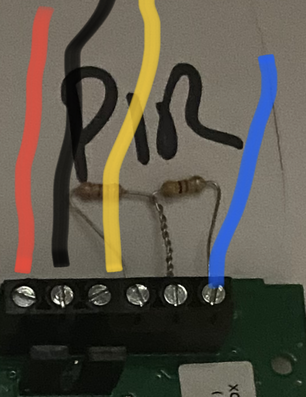

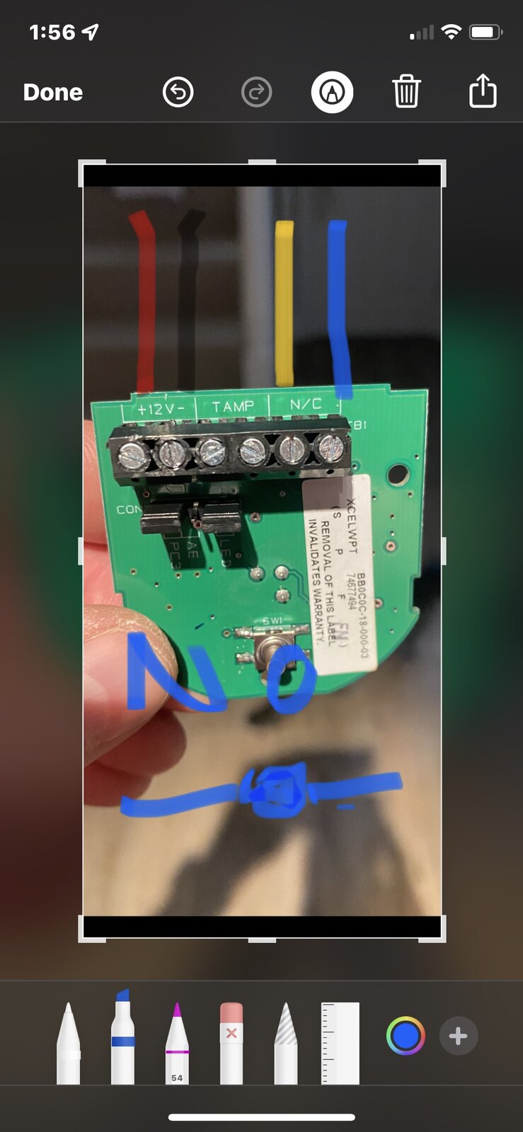

Any chance you could write thats essay as I have a 4 core cable to 2 sensors that are back to back to each other in 2 rooms and I can’t get the buggers to work
im on a Eaton Ion40H and the keypad doesn’t like it
for some reason I feel it’s the power source as when I connect that to the Aux it throws out the wifi and the 12v Aux
so something about it, it doesn’t like.
I have 2 banks of 12v OV and there chocka with wires
can you get 12V off a different spot?
pics attached

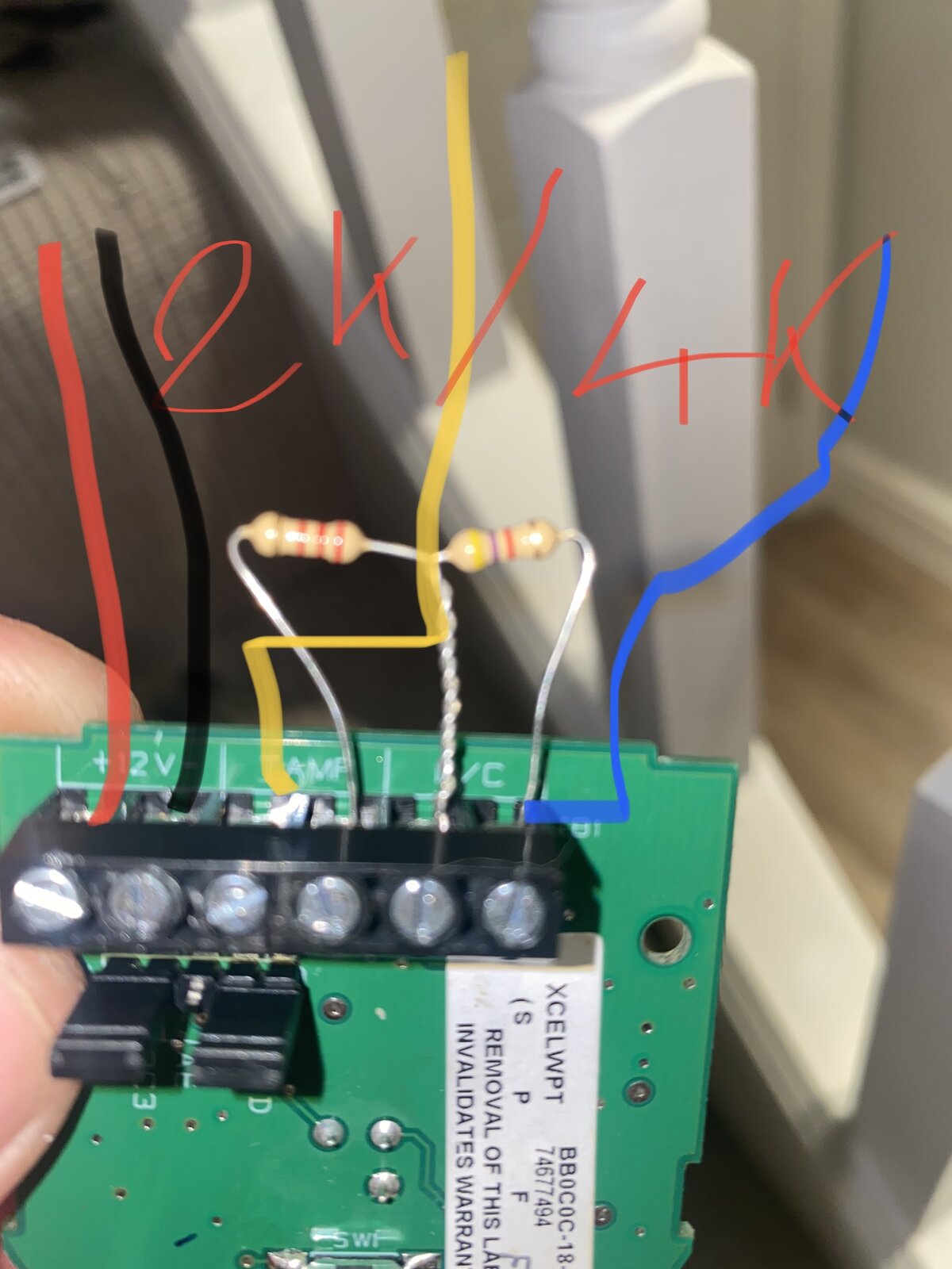

note last 2 pics are how they were wired originally with No tamper and yellow blue opposite way around at N/C using no resistors……..
the other pic of PIR is his the others are wired
thank you

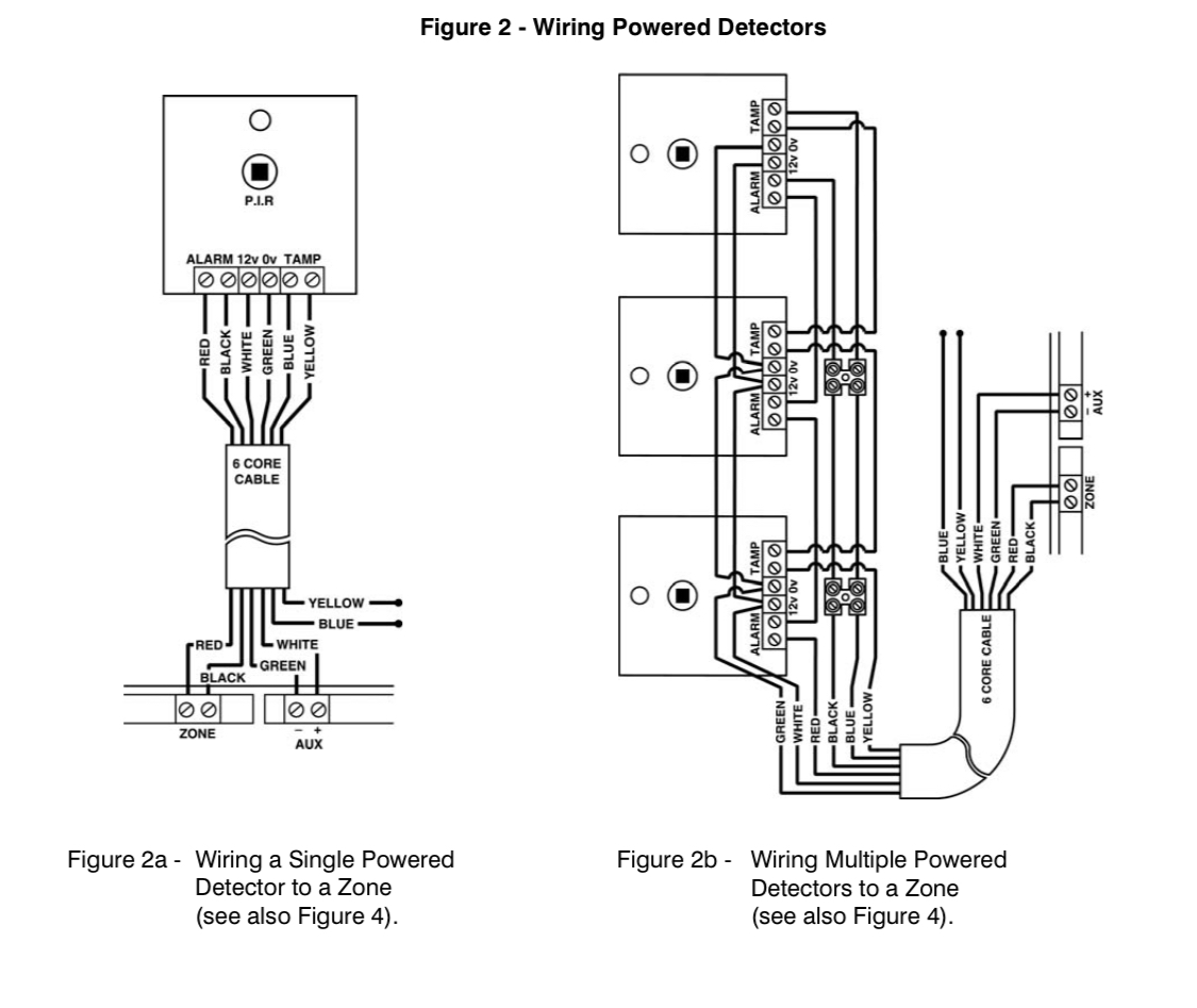

From the Texecom Excel instructions
Thanks you

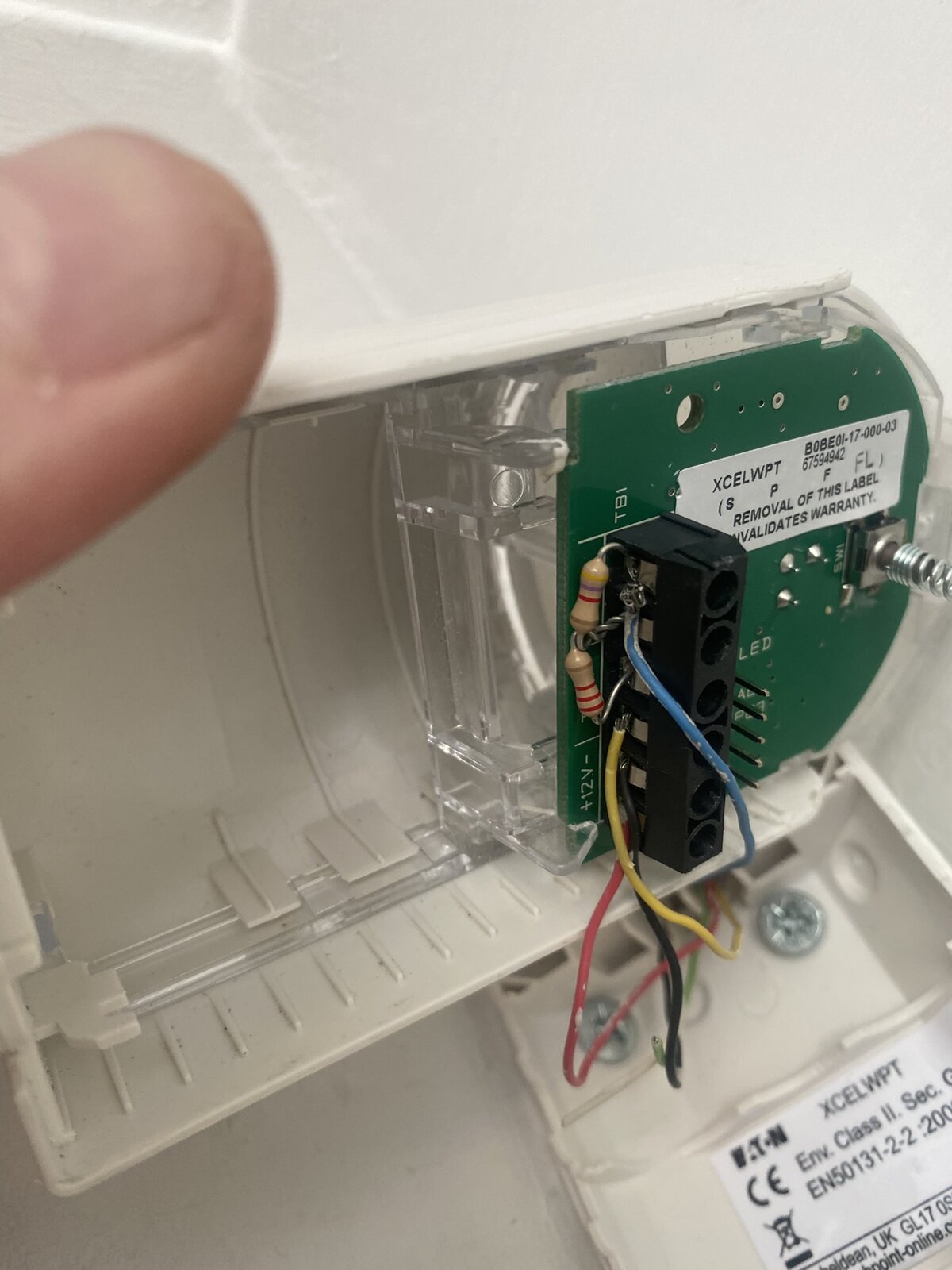

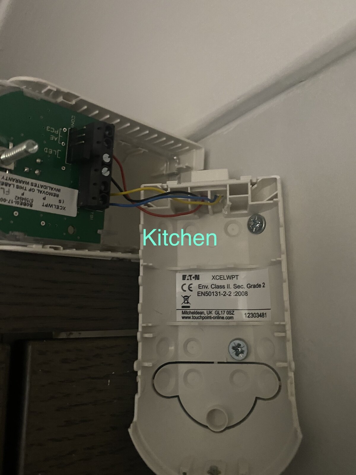

Trouble is I only have 4 wires for these two PIRs the rest are 6 wires but only using 4 as per the first photo with resistors.
that’s what’s confusing and I can’t get behind them and look as they are both been boxed into a bookcase and kitchen cupboards.
so no idea how they are wired up behind…

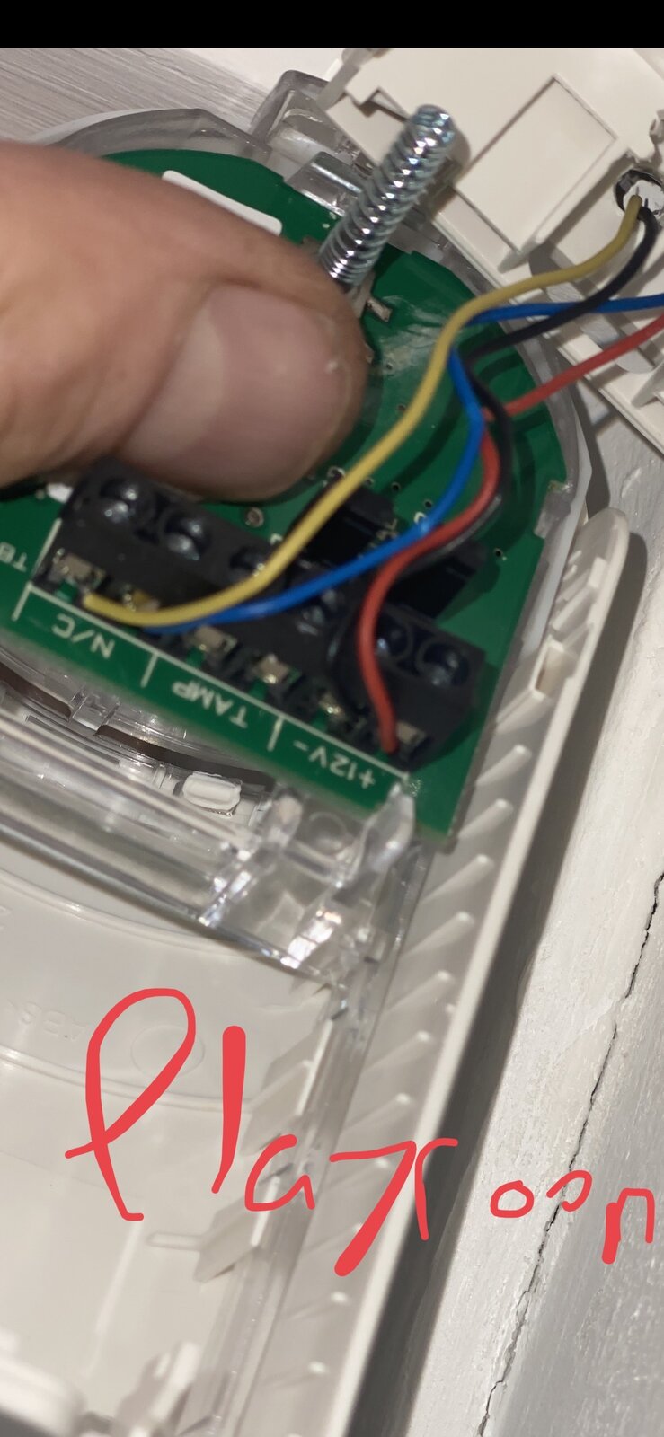

first phone is now the others are wired

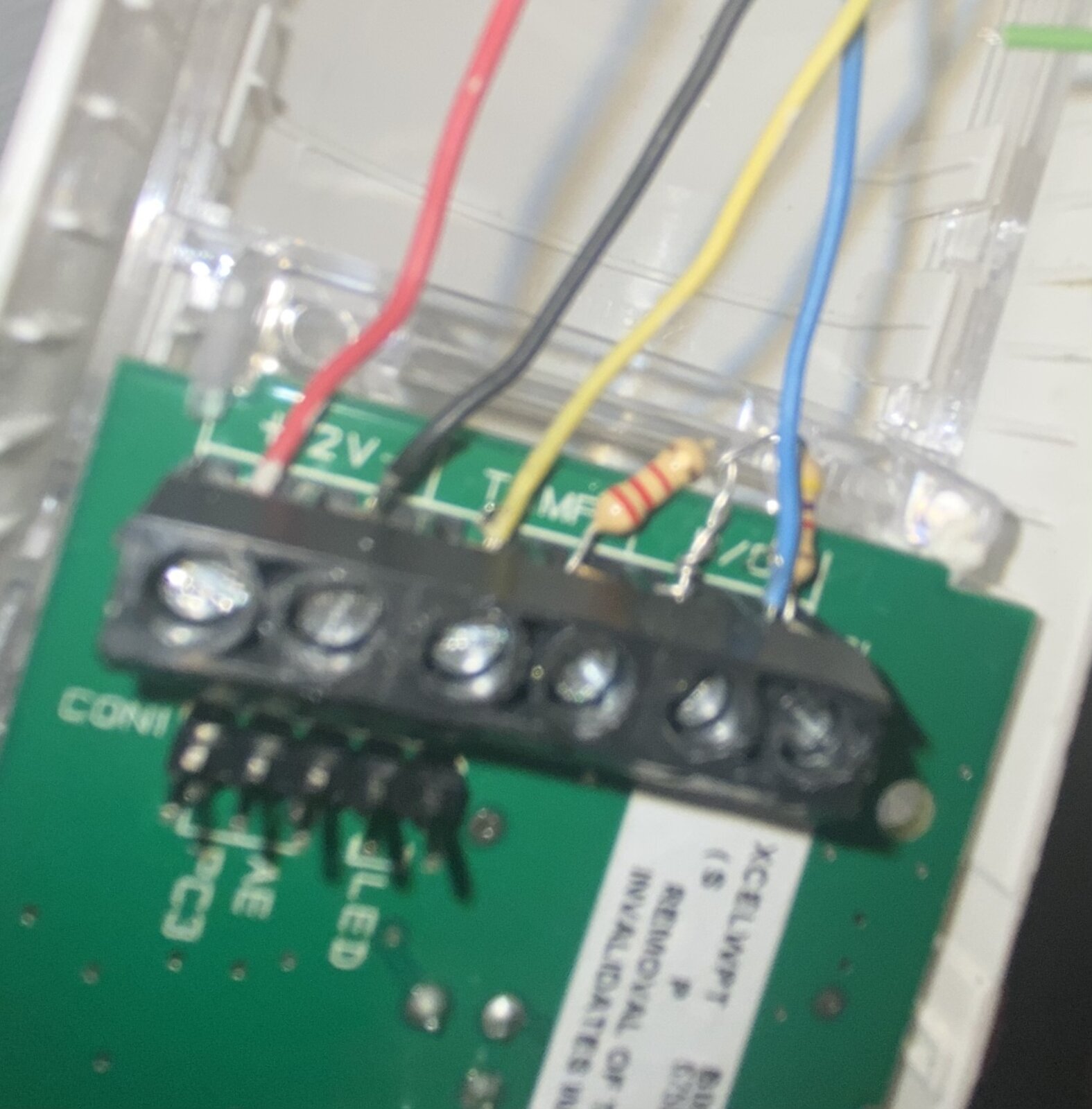

second and third photo is how they were wired before.
then at label same as others in 4th phone but tht then seems to throw out the Power as it reads 12v Aux fault at panel
very frustrating, can I take power from elsewhere?

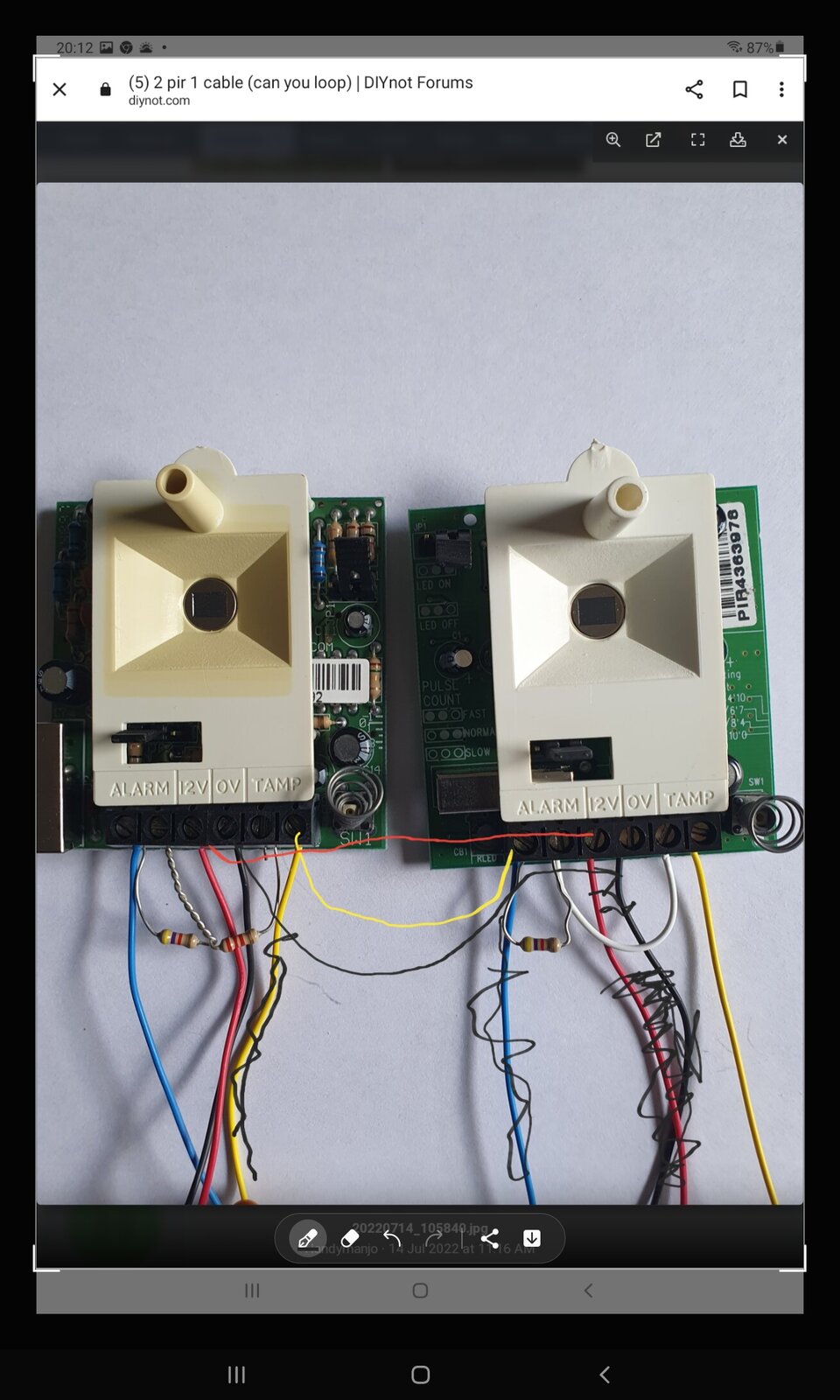

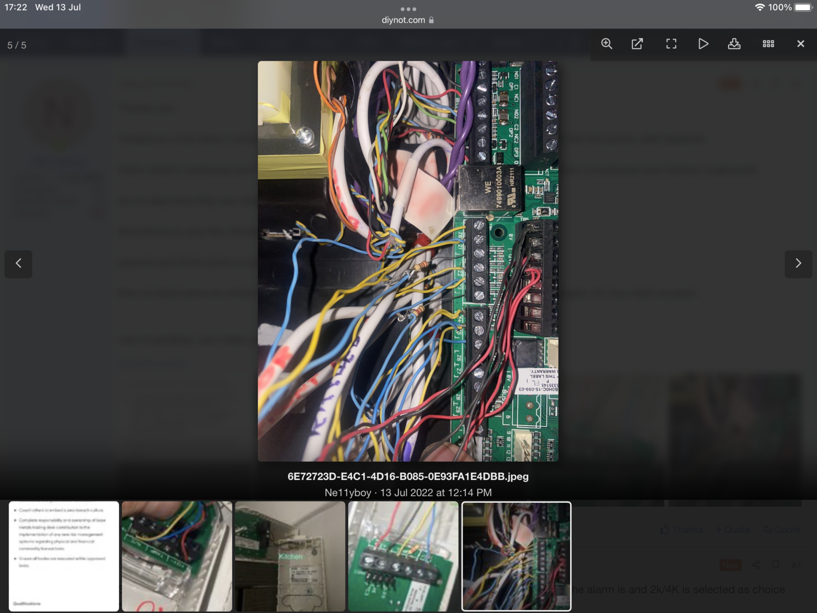

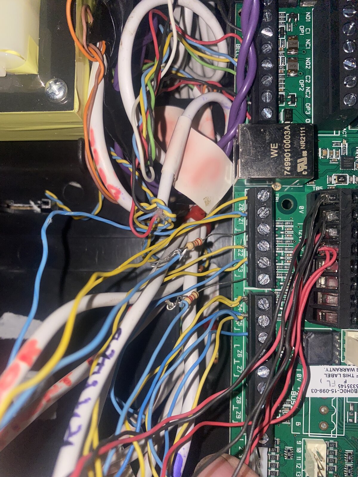

So if it’s wired like this? Does the Takper need to be bridged or with a resister? if the rest of the alarm is and 2k/4K is selected as choice sauce
Pic
False alarm and may not work ….lol

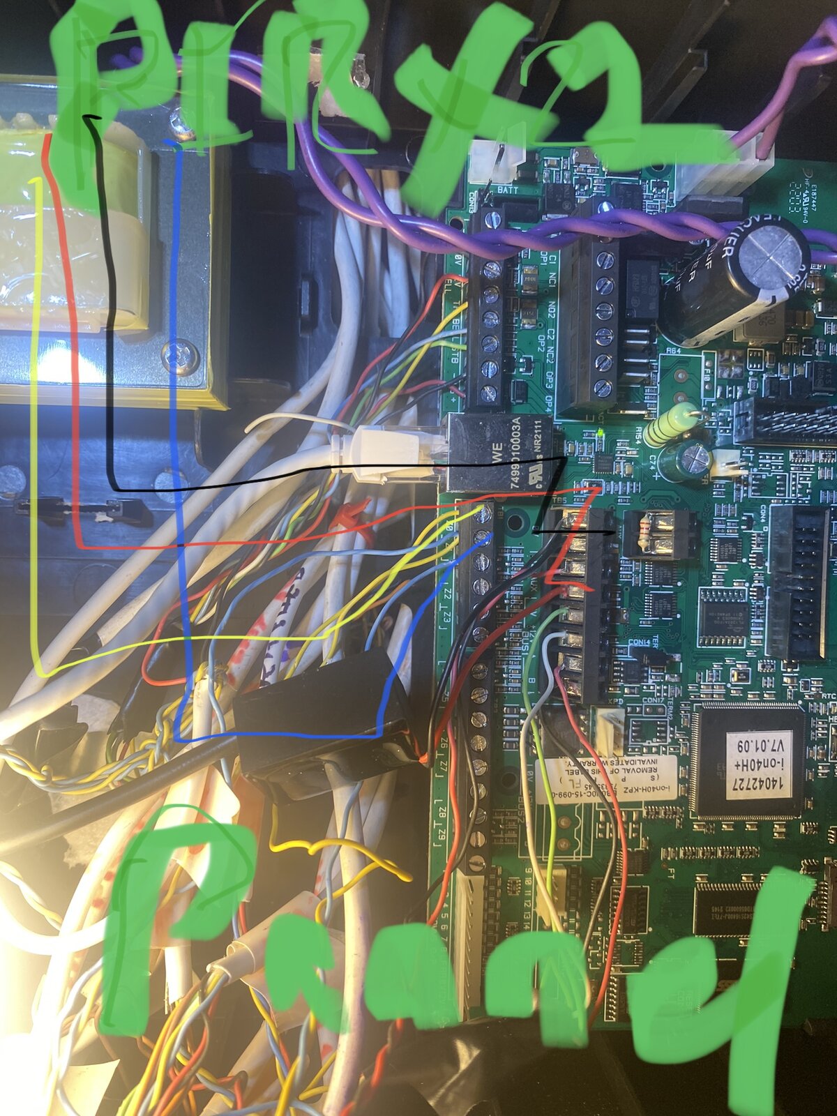

whos installed that mess with wires wrapped around resistors and looks to be multiple wires in zones 4 and 5

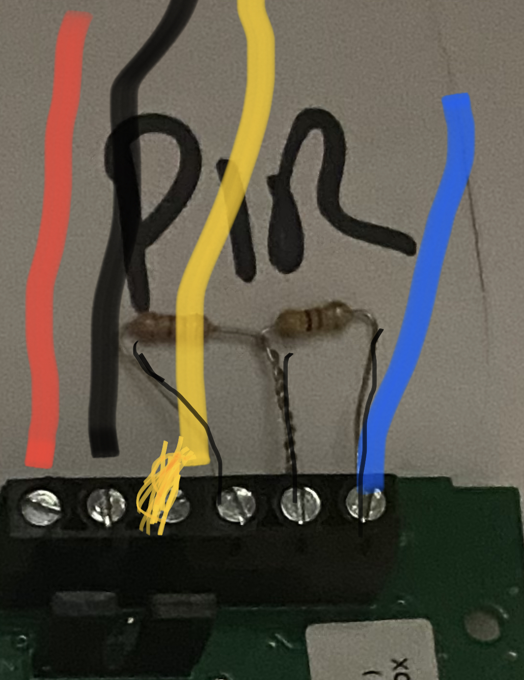

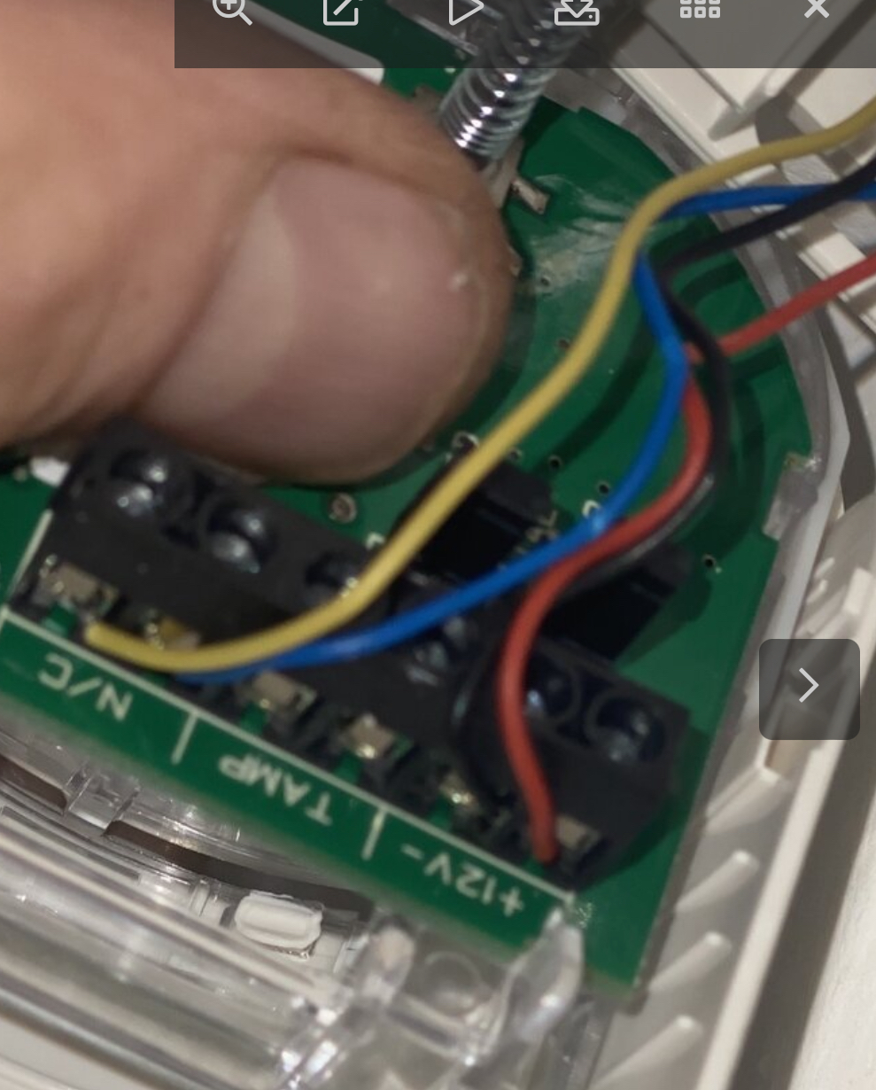

PIR 1 - I’ve wired as per the first photo
PIR 2 - I’ve wired as per the second photo
and at panel I have wired as this
with no resistors
and only option at keypad I have is a 2 wire with resisters
1-k/1k
2/4
4/7
so I’m gonna have to use resisters right?
like photo four but that didn’t work the first time but was coming through the tamper p
thoughts please gentlemen

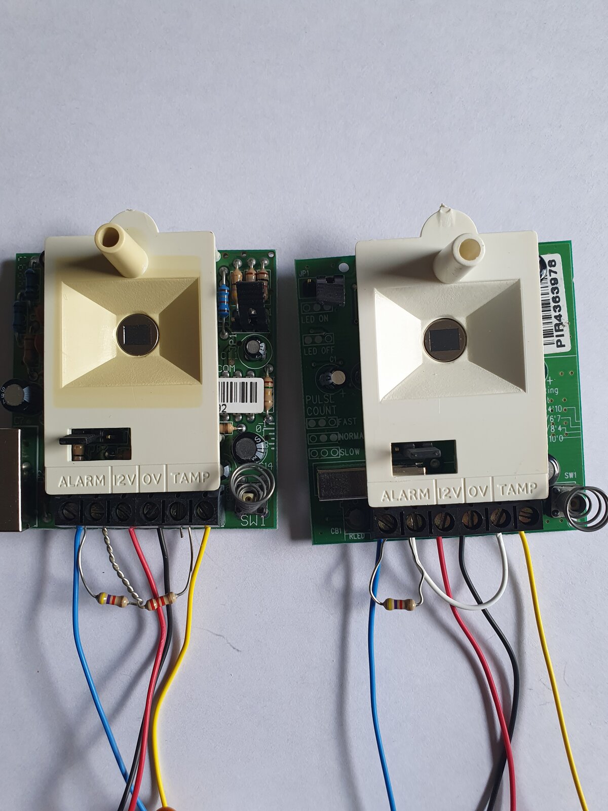

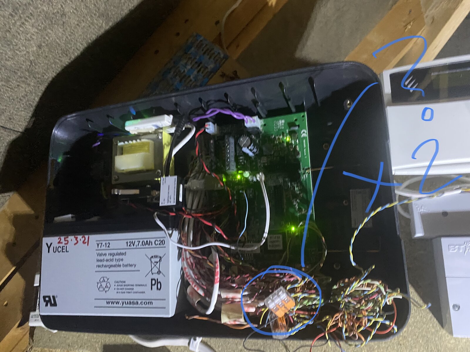

Do both detector cables go back to control panel?
Wire 1st pir as standard EOL
2nd pir put link from tamper terminal to alarm terminal, put 4.7k resistor across zone.
In control panel join both yellow wires together with connector block,then put blue wires in zone connection on pcb
As picture.
Hope this has made it clearer for you.

No they don’t they spured off the existing cables here’s the original wiring set up
PIR 1 first pic
PIR 2 Second pic
this is how I wired the other PIRs - third pic

Wire as this rough diagram if both pir's are back to back.
