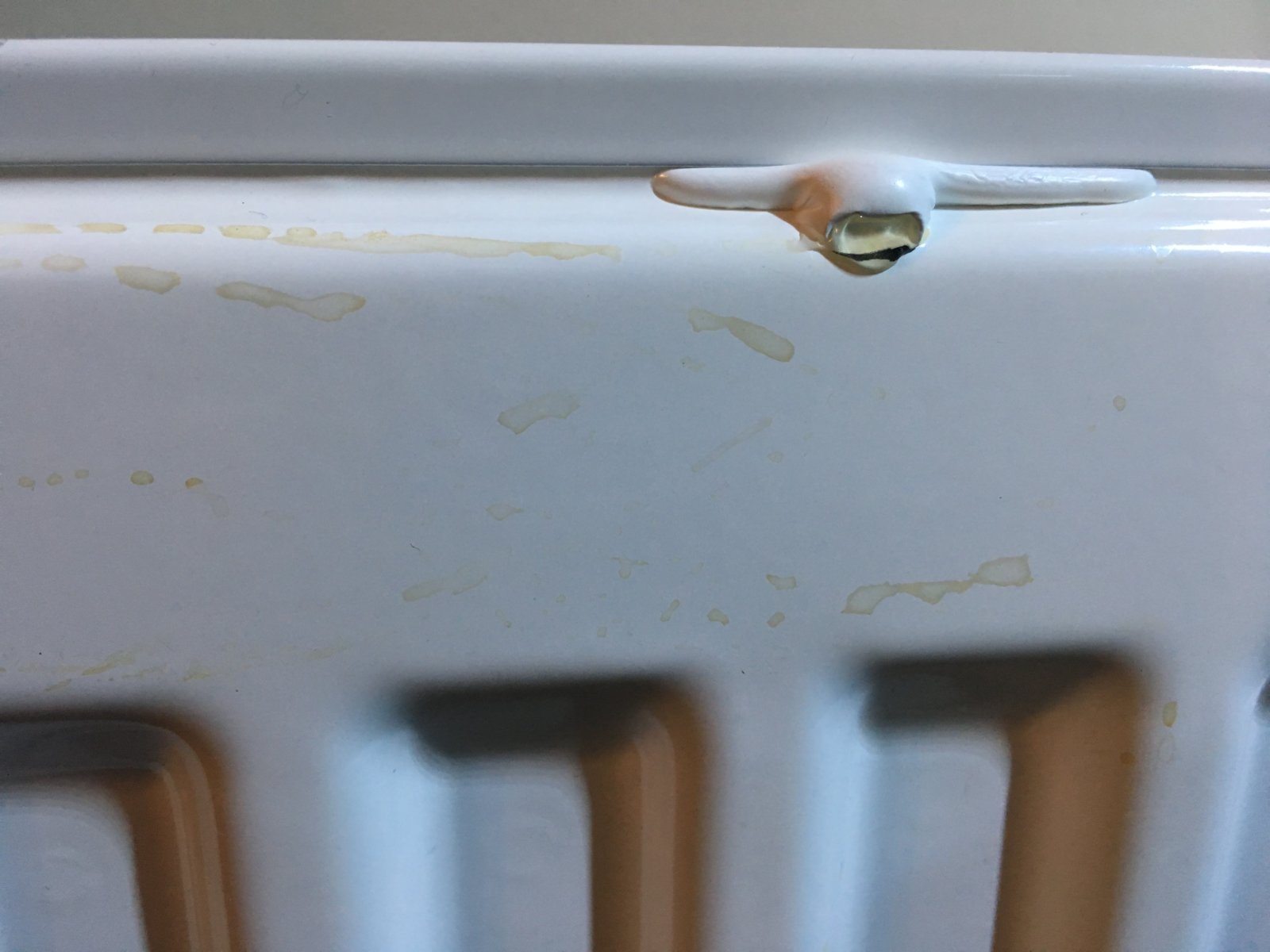

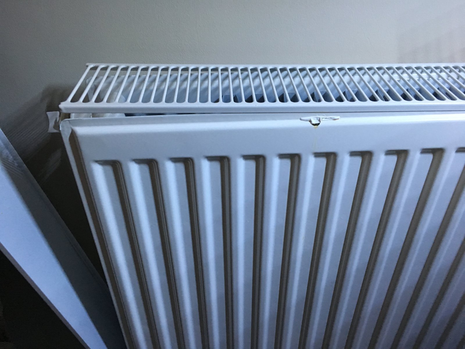

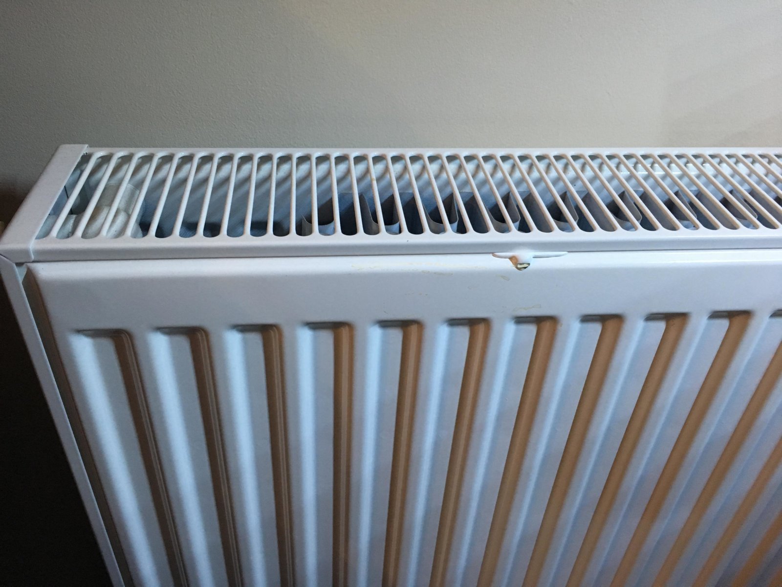

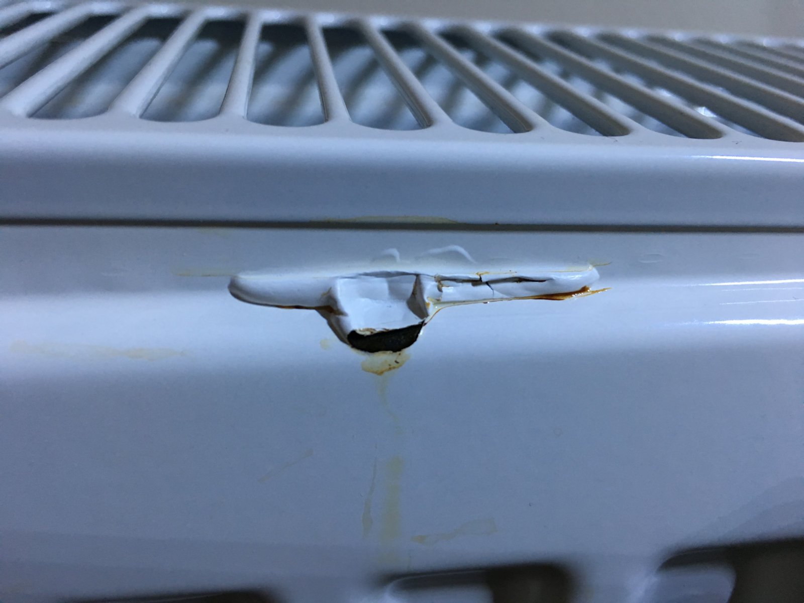

Bought 3 rads from Screwfix December 2015. Last night we noticed one of them had developed a paint bubble within the previous 24 hours and when pressed it leaked water.
Since turned valves off both sides of the rad.
What likely caused this?
https://www.screwfix.com/p/kudox-pr...tor-white-600-x-900mm/68129?_requestid=458671 <--- that's the radiator. 15 year warranty it states.
Are these rads seen as being crap or is this just a freak occurrence?
What'd you do from here on? Does it 100% need to be replaced?

It will need to be replaced, and I'd suggest you push for all of them to be replaced at the same time. A bottle of inhibitor is sufficient for a 3 bed house, but it's for stopping sludge forming; rust like that eating through suggests a faulty product rather than a lack of inhibitor, but it might be worthwhile getting a sample tested to check the level of inhibitor in the system, and that would strengthen your claim.
Screwfix rads aren't the best, but certainly not the worst, but I've never seen that on a 2 year old rad, so freak is more reasonable than crap.

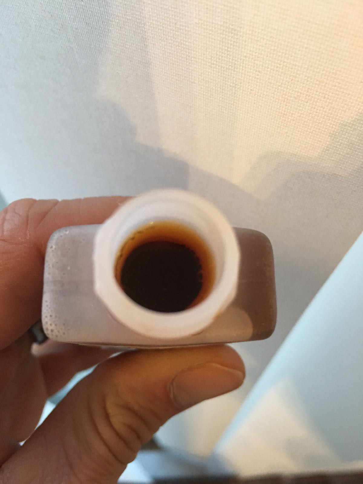

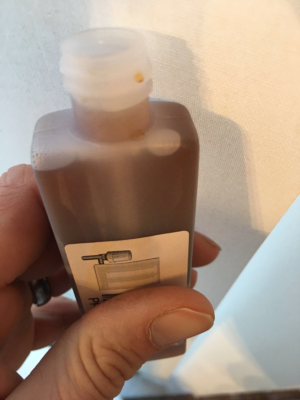

So Kudox sent out sample bottles that i've to return. One for cold tap water & the other for a sample of radiator juice.
The heating was turned on when i did this. Just wondering if this colouring is 'normal'

I know it's not so easy to tell clearly because it's in the bottle but can you tell from the photos?

Is that colour about right or bad though? We've a plumber coming out on Friday to deal with the hot-cold-hot-cold problem of our boiler. If the system is rusty (i'm purely guessing here) would it be worth cleaning out and if so then how much are we talking (roughly)?
I find it hard to believe that Kudox are going to analyse the composition of this sample in order to validate a warranty claim. These are cheapo radiators.
They’ll probably take one look at it and tell you it’s under-inhibited.
Let us know how you get on.

You could test the inhibitor in your system yourself. You can buy a kit. Or you can put some of the water from your system in a jar and add a shiny nail and see if it goes rusty.
