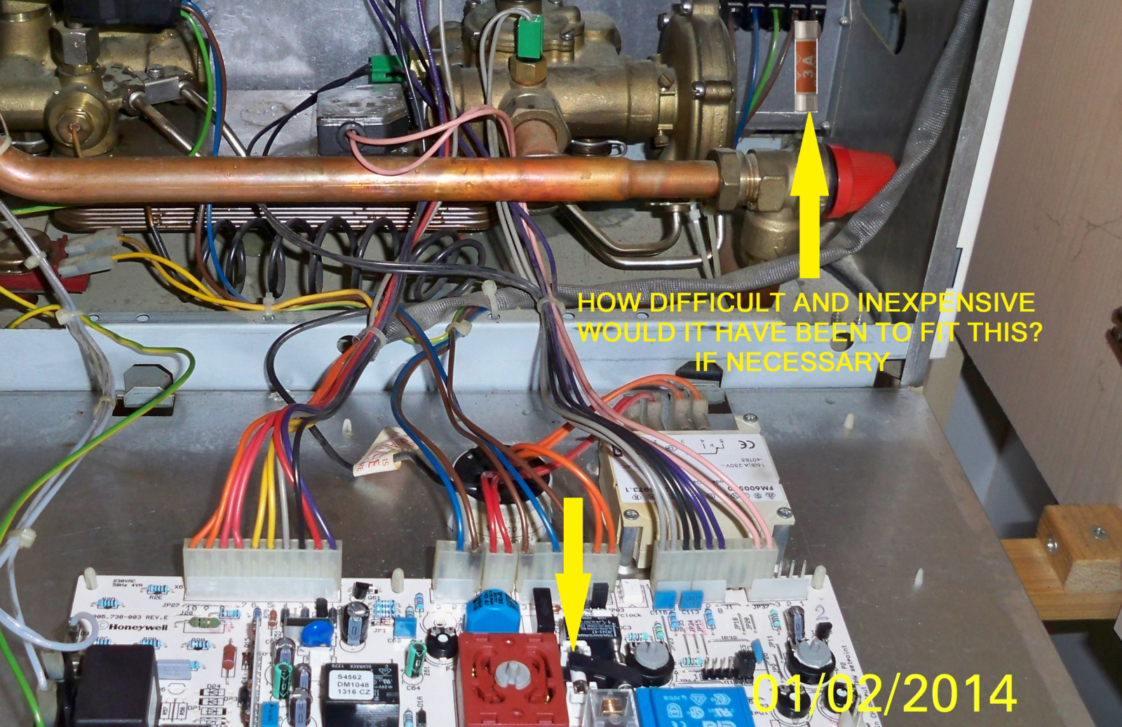

Has anyone experienced a situation where an internal fuse OR a 3 amp fuse in the FCU has blown?
An internal fuse in my daughter's combi boiler once blew, but the 3A fuse in the FCU (yes, she has one) didn't, and nor did the circuit's OPD operate.
Kind Regards, John
Old Halstead/Wickes boiler
