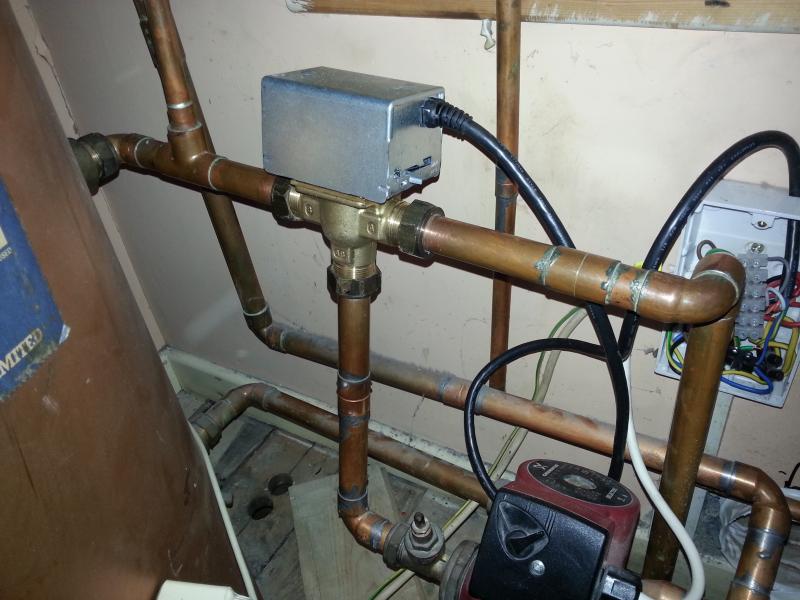

My central heating system is a conventional open tank jobby with hot water cylinder with a 3 port mid position valve, room thermostat and cylinder stat with a Siemens RWB9 programmable controller.
For years when i selected HW the radiators got hot too. I got cheesed off with this, so i bought a new 3 port valve :- Honeywell V4073A Motorised Mid-Position.
I electrically isolated the system (i'm a qualified electrician) and drained down the hot water and radiators and fitted the valve and wired it .I also added some system cleaner into the header tank (i have a feeling this bit was wrong)
Radiators all filled and bled, HW de-isolated.
Now when i first fired up the system HW only the system was working correctly and the CH port was still cold but today it's hot again with the HW on heating the radiators!!! Have I maybe got some dirt trapped in the ball of the valve do you think from the cleaner or dirt from the header tank??

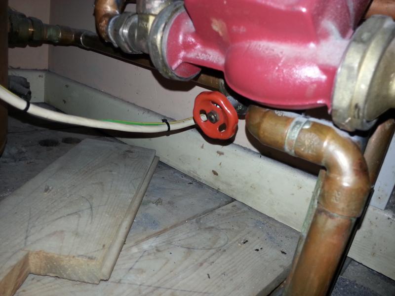

There is also a gate valve 22mm coming from the bottom of the cylinder I closed this in when I was taking out the valve, I have opened this again fully but i did not know the original position of this. I have read today somewhere else this may be a balancing valve to the heating coil?

The balancing valve sounds like bypass valve which needs to be closed as not required with a 3 port. Whilst the hot water is selected check what voltage you are getting on the white wire.

The white wire - is at 6v to N / E with HW selected

I tried HW again last night and port B was red hot which is normal and port A was warm but the rads were still warming up, significantly more upstairs than down.
My pump, does this need to be set to speed 2 or 3 ideally?
Slipperz
:D
If you leave the hw/ch turned off till the pipes go cold. Then turn the hw on which pipe gets warm first B or AB?
Ports B and AB both warm at the same rate.
This time when HW was selected PORT A was cold and B getting hot although the radiators were getting hot!!!
Now has the previous 3 port and now this 3 port been put in incorrectly??!!
PORT B goes straight into the cylinder and PORT A goes downstairs.

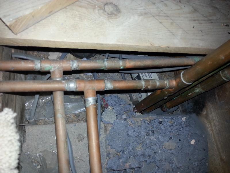

If you felt the bottom pipe in the cylinder does that become warm before the AB. It's starting to sound like a piping fault.

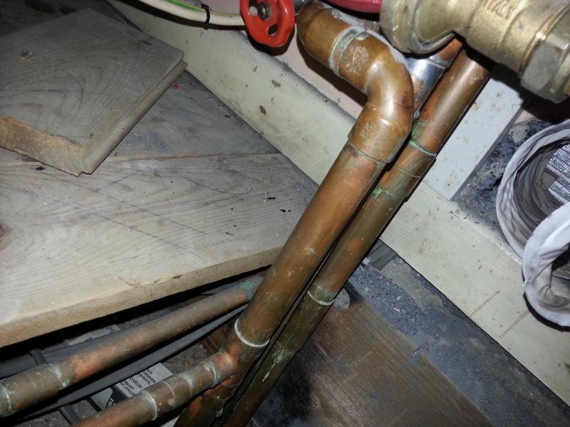

The pipe from the bottom of the cylinder goes through a 22mm gate valve then Tees off 15mm to the radiators!!!!!! So if I shut this valve in it should sort the problem out??
Slipperz
Yes the valve should off been put before the 3 port then linked to the boiler return. Even tho not needed. Shut it off snd it should be fine.
