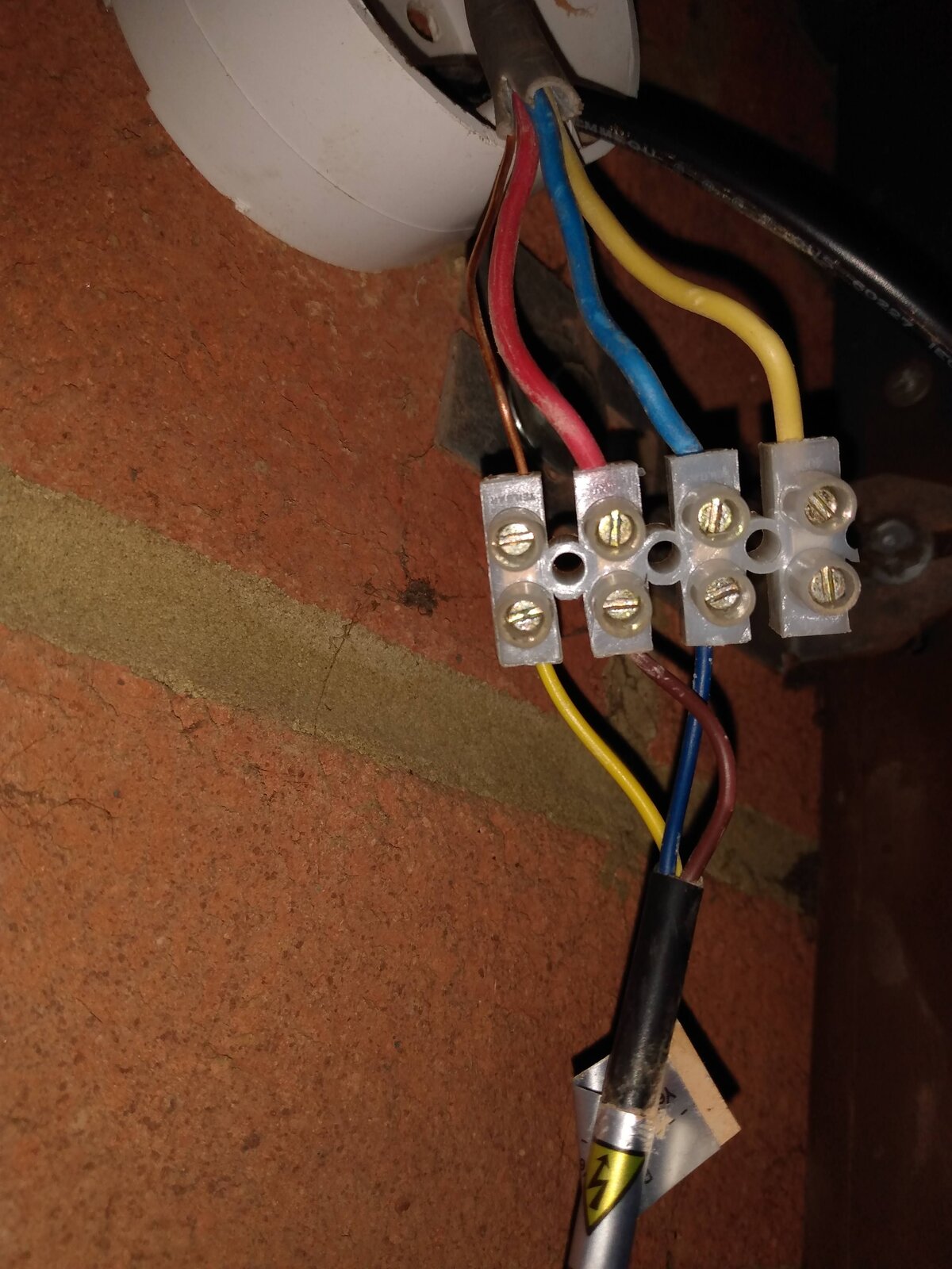

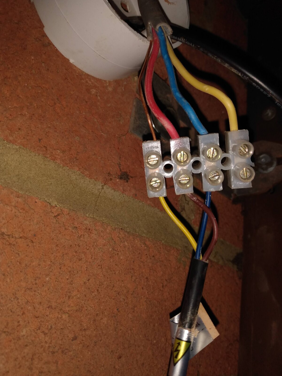

I decided to change our outside pir floodlight for an led one as it's 20 years old problem i have is there are 4 wires going to a terminal block earth,red,blue,yellow but the new led light has only 3 wires blue,red and earth hw do i wire it up here is a picture of the old wiring.John

that gave me a shock at first.
Leave the yellow disconnected and insulate. It's an override
took yellow out but not working,forgot to mention there is a switch in the garage for this to turn it off and on ,John

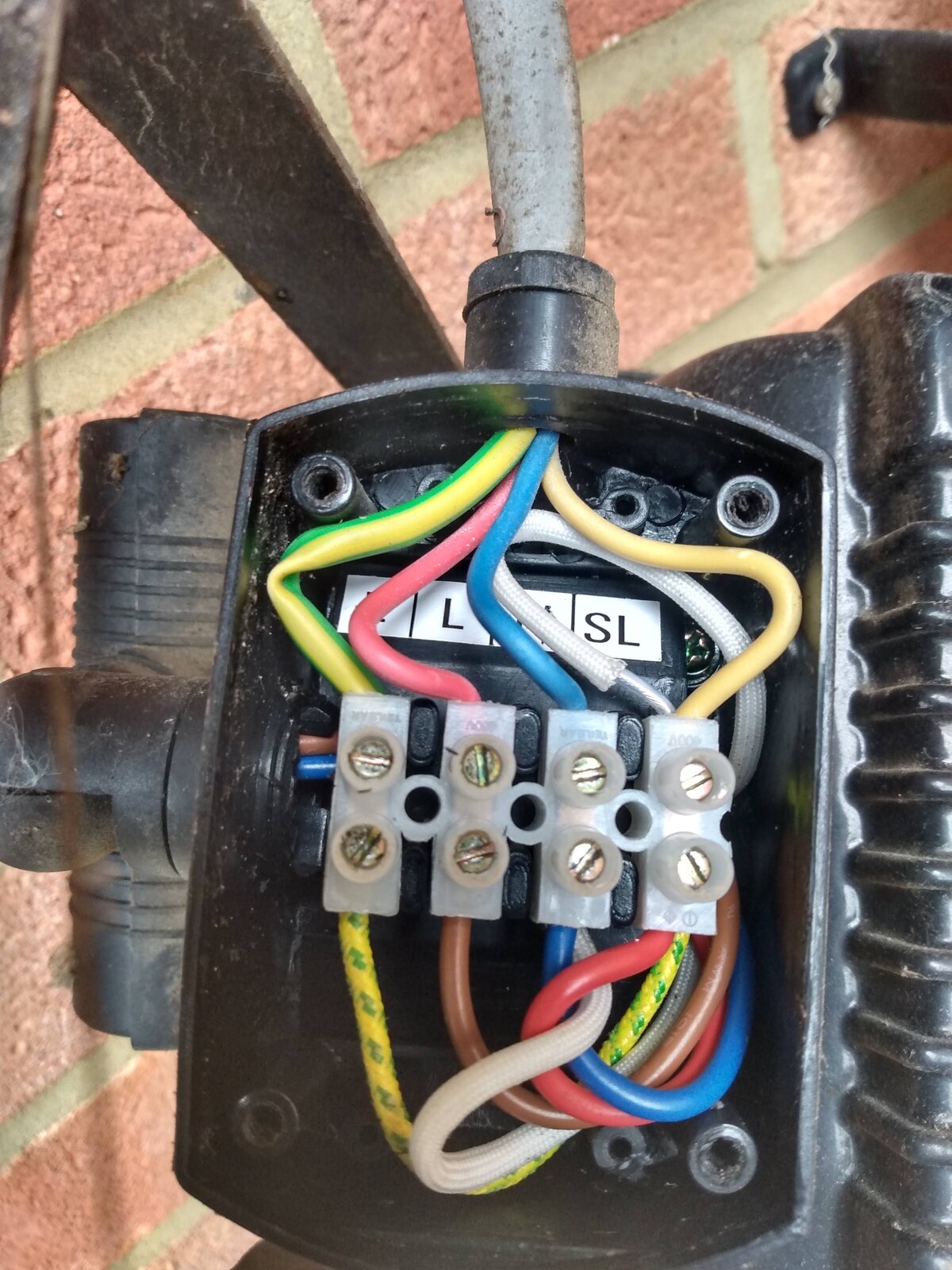

No the earth sleeve came off,i'll put it back on before I fix it all in,john
In the lamp one of the White wires must connect to the Blue ( Neutral ) wire and the other White wire must connect to the Red wire ( Switched Live from the PIR sensor ) Are those connections made ?
What about the yellow wire?
As mentioned before it is either
(1) an override circuit to allow a switch in the house override the PIR and turn the lamp ON.
(2) a supply to another lamp that is also cpntrolled by the PIR sensor
Put it into a separate ( 5th ) terminal block with nothing else connected to it.
The white wire is in the old pir. So do I have to get a fresh wire from the blue to the red wire ? John
So I have to get a fresh wire from the blue to the red wire ? Johm
NO You must NOT link the Blue to the Red That would be a short circuit connecting Live to Neutral
Did you have a lamp with a built in PIR sensor and now you have a lamp without a PIR ?
If yes then how will you control the new lamp ? If this is a switch then can you take a photograph of the wiring to that switch. Turn power off at the consumer unit before you open up the switch.
