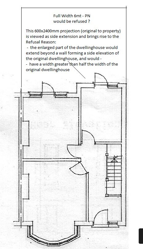

All properties in the street have the 600x2400 extension to the kitchen (built with the original building, the properties all being identical), I have noted some applications omitting this 'projection' on the drawings, yet the Officers refuse and quote the above text, do officers visit the property prior to a PN application to check what is drawn is what exists ?

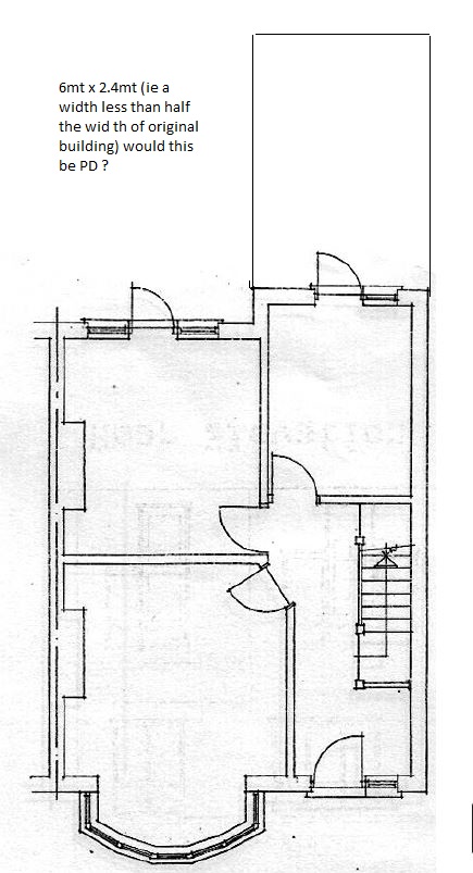

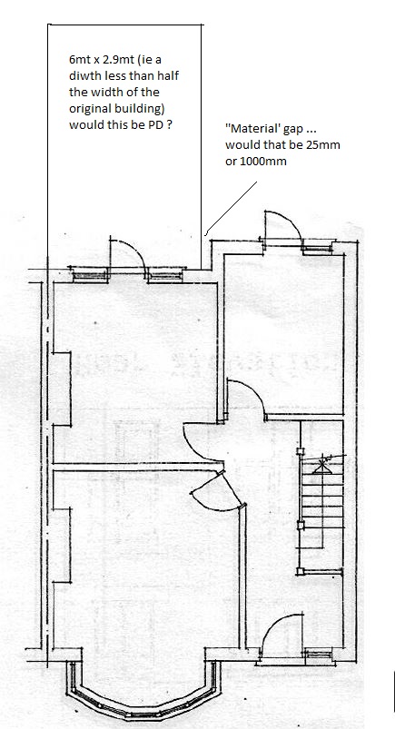

Here are some pictures to explain what I think I understand, might be allowed if no objections were made:

With a planning application there is some leeway on what can be allowed. This does not apply with PD - it either complies or not and there is no scope for loosening the rules.
The rules are simple; you can extend; from the originally built wall, or, if the house was built before October 1948, whatever sat on the ground in 1948 - that would include an extension built in September 1948.
Why not just submit your plans for approval? Not permitted development but it removes ambiguity

Where any projection exists rearward, are even 3mt full width extensions unavailable to be claimed under PD, and would be refused as:
- the enlarged part of the dwellinghouse would extend beyond a wall forming a side elevation of the original dwellinghouse, and would –
- have a width greater than half the width of the original dwellinghouse

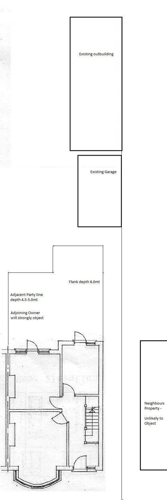

Could one split the depth in half (see below) and have the side for the objecting neighbours depth reduced (on a second app), to help mitigate any visual or overbearing impact. The other sides exposure to impact would be lessened as there exists a 2.4 mt gap between properties and some outbuildings already in place along the perimeter.

I read a case where a 6m Prior Notification was approved on appeal with the inspector seeming giving a lot of weight to the fact that a 3m PD with very high eaves right on the boundary would have had a very similar impact - in that case clearly breaching the 45 degree rule. I don't recall whether an LDC for 3m was presented with the appeal or whether just the possibility of it was considered. A moot point in your case due to your step, which only applies for the 3m PD in as far as any extension would have to step in turn.

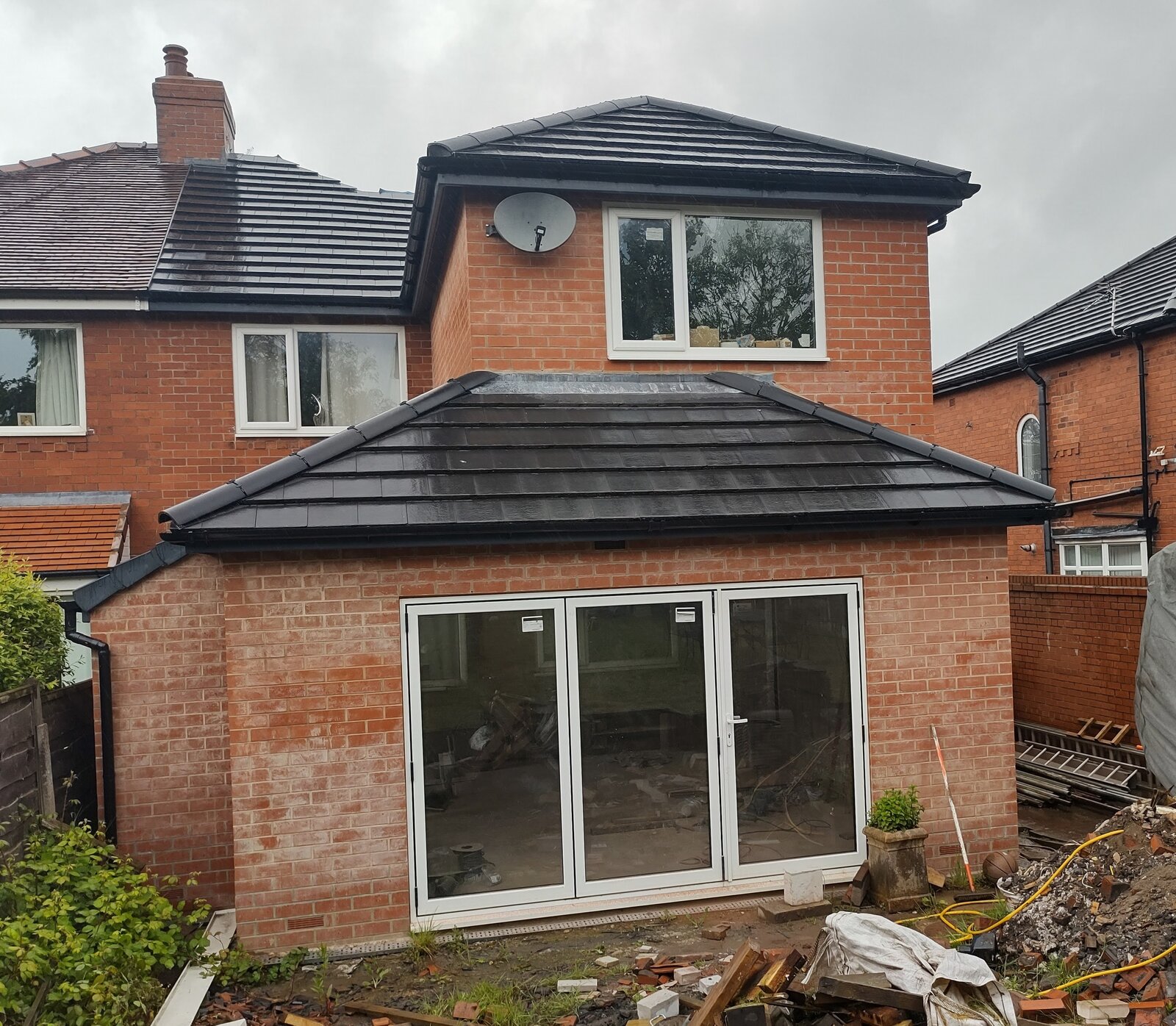

I have a flat rear elevation but my 6m PN was turned down due to my neighbour objecting. However, I subsequently got planning permission for this 5.5m deep monstrosity! Note the low eaves and the step in on the neighbours side.
'Monstrosity' is rather apt. If I was the neighbour (to the left) I'd have preferred it without the step, at least he eaves would have been lower.
@frank999 Look on your Local Authority's website for the 'Local Plan' this dictates the development policies that your local authority will take into account when they decide an application, they can vary greatly from one local authority to another, some may only have a few paragraphs regarding domestic extension, others will ave pages and pages.
cdbe ... matching materials, matching roof pitch and finish, windows in proportion, I think it looks good, nice job ... in comparison some of the c**p round here, built by people who don't care how it looks, its just the rental they are after, so lurking behind the 'street scene' nastyness polutes the visual amenity..
So what we see on your extn. (presume it was just the Ground floor that was added) was pbtained under full plans, how deep is the step in, and did the council request you do that. I like the pitched roof, looks good, was that personal choice or did planning officers advise you do it ... I am concerned my council might view such a pitched roof as adding to any 'overbearing' impact.

Where would one stand with an appeal ... if you have an appeal case that argued that justy 600mm was not a side wall, which is what I have.
@tony1851
Has commented on 3 appeal cases:
There are several planning appeal cases on the Planning Jungle site on what constitutes a side wall. Three refer to single-storey side walls of depths varying from 0.55m to 1.2m, and determine that they do form a side facing wall; one appeal case states that a single storey extension projecting 0.6m does not constitute a side wall - so it's a moot point.
