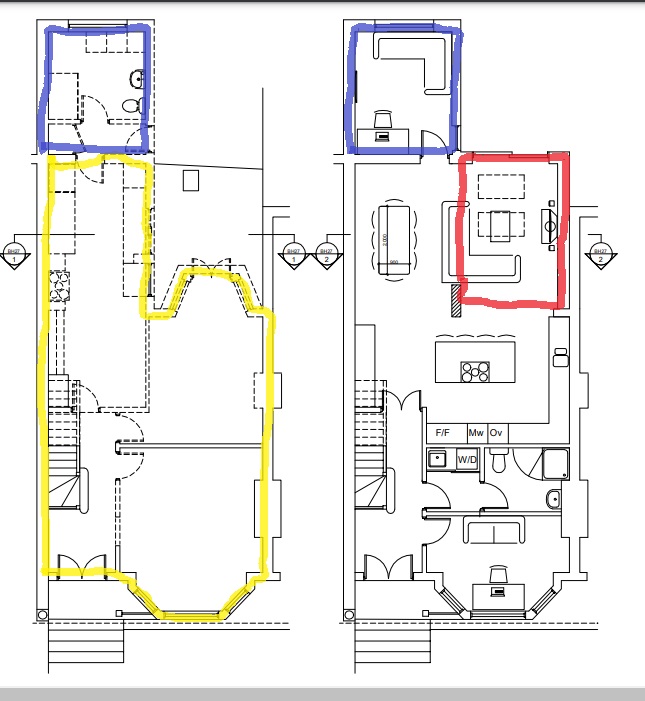

Can someone help me understand this point, a prior approval has not been considered permitted development because its width would be more than half the width of the original house even though the width of the extension is not, only when they combine it with the width of the existing original extension... They use the term combined to infer that if you extend off a side wall of the orignal extension then it becomes part of your proposed extension? Legislation states

Im pretty sure its original built with the house, there is no history of the existing extension being built. The officer even uses the word original "that the proposed extension would be joined with an original rear extension and when combined" im just not sure it seems to be treated as an extension added to a previously added extension.
PD relates to the original house. If the house has been previously extended, i.e. post 1948 then any future PD extension would need to take into the existing extension.
Are you saying you’re disagreeing with the LPA’s view as to what is original and what is an extension? Do you have any drawings/photos?
No not anymore there is an additional extension its more to do with if the extensions join or not.
Im just doing research because I am trying to learn and going through cases that have been recently declined, and I cant work out why this one is declined I want to know. The case is 20/03085/CEA on https://new.enfield.gov.uk/services/planning/the-planning-register/ The officer is saying the new extension joins the previous extension but it does not join according to the gov guidance https://assets.publishing.service.g...e/830643/190910_Tech_Guide_for_publishing.pdf see example on page 27 and 28 the proposal is the example shown on page 28 but the officer seems to be claiming its the example given on page 27. As the the guidance states If the rear extension B is added at a later date, it has no effect on the width of the side extension (as it does not join it). The example given in that guidance is identical accept you would switch A for B.

Right I thought the existing extension was the toilet area part starting from under the bay window. If the entire 2 story from that wall you highlighted is an extension then yes it will clearly be joined. But just for educational purposes if the current extension was from the bay window the toilet part. And you added an infill extension as they proposed would that be PD?
Also if theres no planning history to determine if the extension is original how is the decision made?
I don’t know. I’d have to see the plans.
As for the Planning history, just because there isn’t anything online doesn’t mean there isn’t any history. Planning will have records and resources and it’s not that difficult to ascertain what’s original.
I would say the yellow outline is the original house. It looks like an original 2 storey outrigger at the back NOT an extension. From DevilDamo's aerial photo there are houses nearby with the exact same outrigger which look contemporary with the style of the house. The blue is the previous extension and red the proposed new extension.
So as long as the proposed extension is no more than half the width of the house then I would say it is PD.
