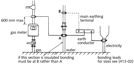

The boiler is not in the bathroom but is passed by the main earth bond cable on it's way back to the consumer unit. I wanted to join the gas pipe into the main earth bond one piece cable.
On its way back from where? Main equipotential bonding conductors run from where the gas & water service pipes enter the property to the main earthing terminal. Not to the CU:
And how far is it from where the service pipes enter to the MET?

I have now linked all the metal appliances in the bathroom together on an unbroken 4mm earth wire, directly linked back to the main earth block where the electricity supply enters the house. I propose to do the same with the cold water supply pipe to the shower, which cannot be accessed from within the bathroom. There is a 2.5 mm supplemental earth bond between the pipes on the bathroom and the water pipe to the shower.
Any problems here?
