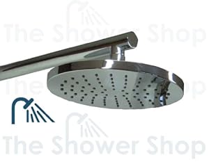

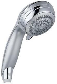

unvented's are restricted to 3bar by regulations and for safety reasons, that should still give you a very powerful shower depending on type of shower head, drench or rain type heads by their very nature give poor pressure but good flow due to their large surface area, if this is what you have changing them for attachments with with a more concentrated spray will give you that "taking the skin of performance"

bad for power shower type spray
good for power shower type spray
this is assuming that you actually have 3bar and a high dynamic flow rate coming into the property.

Thanks guys - I didn't really consider the smaller shower head, but makes perfect sense.
The performance of all of the showers is more than acceptable. However, there is a difference between the closest and furthest, and I wanted to understand the reasons for this (and possible future solutions). And yes, Tony, the unvented and boiler are serviced annually :). The performance has been the same since the start, it hasn't gotten any worse over time. Interestingly, the shower head which is closest to the cylinder is slightly larger than the other 2, yet still gives the most powerful output.
