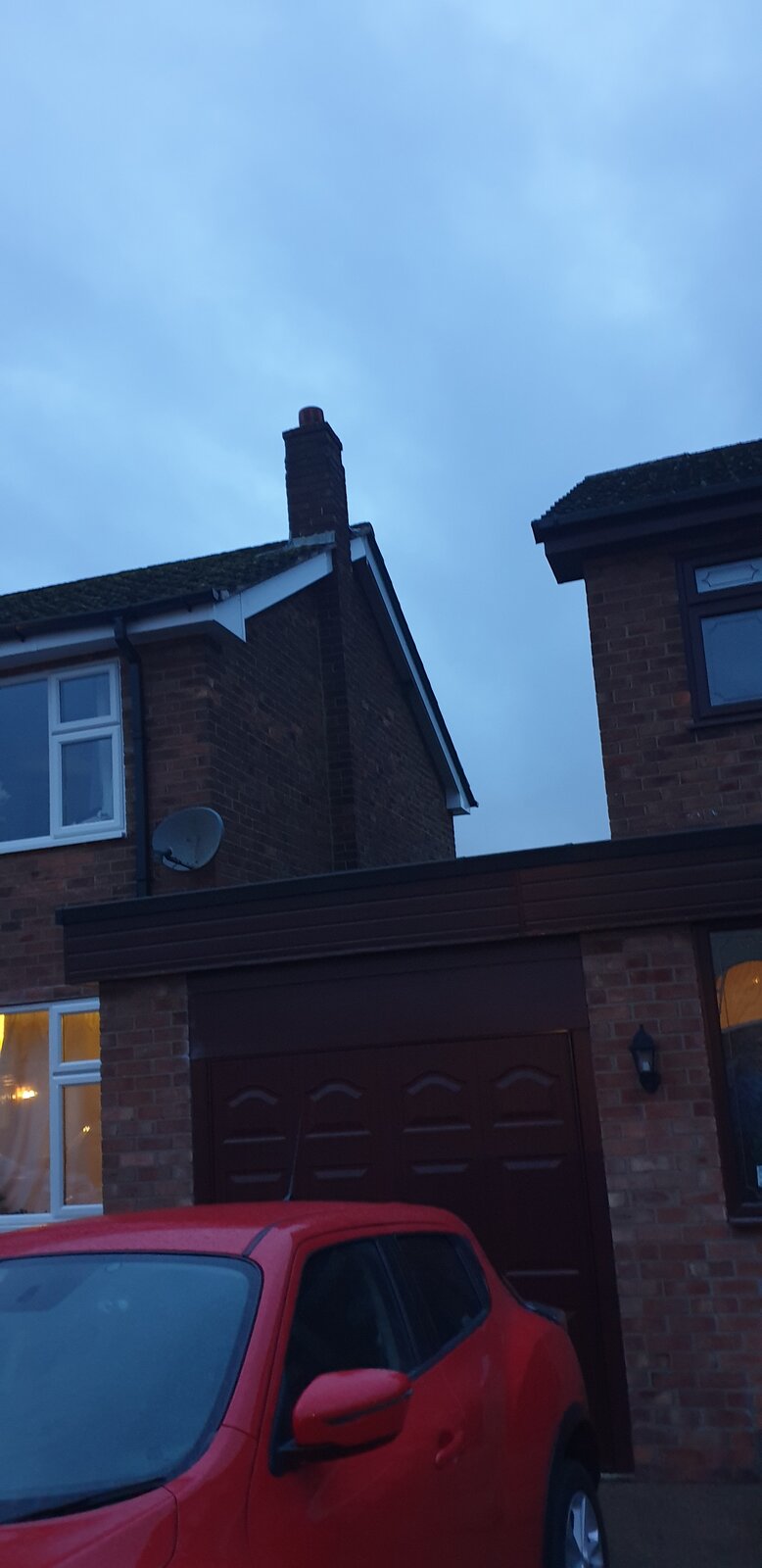

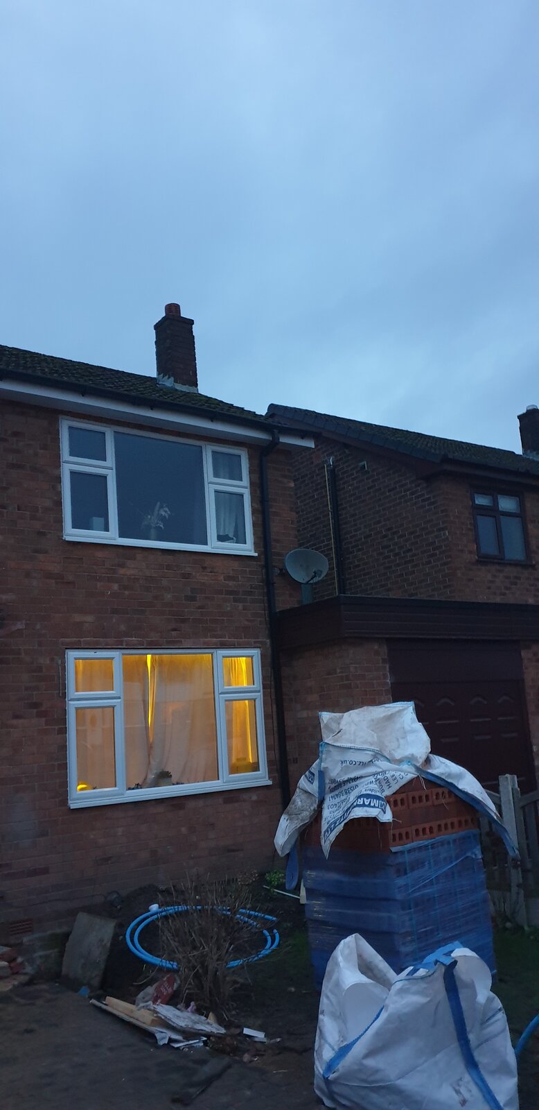

Get a firm that will work from the front and rear scaffold only, as your wont need to access the verge. A continuous dry verge would deal with needing to work from the gable.
Otherwise, Access to Neighbouring Land Act 1992

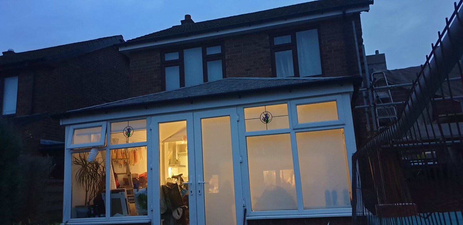

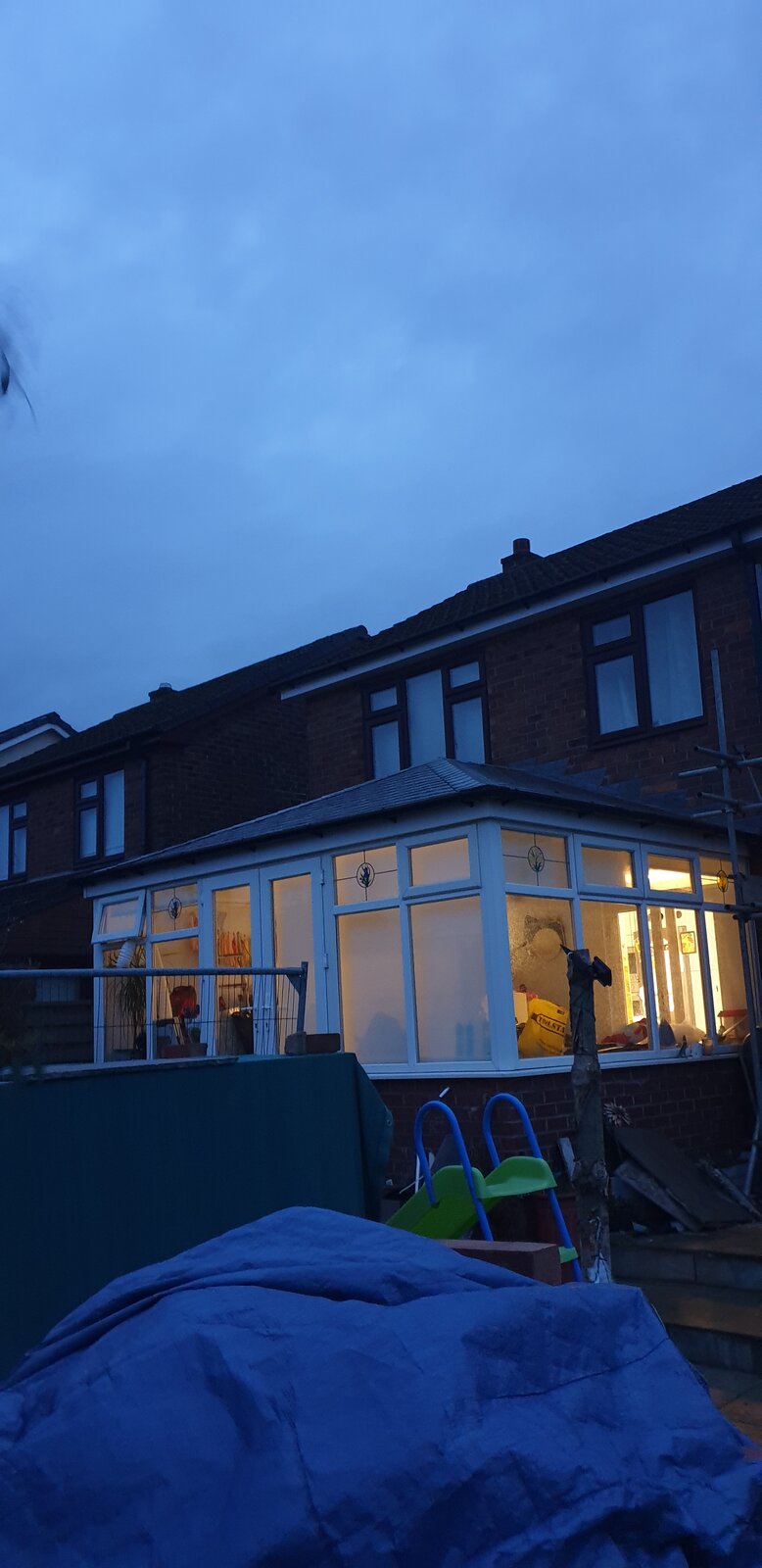

The fascias and soffits all need replacing too.... there are asbestos sofits that need to be removed first. Cant imagine they can do all that without accessing the gable. Ill post a pic....

The rear conservatory would make it even more difficult
I'm wondering whether to leave the fascias and soffits on the gable.... they were capped over 4 years ago and still look good, but I know the wood underneath em (Fascias) is well rotten and I'm concerned if I don't replace em now, ill need to do it on a few years anyway and I'll have to deal with it all again. While the scaff is up, I suppose it makes sense to do it now.
Its the soffits that are asbestos, under the capping, not the fascias. The fascias are rotten wood under the upvc capping
If the covered fascia is not getting wet, then it won't be rotting.
Scaffolding could be erected standing entirely on your property, along the front and back walls, and then overhang the neighbour's garage without touching it.
Anything across the boundary, even a cantilevered bridging unit, needs permission if the landowner.
