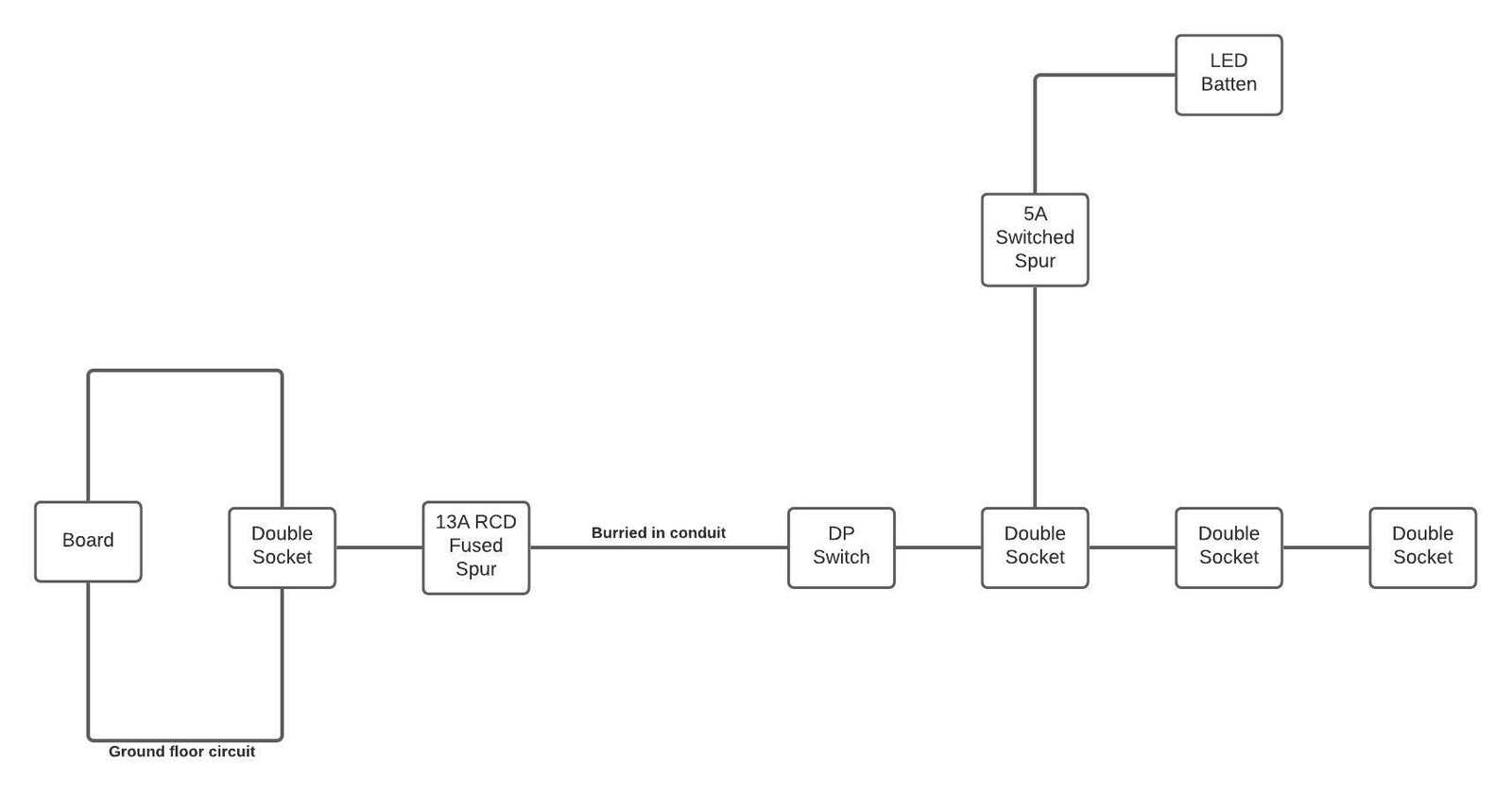

I currently have a 13A fused spur that supplies power to my shed. This would have been done at a time that predates current standards, and as I've now replaced the shed (but kept the existing supply), I'd like to add some sockets and modernise it where I can without having to run a new supply.
Currently it's as follows:
  • 13A fused spur -> conduit to shed -> junction box ->
    • 5a switched spur -> light
    • double socket
I'd like to add RCD protection in place of the standard 13a fused spur, add a DP isolator and add additional sockets, similar to option 2 in the following, but with additional sockets.
https://electrical.theiet.org/media...tdoors-a-supply-to-a-detached-outbuilding.pdf
My understanding is that it's not notifiable because the existing supply predates current standards, but I obviously want it to be safe, so I'll likely complete the cabling in the shed from the isolator switch onwards, then get a pro to verify it before making it live.
Does the diagram attached seem sensible?

Using a RCD FCU seems to be simple way to add RCD protection, technically it does not comply as the BS EN numbers for a RCD FCU are not the same as stand alone units, and BS 7671 states what BS EN number should be used, but that is being rather pedantic, and I would fit a RCD FCU without any worry. It must be an improvement.
The IET wiring matters is dated 2005 so we have had two editions of BS 7671 since then, again technically it is design date which matters, and by adding a RCD you are changing the design, so it should comply with current regulations, and you would need to write out a new installation certificate so not so sure if considered as a new circuit, using the minor works form would likely be better, as then not seen as new circuit, but unless rented property would anyone care or bother checking?
There is a huge difference when an electrician does work which is registered with his scheme provider and LABC and so many of his jobs will be inspected by scheme provider so some one is checking their work so it must be A1, with DIY it is more down to common sense, unless rented where you know it will have regular EICR done.
It's not rented, but of course I want to be safe. I don't seem to have much luck getting competent people in or being able to find them. I've found someone who seems sensible now. Just wanted to make sure that my proposed plan is sensible and safe, then I can get the conduit and sockets run for him to finally cable and test.
Except bs7288 explicitly says that rcd spurs cannot be fitted to a circuit which does not already have additional protection already fitted, ie they cannot be fitted unless the circuit is already rcd/rcbo protected.
it isn't an improvement fitting an rcd spur standalone as they do not offer additional protection or safe isolation and they are an obsolete product, hence there withdrawal from bs7671 in jan 2019 and fitting them standalone is a non compliance.

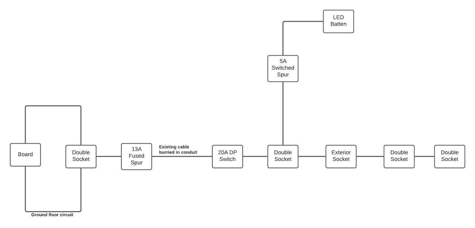

In which case it sounds more sensible if I forget the RCD, leave in place as is and at least add an isolator switch at the shed end. I actually wanted an exterior socket. Is it possible to add this without an RCD? It would be via 20mm conduit, directly into the back of an IP66 rated double socket. Attached a rough diagram.

All new socket outlets require RCD protection. So do lighting circuits in domestic premises.
Sockets that can be used for items outside have required RCD protection for decades.
The only compliant ways to add RCD protection is to add it in the consumer unit which almost certainly means replacing it, or to add a separate RCD next to it for the socket circuit only.

So If I can’t add an RCD to the shed because the main board isn’t RCD protected, I can’t add an external socket? Or are you saying now that I can add an RCD in the shed to protect the external socket only (that’s the only new socket), and that doesn’t require an RCD protected main board?
Ok. So a new CU would add RCD protection. Does that still mean a secondary RCD is required for the shed mains radial so that I can run an external socket? Or would that now mean the 13a fused spur from the house is sufficient?
Once you had a new CU with RCD protection. (or RCBO) you wouldn't require any other RCDs
