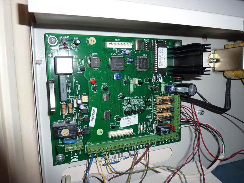

Hi all,
I have a now expired contract ADT alarm in my 1 bed flat. ADT don't want the alarm back, and they won't provide the engineers or installers code.
I'd like to mainatain it myself (I have installed and maintained a screwfix Tate alarm for some years).

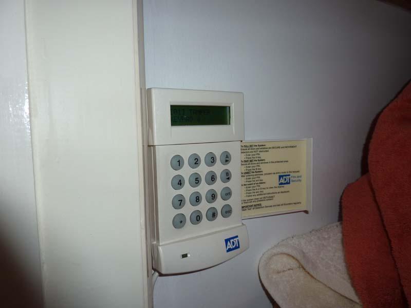

Can anyone identify the keypad and alarm?
The alarm PCB is in a metal box with Thorn security siteguard marked on it. There is no schematic or other identification.
The system is simple; 1 door contact, 1 PIR covering the lounge, 1 PIR covering the bedroom and an external bel box. No PIR covering the hall, bathroom or kitchen.
Can I reset the panel to gain full control? or if I have to replace what components can I reuse?
Thanks very much.
It's a Galaxy 16+ You can reset it and get it to work, but I would suggest replacing the control panel and battery. A G2-12 will be compatible with everything else you have. The 16+/8+ have a different menu structure from all the other Galaxy panels and it's horrible.
You can pick up a G2-12 on Ebay for about £40 brand new delivered and you'll get a new 7Ah 12V battery for around £15.
Programming the Galaxy 2 series is fairly straightforward and if you get stuck, I'll help you out no problem.

Why bother changing panel on a one bedroom flat nothing wrong with the 16+ if its working leave it alone......
