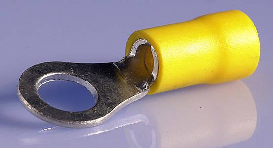

The best option IF the ring will fit under the screw AND the correct crimp tool is available. I have seen a few crimp terminals that were crimped on with pliers, Some were OK but a few over heated and at least one burnt the terminal assembly.
The op should use a decent crimping tool, I'm sure someone can recommend some types.
Often see a kit with the tool and a selection of crimps - a bit over-kill for the op perhaps, but very convenient if he's inclined to use them again.
The type should be one like this:
not like this:
Indeed, but if he does only ever need it for this job then buying a couple of metres of the right sort of flex would be cheaper.
