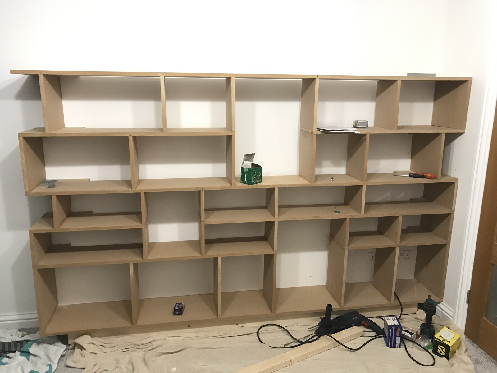

I’ve built a bookcase and would welcome your advice on how I paint/stain this please.
It’s constructed from 18mm MDF and here’s where I am currently at:

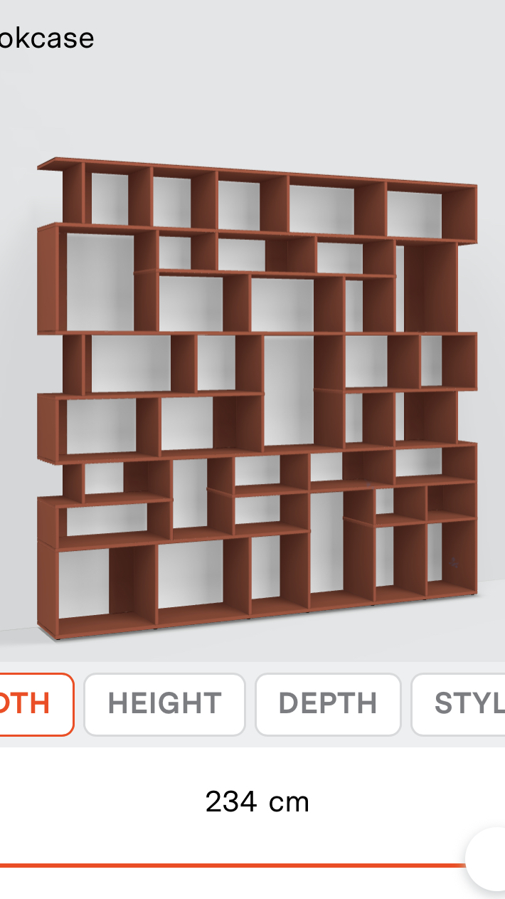

I’ve got more to build and here is the design I am following:
I’d like to finish this in a wood colour if possible. I appreciate the limitations of MDF. My doors have Osmo Oil and I’d like to get close to this colour if possible.
Can you also advise if I first need to primer.
Thanks in advance.
Definitely prime the mdf first otherwise you'll be painting for the rest of your days.
Then any colour of your choice will do.
Which primer do you recommend for this?
Also, is staining an option for MDF?

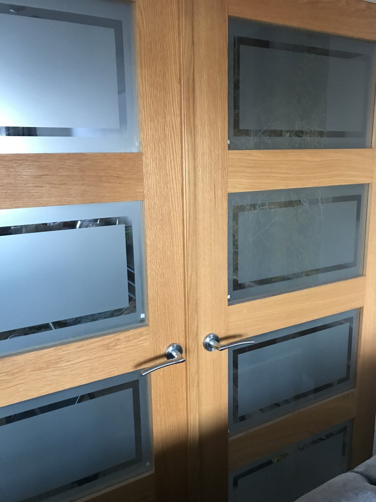

Can I please have some more advice on this as I am unclear on how I should approach this. Here’s the colour and finish on my doors
I am hoping to achieve a similar look to this. I’m unsure on whether I should stain, prime and paint or something else.

Those doors are made of wood or veneer.
Your bookcase is made of mdf.
You have no chance to achieve 1/10 of that finish.
Your best bet is to paint the bookcase with a flat bold colour (white, black, pink, orange, green, blue...)
If you wanted a wood finish the bookcase should have been made with... you guessed it: wood.
I appreciate I won’t get the wood grain showing through but why can’t I have a similar colour?
As stated you need a primer, you will need to do at least 3 coats (be prepared to do more), sanding in between, use a roller or a sprayer
https://www.toolstation.com/leyland...-6UcKR_3ew7oIxix8PM-W94uDKiRaIARoCf3MQAvD_BwE
For a wood colour, you'd likely have to have it special mixed but you would need a sample of the colour you want for them to match it.
For a top coat you will want an acrylic paint, again spray or roll it. Spraying will provide the best finish, but you might have to do a bit of practicing before attacking the book case
How good it would look without the grain I couldn't say, antique oak would just look like a browny yellow, for example.
If you haven't sprayed before, do not attempt it.
It will come very dusty and rough with all those corners.
