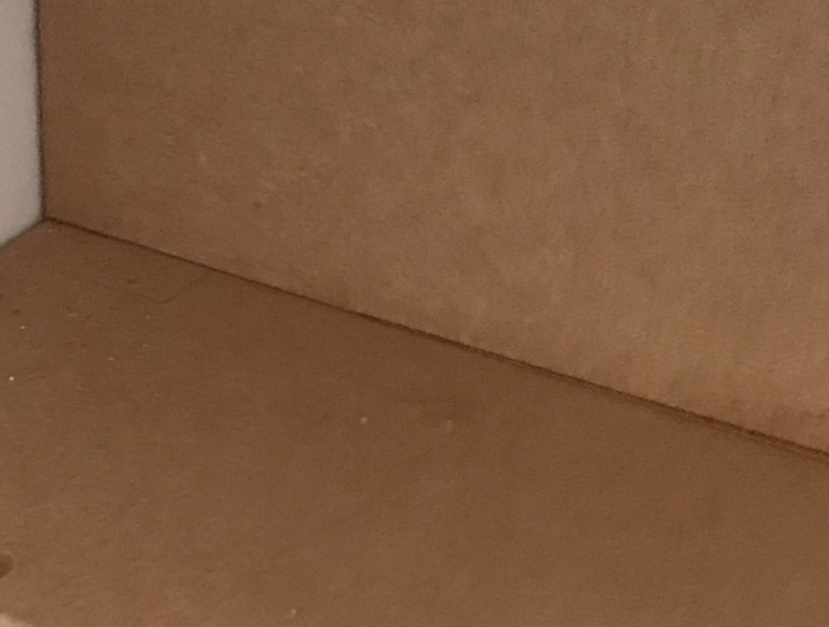

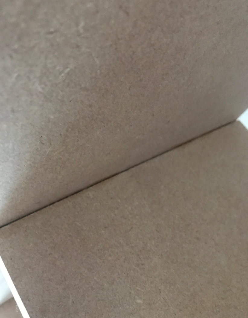

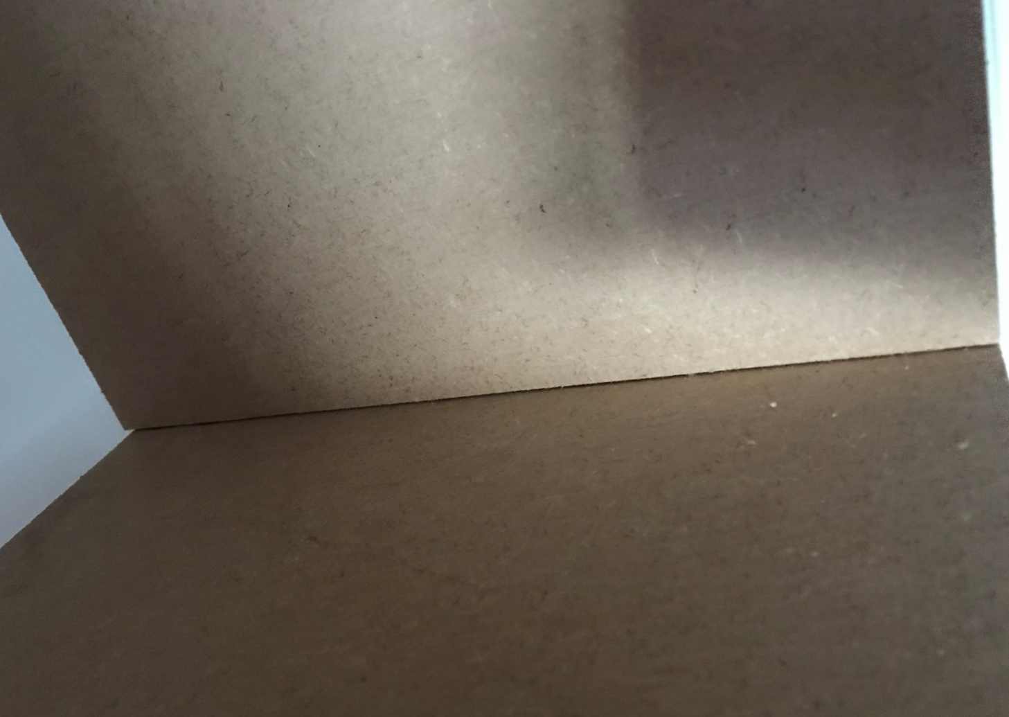

Someone mentioned caulking on another forum but Toupret wood filler has also been mentioned. It's actually for these type of joins:
I thought a finger-applied caulk or filler may nicely squeeze into the gap and improve the finish.
I cut all my MDF sections with a circular saw following a timber batten - clamped to the wood. I am guessing it may be 1-2mm out on some edges.
There is no problem using filler on the joints, screw holes and even the edges. Sand and dust before you prime. I have done this for many years in various shop fitting companies although we spray finished or laminated rather than painted.

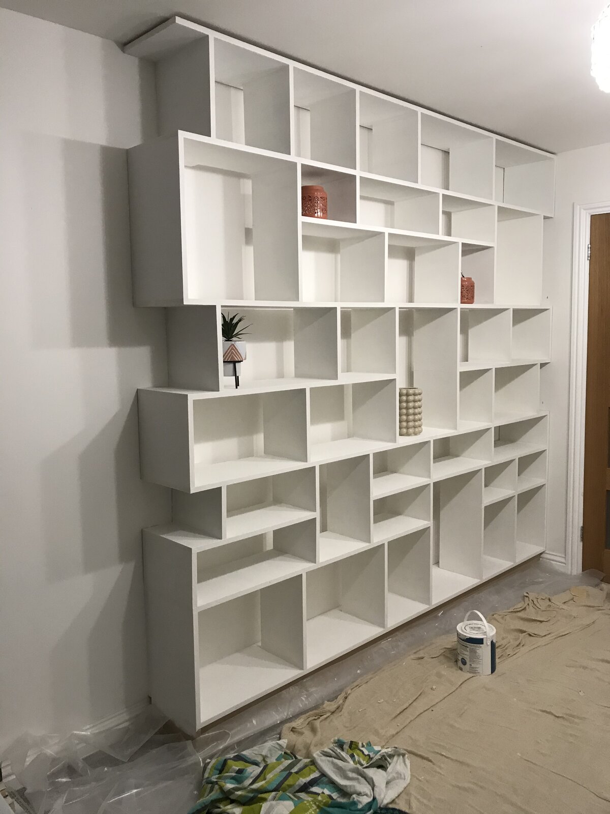

Should have added a current pic with my earlier post. Here’s where I am at. I’ve given it two coats of the primer and sanded in between.
I’m really chuffed. Have to admit that I am getting into the habit of staring at it in admiration...
Not finished yet and there’s no way I could have done it without all the input I’ve had from this forum (a few posts that I’ve put out over the last few weeks). Thanks again
