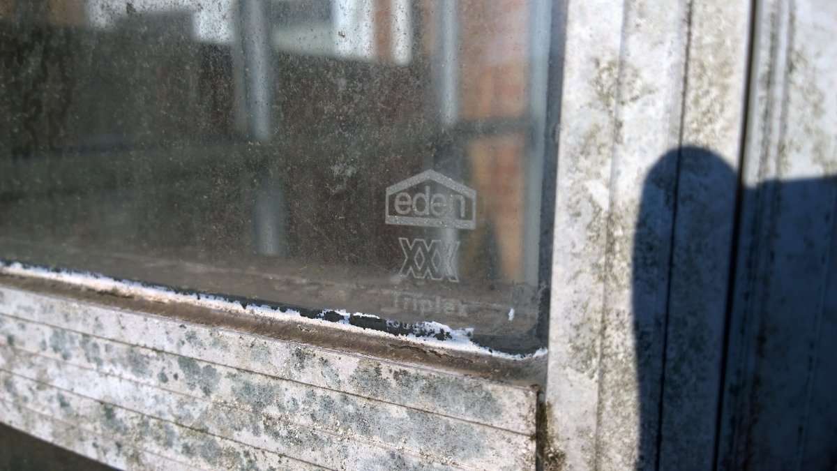

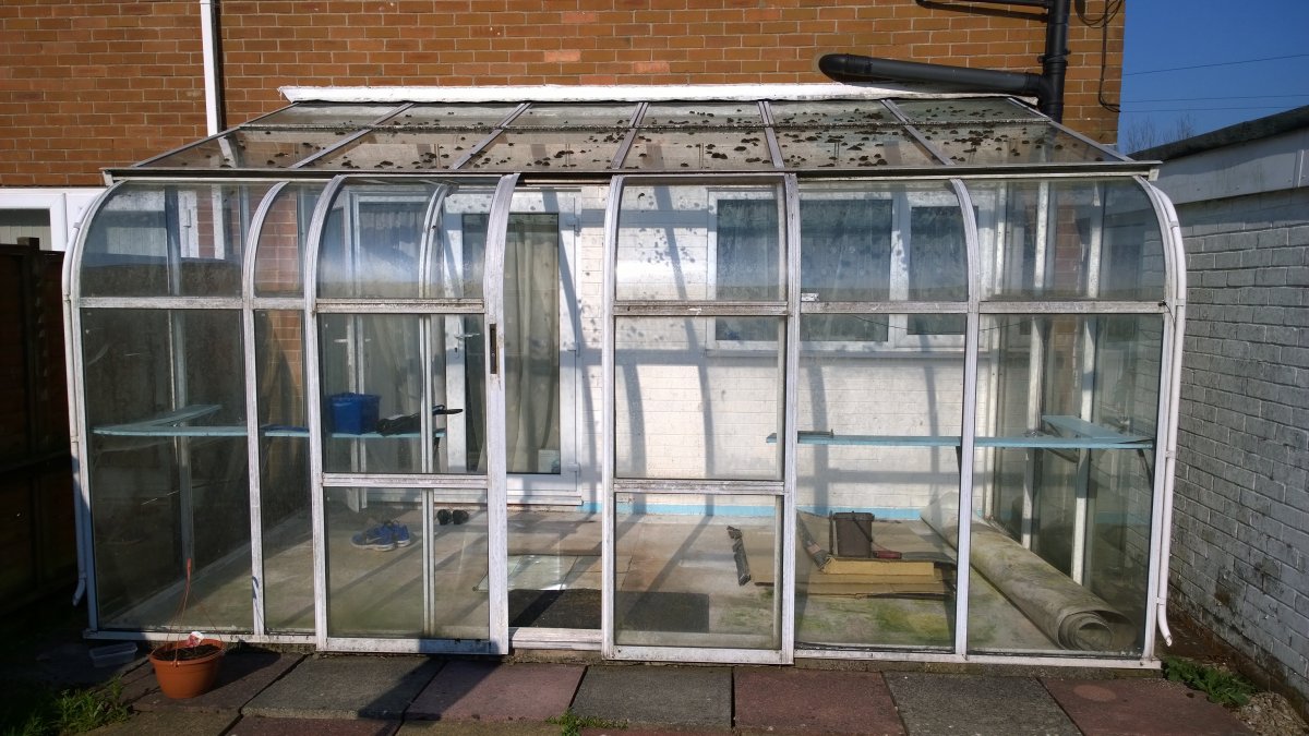

Tomorrow I will finally be taking down this ancient aluminium conservatory (which I believe is actually just a greenhouse). It was there when we moved into this house in 1997 and it was horrendous back then.
It's insanely ugly, freezing in the winter months, unbearably hot in the summer and leaks like a sieve.
My question is, can anyone identify it? And where do I start taking it down?
I believe it's an 'Eden' which is stamped on all the glass, but I can't find a picture anywhere on the internet which is similar to this one.
As for deconstruction, the entire thing bolts together which is handy but I've no idea where I would start with this. Logic would say the roof. Looks like a lot of modern greenhouses have glass which is held in with metal clips - this has no such thing, just rubber seals all around (most of which have perished).
Any advice greatly appreciated.
Oh, such a nice piece! If it's anything like the greenhouse I took to pieces, you'll find all the glass is clipped in with stainless steel clips. Support the glass, pull out the clips, and safely store the panes. Once the glass is out the frame is bolted together and possibly in this case screwed to the house brick somehow.

Yes the whole thing is bolted to the brickwork so that looks quite easy.
Good tip on the stainless clips, I can't see any anywhere from the inside or outside so they must be concealed somewhere.

It's toughened glass XXX Triplex like the old car windscreens so it will shatter in a million pieces if it's going to break:eek: so protection is essential - and luck
2Nd picture seems to show silicone sealant, so they may have lost the clips in the last transfer, and just sealed everything in. Trying cutting round a panel and see what the result is. Alternatively, is it like a double glazed window, in that you put in the seal, then clip a piece over it.
Well it came down today. I was in work all day so don't have much information as to how things came apart but I'm told it was extremely difficult.
Such to the extent that they decided there was no way in hell it could ever be reconstructed (things had seized, rubbers had perished etc) and some metal had to be cut with a grinder.
So I'm left with a pile of aluminium and glass in my garden!
Anyone interested in it is welcome to pick it up if they have a van. All the glass is intact, none broken!
