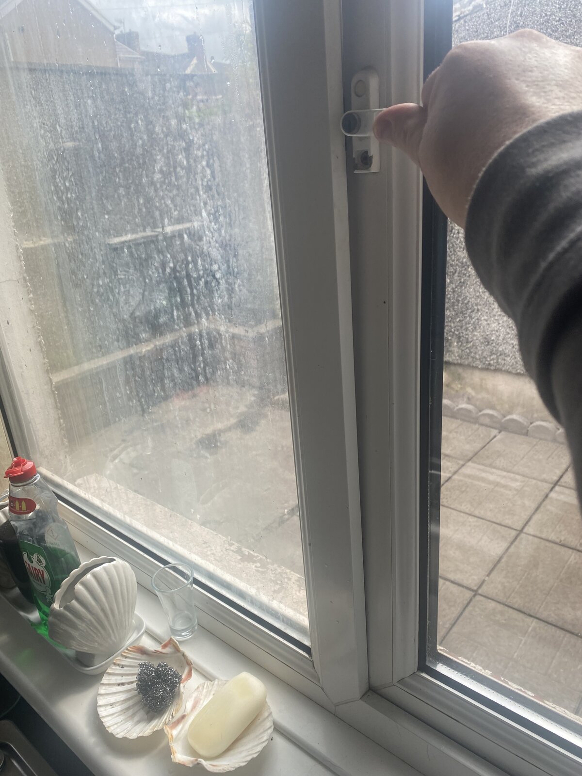

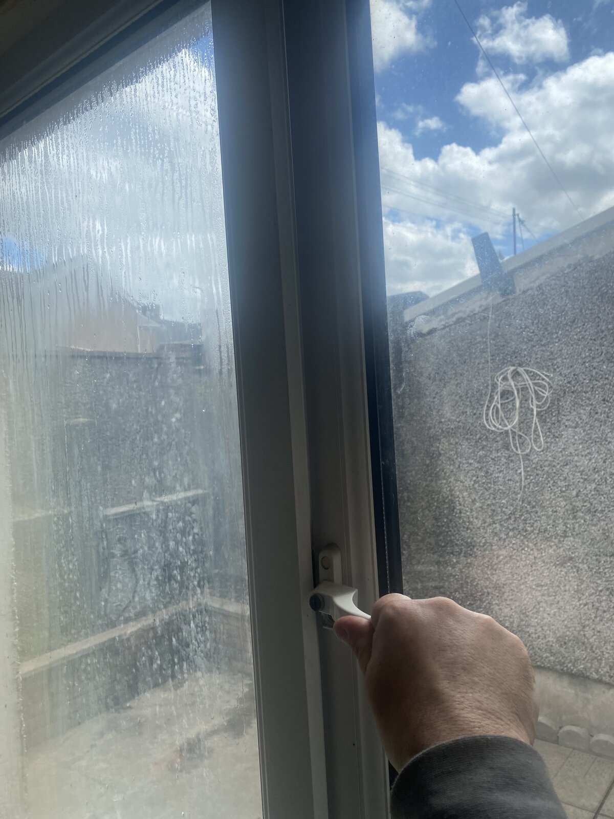

Hi all
I am unable to open a window as the bottom is stuck/not moving with the handle?
The top part opens/locks ok as when I try to open it I can push the window and create a gap as in pics.
Amy ideas on how I can open it and check the mechanism without damaging/forcing it open??
Cheers

Am only guessing- Just take the two screws out, and use pliers to twist the bar.
The centre gear box has failed, it works like a steering rack on a car, likely to be a tooth sheared or a rod connecting the bottom half has snapped and only the top half is working so the handle and spindle still work. Take a look at another window for measurements but at a guess it'll be an 800mm or 1000mm X 20mm or 22mn backset, the glass will need removing to aid in twisting the sash open
Bread and butter to a service engineer like me, if getting someone in expect to pay £120 to open the window without damage and to replace the mechanism

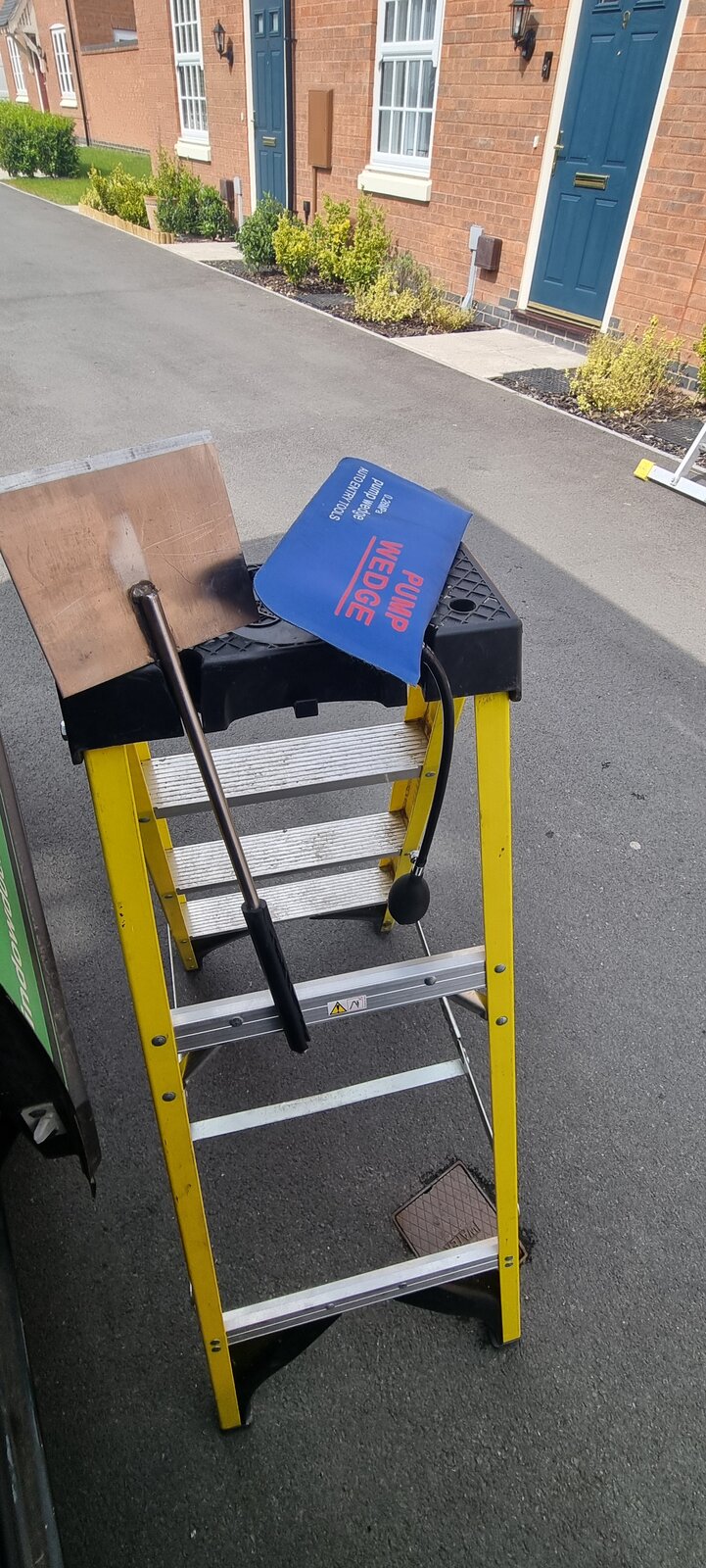

Remove the glass from the opener, push the top corner out as far as you can or at least so the opener is out of the frame, assuming the bottom cam engages going down you'll need to lift the opener up so at the same time as pushing the top outwards you'll also need to lever the opener upwards with a stiff scraper, I use a spreader bar or a pump bag
