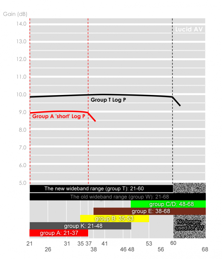

The Group A Log Periodic aerial picks up a narrow band of frequencies that matches the range from the Caradon transmitter. It is 'deaf' to signals further up the frequency range. This sort of selective reception can have benefits in areas where a house is located in the overlap area between two transmitters on the same polarisation.
A standard Log Periodic aerial is capable of picking up the entire frequency range. In my case I pick up North West TV in the Granada region from Winter Hill, but also some transmissions from the Emley Moor transmitter over in the Yorkshire TV region (YTV). That's not a particular problem though because after tuning the TV I then select which region has preference and so the TV forgets about the YTV stations. In some areas of the country that sort of thing is not so easy to do, so a Grouped Log aerial makes selecting the reception from a preferred transmitter easier to do. The same thing can be accomplished with filters that only pass certain frequencies.
The graphic below shows the Group A Log in red and the wideband T Log in black. At the bottom of the image you'll see the TV transmission range given in channels (21-68). Channels 60-68 are no longer used for TV; they've been sold off to the mobile phone companies for 4G. A wideband 'T' Log Periodic aerial is designed to pick up from channel 21 to ch 60. You can also see the other groups, some of which predate the 4G sell-off. You don't need to spend any time getting your head around the other groups as they're not relevant to your needs.
The other thing you can see in the graphic is the scale on the left edge. The Group T Log produces more signal because the aerial is longer.
