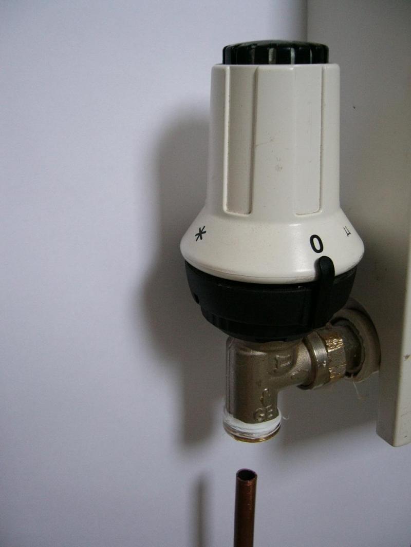

1. Did you just renew the pipework
2. Are the TRV's two-way
3. Are the lockshield valves open
4. If the TRV's are old unidirectional types, have you plumbed it correctly re: flow/return

TRVs are Danfoss but I can't find a part number. Have attached a blurry pic. Plumber who was going to do the work, then was too busy, said they were unidirectional BUT I know some aren't on the flow. Then again I have a couple of non-TRV'd towel rails in the system and they aren't getting any warmth either. Was going to try shutting some of the rads off to see if the cold ones come to life.
Building's 22 metres long and I have only fitted air vents in loft in the middle. Wondered if they should be at either end, too. There are 18 rads, and with the additional of extra wall drops, a lot of pipe so, I guess, huge potential for trapped air. If, say, one of the (new) automatic air vents didn't vent, could that do it, too? One weeps a bit of water and just wondered if it wasn't working properly. Then I wondered if I'm asking too much of the pump Grundfos 15-60 130 although, as I said previously, it used to work fine on the slow speed before.
Just found someone else's TRV (below) which is the same as mine and shows the side I can't see. Are these unidirectional?
