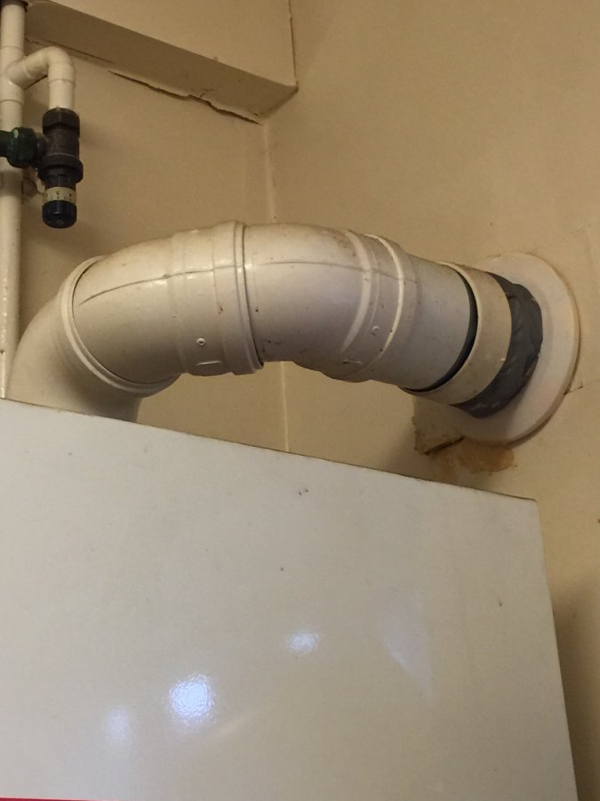

We do not have enough information to judge really. Can you post a picture of the paperwork left and some better quality pictures of the installation?

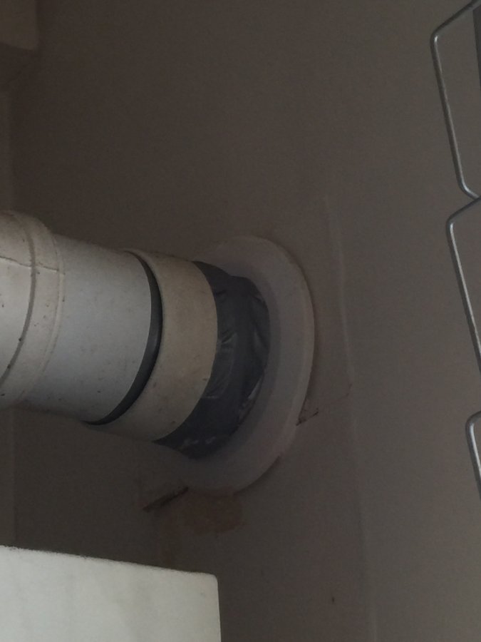

It is still difficult for me to come to any conclusion from that picture.
However even if it is not correct, then the leakage would be likely to be of room air into the boiler! Not dangerous products of combustion into the room.

That looks live an old weather sealing collar or old flue that the current flue has been inserted through and used as a sleeve possibly because it looks as if the flue is fitted through an air vent, cant see any danger there but I am only going by a photo possibly the attending engineer spotted something else
I also expect that will be the case Ian.
But if I had been there I would have removed the tape to see what was underneath.

If the tape was removed it is quite likely to show that the flue outer is intact and there is no joint.
So quite safe.
That's why I would have removed it to see exactly what the problem was.
But then I would be charging the independent's rate. If a contract rate of about £15 then I might be inclined not to bother.
But its quicker to remove tape to check safety than to write out all the warning forms. So not obvious why he did not want to check it properly.
To properly check it will need to remove the duct tape.
As it is still there he obviously did not remove it!
