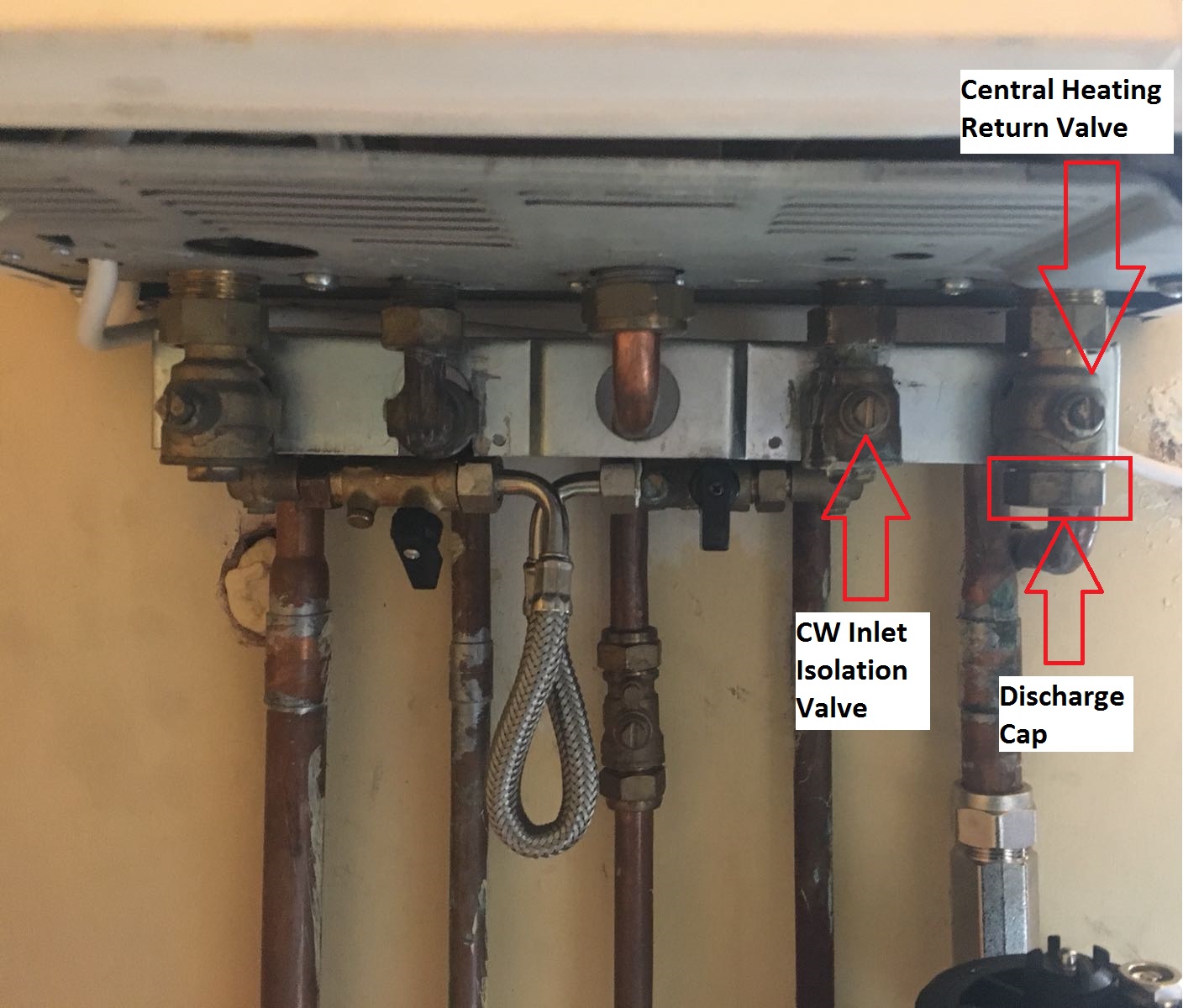

Hi there
I know this is an old post but I’m looking to do the same as mine is kettling at the mo, however I am unsure of some of the terminology.
First off, where can I find the heating return isolation valve
Second, which cap are you referring to?
Lastly, what is the CW inlet?
I’f anyone has any pictures they would really help.
Thank you

I did but without knowing what’s what I can’t pinpoint anything
I can manage the work it’s just knowing the steps. I’ve done work in the past in my system, for example I’ve drained the whole ch system and fitted new lsv and even fitted a magnetic filter however with replacing the secondary heat exchanger id like to know what’s what before I make a start

Ok i think ive sussed it. Can someone please confirm that i have the correct valves highlighted in the attached image.
Thanks :)

Those are probably the right valves. Not sure about the cap to unscrew; maybe someone else will comment.
The instructions you've quoted don't mention closing the CH flow isolation valve. I think you probably should, if the intention is to drain the boiler while leaving the rest of the system filled.
In any case, be prepared for water to escape whenever you unscrew something. Make sure the boiler electricity supply is off, and consider covering the electrics with something waterproof.

The instructions from Rob above did say to close heating return valve.
