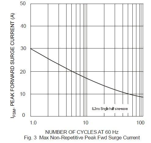

Peak currents are time limited, the thermal mass of the diode determines how much peak current can flow and for how long before the diode overheats to the point of destruction. A bridge rectifier rectifying AC will be dissipating the heat from 4 diodes. When the same bridge rectifier is used with a DC supply only two diodes are dissipating the same amount of heat that 4 would be when the supply is AC. Running on DC the maximum safe continuous current may be less than the maximum safe continuous current for AC. The derating for use on DC depends on the construction and method of heat disipation inside the bridge rectifier
Yes, I agree with that, but I'm not really sure what/why we are arguing about. As I said, the use of a diode bridge to achieve supply polarity independence for DC equipment is very well established, and I have used in countless times (for currents varying from trivial to very large) over the years/decades. All that matters is to make sure that the diodes can cope (at operating temperature) with the DC currents involved - not a problem with present-day components. Nor did I necessarily mean custom-made 'bridge rectifiers'; on the contrary, I've usually used discrete diodes for this purpose.
Turning to technicalities ... as for the maximum peak current being time-limited, that's true, but that current limit rapidly falls when the over-current is frequently repeated, as obviously is the case with AC applications). If you consider the ubiquitous IN400x diodes, they are rated for a maximum continuous rectified current of 1A, but a 'non-repetitive peak forward current' (one half cycle of 60Hz size wave, approx 8.3mS) of 30A. However, when that half cycle is constantly repeated, the maximum permissible peak current rapidly falls:
As you can see, after just 100 cycles of 60 Hz (less than two seconds), the peak permissible current has fallen from 30A to about 8A (corresponding to ~5.6A RMS), so goodness knows how low it gets with continuous AC.
Kind Regards, John
In almost all diodes peak current events will not alter the diode in the long term provided the events are under the line on that graph. Any number of events can occur provided the overall average current, (averaged over several minutes), is less than the maximum continuous current.
Problems arise when the diode has been carrying it maximum rated continuous currrent for some time and is also close to it maximum junction temperature. A single peak current event will then even though apparently under the line will be enough to take out the diode or alter its junction structure enough to weaken it. Hot and stressed and therefor highly active ions migrate vibrate a bit too much and get across the semi-conductor junction
Some specialist diodes, mainly RF and microwave will suffer a degree parametric change when a peak occurs, designing with these includes eliminating peaks with protective circuitry or knowing how many unavoidable peaks can occur before the diode has to be replaced..
Yes, that's obviously implicit in what the graph is all about. However, as I'm sure you understand, my point was that the graph covers less than 2 seconds of continuous AC, so one wonders how low the peak current would have to be to still be 'below the line' after a few hours of continuous AC. The curve is, admittedly, starting to 'flatten out' by 100 cycles, but it is still very much 'going down' at that point. ... or am I missing something?
Kind Regards, John
