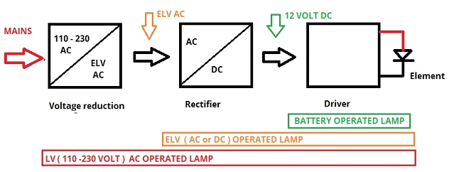

The three most common type of LED lamp are
(a) Battery operated lamp which has just a driver and element(s)
(b) ELV lamp which has rectifier and driver and element(s)
(c) Mains lamp which has voltage reduction and rectifier and driver and elements
Some ELV operated lamps will not accept a ELV DC supply.
When an ELV lamp is supplied with ELV AC 50 Hz reduced from mains voltage by a magnetic transformer there are few if any compatibility problems. Some ELV Operated lamps will not operate on a DC supply
Items labelled as "electronic transformers" are Switch Mode Power Supplies
An electronic transformer does not produce an ELV AC supply at 50 Hz hence when the ELV supply is from an electronic transformer compatibilty cannot be assured and the risk of unstable operation of the driver is high.
The majority of electronic transformers produce a fluctuating DC voltage that averages out to the rated voltage. The fluctuations can include voltage spikes large enough to damage the electronics in the driver. The fluctuations can disturb the operation of the driver resulting in unstable control of the current driven through the LED element.
An item labelled as an LED driver should not be used to supply power to any type of lamp other than one or more LED elements connected in series.
An LED driver is designed to drive ( force ) it's rated current through what ever is connected across it's output terminals. The voltage on the LED driver's output will be set such that the rated current is flowing out of the driver and through the item connected to it. If the item being supplied normally takes less than the LED driver's rated current then the LED driver will increase the voltage on it's output until the rated curren is flowing. This high voltage and excessive current will damage the LED driver inside the lamp.

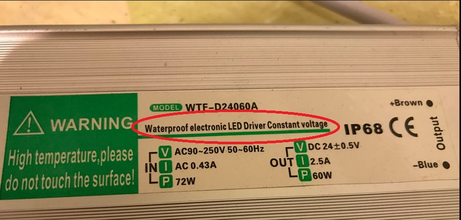

1) Low Voltage does not begin at 100V.
2) Whether you like it or not, there ARE products out there which are called Constant Voltage LED drivers, and your warning at the end does not apply to them.
They are incorrectly labelled then aren't they? If someone incorrectly calls a pig a cow, that means they are ignorant. It does NOT mean that pigs are cows.
If someone wants a pig and finds one for sale and it's called a cow, if he buys it he will get a pig.
Whether you like it or not, there ARE products out there which are called Constant Voltage LED drivers.
You cannot change the reality that people will encounter them for sale by pretending that reality is how you wish it were rather than how it is.
Reality does not work like that.
More to the point if someone wants a cow and buys one only to find it is a pig he will *issed off.
there ARE products out there which are INCORRECTLY called Constant Voltage LED drivers.
The reality that you promote is a false "reality" that should be corrected to reduce the amount of confusion and damaged equipment that it causes.
An LED cannot be driven by a Constant Voltage LED driver without the LED being at significant risk of being damaged by over current. (*)
An LED lamp with integral driver can be supplied from a constant voltage source
(*) there are LED elements that have a resistive junction incorporated into the semi-conductor assembly. They can be connected to a 3 volt DC supply and were developed for mass production of long low brightness strings of LED.
Then go and fix the problem at source.
Do not attempt to fix it by telling people things which are untrue because you wish they were, for that will not work.
That will come as surprising news to anybody who has ever used a constant voltage source such as a battery to power LEDs.
And that remains true when that source is described as a constant voltage driver.
Basically, Bernard, will you just (£$&%*(%#@ GET OVER IT!
You are not, absolutely not, going to rid the world of products whose labelling you do not like by pretending that they do not exist, or by deliberately misleading people by giving them "advice" which is distorted by the lens of your desire.
Looks like this manufacturer labelled the product correctly,
An LED cannot be driven by a Constant Voltage LED driver without the LED being at significant risk of being damaged by over current. (*) .... An LED lamp with integral driver can be supplied from a constant voltage source.
Indeed - and I would say that we have here another potentially troublesome sloppy use of terminology - since a high proportion of people (including manufactures and retailers/wholesalers) are using "LED" to refer to a "LED lamp" (with integral driver) - leaving us having to qualify "LED" if we want to refer to what "an LED" originally was (i.e. an 'LED element').
We wouldn't dream of calling an incandescent lamp/bulb (aka "a filament bulb/lamp") "a filament", so I don't know why this misuse of "LED" arose.
Kind Regards, John

Well done on starting writing.
1) Noticed a typo in following where I feel heating would be better as being lighting (as the article is about lighting):
"A Switch Mode Power Supply with an output rated at 12 v DC (eff) will produce an output that if supplied to an incandescent lamp would have the same heating effect as a smooth 12 volt DC supply from ( for example ) a battery."
2) Symbol for "volts" is normally capital "V" not "v".
I used heating effect because the current heats the filament, light is only produced as a "by-product" of the filament being hot enough to emit light.
How about simply
... will produce an output that if supplied to an incandescent lamp would have the same effect as a smooth 12 volt DC supply from ...
