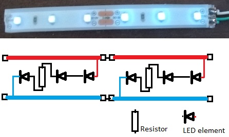

My question is can a simple circuit be made to run these strips of 12 volt DC to make up some basic light boxes that can be used in a van.

LED strip like this
requires a DC power supply that is constant voltage. The current through the LED elements is controlled by the resistor. The current is typically 20mA per group. A group is one resistor and 3 LED elements. The number of groups will determine how much current will be taken from the power supply
An LED driver with a constant current output will force it's rated current onto the strip irrespective of how many groups are on the strip.
If the constant current is set at 350mA and the strip has 18 groups then the strip will take the rated current from the driver with approx 20 mA through each resistor. The voltage on the driver's output will be about 12 volts
If there are less than 18 groups then the driver's output voltage will increase. For example if there are 9 groups then the driver's 350 mA will require approx 40mA to flow through each group leading to premature failure of the LED elements The voltage on the driver's output will be about 24 volts.
Connecting the strip(s) to via a switch to either a 12 volt supply or a 12 volt battery is all that is needed.
