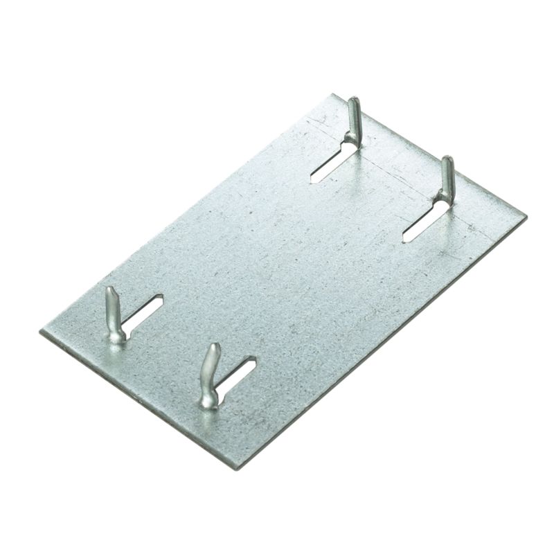

If you have to notch the joists then you can use these,
5014316862288_001c_v001_ap
These will prevent the penetration of nails and screws. They are called "safe plates".

You can on top side but safe plates need to be installed or if you are my Building C.O. a length of metal trunking lid or 3mm steel plate.
