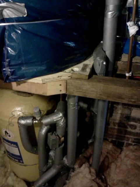

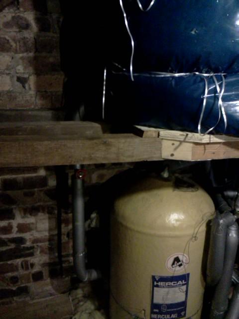

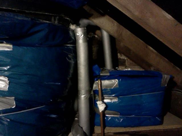

OK, I have some measurements - hope it helps....
From the BOTTOM of the cold water tank to the TOP of the hot water tank there is a 32cm gap.
From the BOTTOM of the cold water tank to the BOTTOM of the hot water tank there is a 120cm gap.
The pipe comes out of the cold water tank at the bottom and goes down into the bottom of the hot water tank and is about 90-100cm in length.

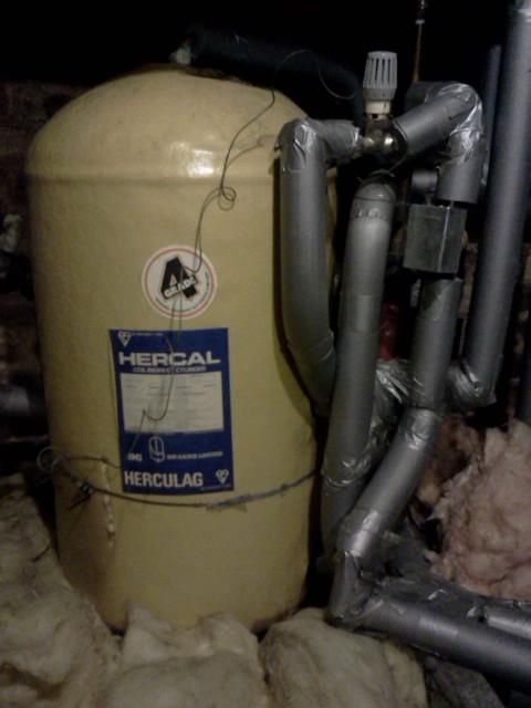

Does the shower hot supply have its own dedicated flange on the hot water cylinder, or is it shared with all other hot taps?

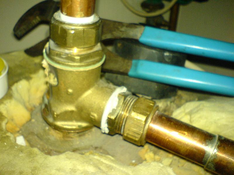

Looking at it, there is one pipe that comes out of the tank and the pipe for the shower looks as though it is spurred off fairly close to the tank with some sort of valve.
Do both of these pipes come out of the flange on the top of the hot water cylinder?
Or, does one pipe come out of the top flange, and the shower pipe is joined to it further along?
Sorry, you have confused me by answering no to two different questions.
Do you have two pipes (pipe on the right in this pic goes to shower) joined at the top flange, like in this picture?
