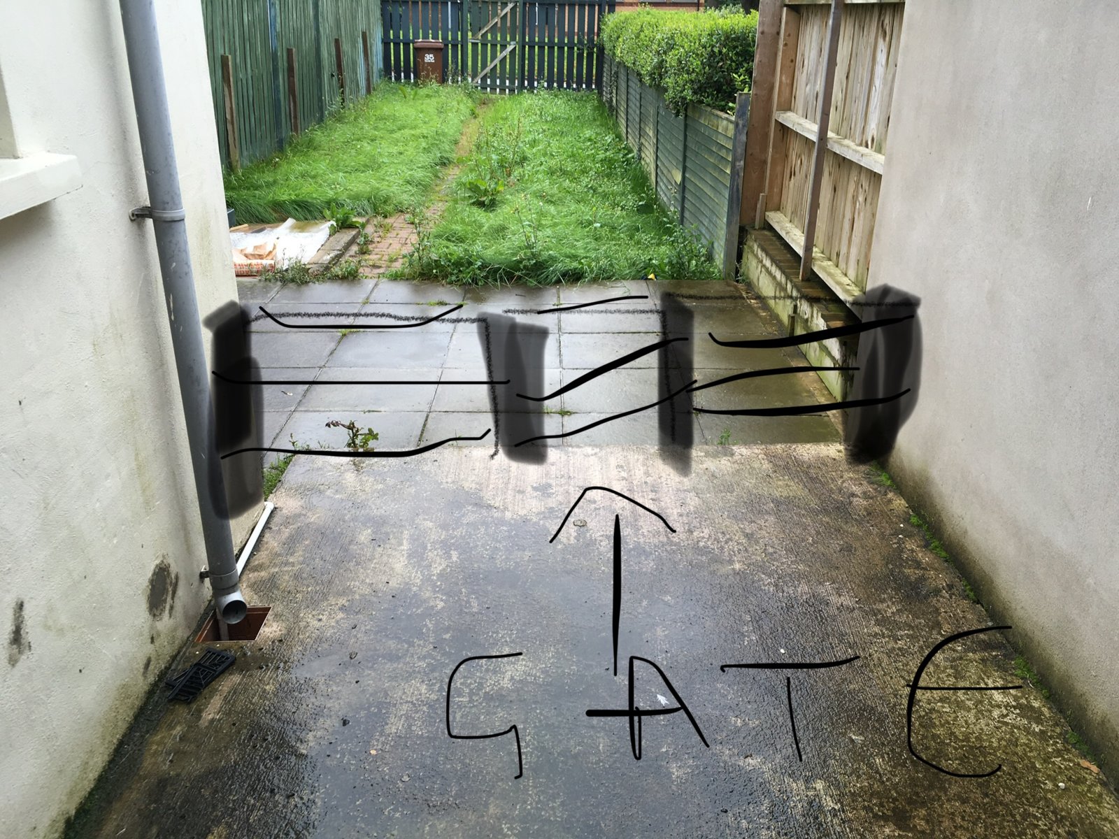

i have a small patio area out the back and would like to have a small boundary picket fence with gate. I have been quoted from £300 to £550! I have attached a picture with a crude outline of what I mean. There is no way in hell I am paying that amount of money for a basic picket boundary fence for all the size of it. I can get a picket fence and gate around the corner already built
https://www.eglantinetimber.com/round-top-fence.html
I have never built a fence or gate in my life. Are there any websites that’s outline the process? I would imagine it’s 2 posts either end with the fence attached then the gate but how will the gate be connected as I can’t drill a hole for the posts for them as there is a concrete base?
Thanks in advance

you can fix a post to the side of your own house, but not your neighbour.
You can lift the paving slabs to dig post holes which may be easier than breaking the concrete yard. It's possible to get post brackets that you bolt down to concrete but the design is not very sound so they will break out if bumped hard or possibly if someone climbs or leans on the post.
The gate posts need to be strong to withstand opening, closing and swinging of the gate, especially if a child gets near it.
If you take up slabs for the posts you will have to cut a post-sized hole in the slabs, preferably a corner with an angle grinder. Other methods will crack the slabs.
If it was me I would sink concrete spurs into the ground, and bolt wooden posts to them. Then when the wood rots it is easy to replace without digging. You can also bolt on taller posts if you decide later you want a tall fence.
After you have done all this work you will think that £350 to £500 was very reasonable.

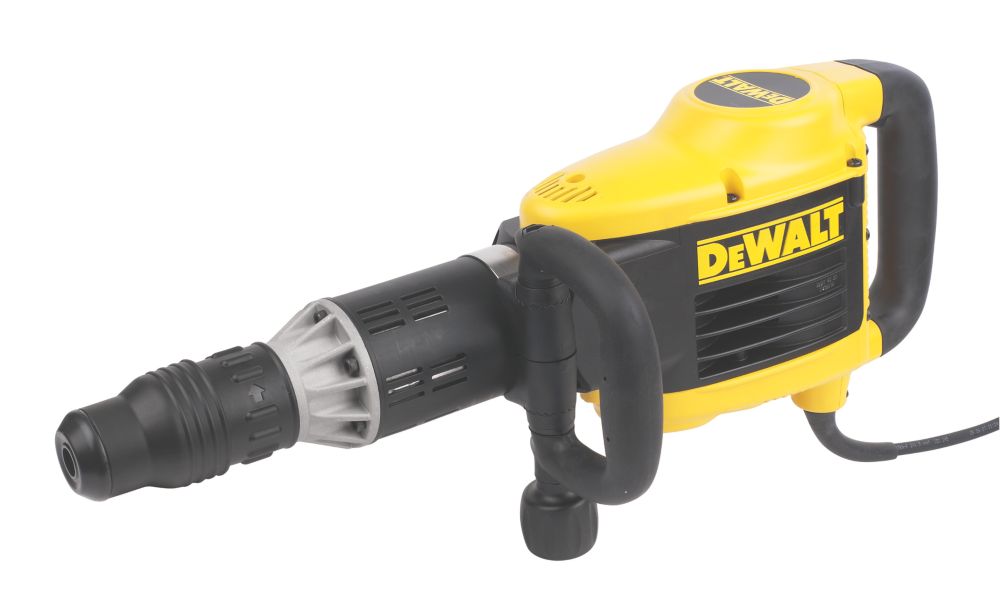

You can buy or hire a concrete breaker

It is quite hard digging a post hole 2 feet deep down a small hole in concrete.
Then you will have to lay new concrete to patch the hole.
