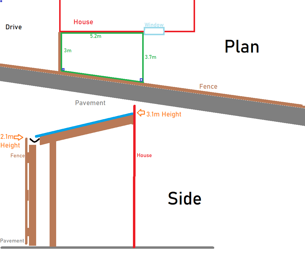

Hello and thanks for taking a look.
Our garden is enclosed with a fence that returns to meet the side of the house and I want to made dry a section around 17 Sq/m with a simple lean to using polycarbonate roofing. Not done this before...
Can anyone please advise on timber sizes?
Not sure of centres- will probably go with something that matches polycarbonate widths...?
It will be enclosed at the drive side- only open at the wider end, (there is a 6' gate to driveway not shown.
See pics for sizes. I have looked for span tables but cannot find any(thing simple like me).
At eaves end, I want the gutter to stop along the edge of the current fence so it will keep out the rain. Shame the area is not square....
Plan view shows the roof only having x2 support posts. With a 5.2m span? Thinking x2 5"x2" nailed and bolted together?
I want to make it independent of the fencing as I expect it will be the fence that needs replacing next.
Internet says no need for planning. I think it's a very steep pitch so maybe it can afford to be on the skinny side- timbers wise... but then the gutter up to the fence top design would hold snow... But not much snow in Somerset..
And if anyone knows peasant logic ways to get the angles and birds mouths correct (as I have no common joist lengths :( ....I'd be grateful of any tips/pointers...
Any thoughts/pointers much appreciated.
Thanks, M

I'm not a builder but for a <4m span and you're only worrying about snow and burglars in terms of load, 5x2 sounds ample to me.
You also have to worry about the whole thing falling over like a pack of cards which would be the odd diagonal. On trussed roofs they just put a long timber like an old school floor board diagonally across the rafters in both directions.
In terms of the birds mouths you can look on youtube for much better explanations. But your other problem will be the varying span, as you would probably want to keep the pitch constant rather than it looking like it's slipped down at the back edge. That means either your eaves need to be higher at the front, or the bit next to the wall needs to be higher at the back. That would make your angles all the same but the lengths would be different still.
I'll let the pros come up with a more detailed explanation, or just go through on youtube and watch them at work.

I think you'll be stiick with varying pitch- sloping wall plate or sloping interface with fence will look very odd. Might be a good idea to mock it up with some screws in the house wall (where the plate will go) & along the top of the fence, run blue polyprop string where the roofing edges will be and see what it looks like. Remember you won't notice the pitch variation inside the leanto, it'll only really be visible when you look from above or to the side. Your baby roof idea with valley would be hard work & give you either lower headroom near the fence or a big hole for the wind to get into.

5" X 2" rafters will probably do fine. Roofs are more complicated than I thought.
A sloping wall plate is beyond my skill and I think would look weird. I cant imagine the trouble I would get into making a variable pitch roof.
Current plan is to set wall plate level. Set eaves support rail level and square, i.e. rafters will be common length from high end to birds mouth.....but...at the narrow end of the lean to the eaves will overhang by a whisker, and at the wider end by 600mm.
Only this will take the roof line over to the fence which runs out away from the house by 600mm.
It will also make the facia drop approx 200mm end to end but as it will be against a fence no one will see it....
Providing my birds mouths aren't too sloppy, 5"X2"s won't sag, or will they?
Hadn't done the sums before but if you've only got 200mm to lose across 5200 then I withdraw my objection to twinwall or corrugated iron (the curved stuff) on a variable pitch roof. The joint bars on the twinwall might be a chew to fit but apart from that you'd be fine (200mm across 5200 comes down to 40mm per metre which is nowt).
With your new scheme the vertical support post 600mm from the fence is going to reduce your usable area and be tricky to brace in any meaningful fashion without reducing usable space even more. And you'd be committed to the gutter running down towards the wide end at a somewhat steeper angle than guttering normally runs at.
Yes that is a fairly steep pitch but not unheard of- you might have problems with rainfall overshooting the gutter and hitting your fence (which will accelerate the deterioration). Various ways of dealing with that- low-rent is run some big beads of silicon on the roof 200mm above the gutter (slows the water down), give the gutter a high back with some Code 3 lead or felt support trays.
If the fence is nearing end of life I'd suggest fixing it now and using the fenceposts as the support for your eaves (fix blocks level with the top of the fenceposts, sit your rafters and eaves board on top of the blocks, gutter runs above fenceposts).
Go with the variable pitch roof- no common birdmouths but that isn't the end of the world. You could work them out using trigonometry but it is much easier to set wall plate and eaves board then offer rafter, cut to length (remember angled cut at top and bottom), straight edge, mark, cut (remember same drop both ends) and fix.
5" x 2" will be fine for the rafters, one bonus of your steep pitch is snow load becomes a bit theoretical- it might snap the gutter off but it isn't going to overload the roof.
