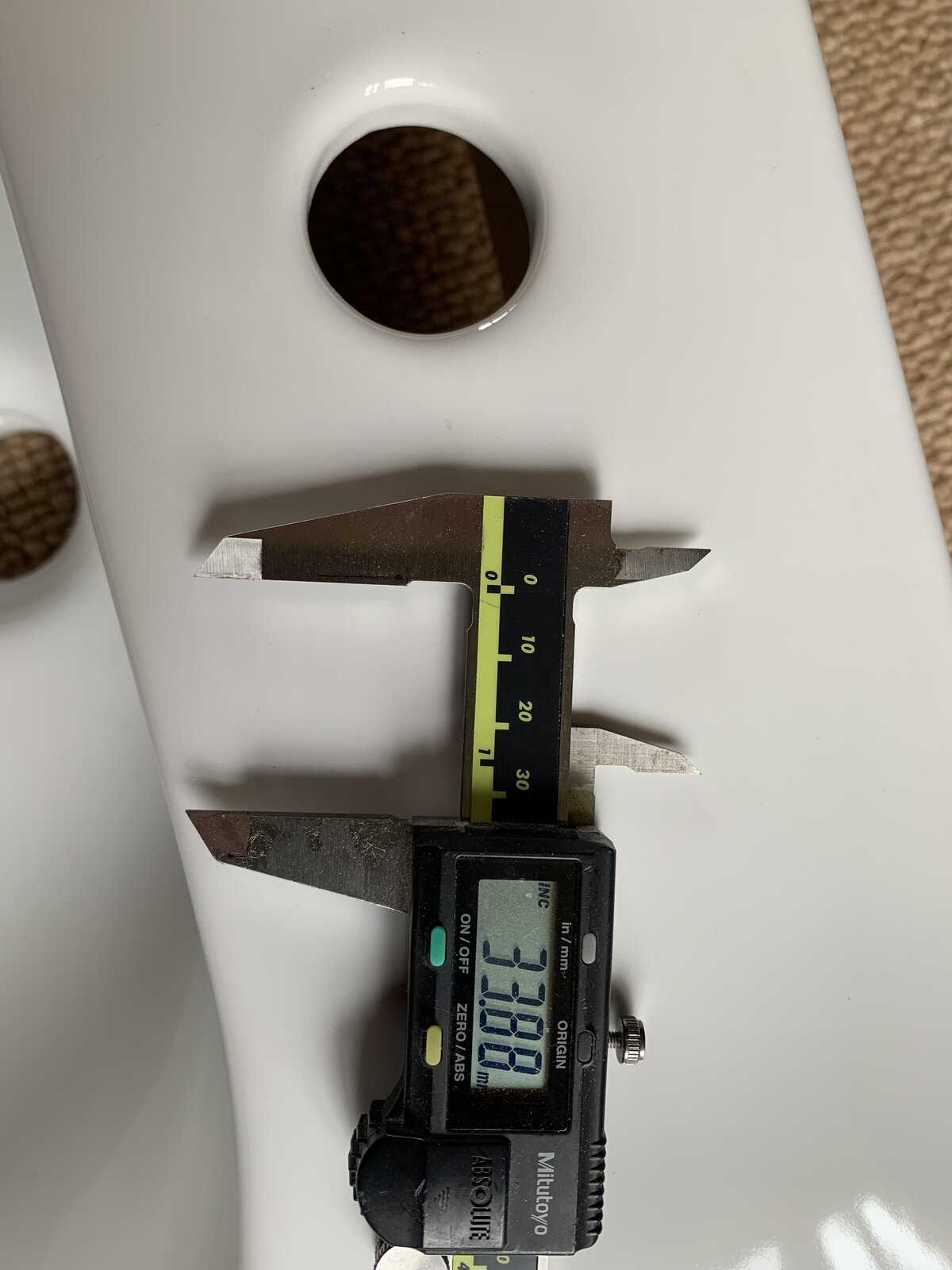

My new basin arrived and i note that the tap hole is not quite round and wonder if this is a problem; haven’t currently got a tap to test it with.
As per attached picture, the hole at its narrowest point is just under 34 mm. I wonder if this is going to be okay?
A round hole will let as much water through as a slightly non round one. Its the washers and nuts that keep it water tight, and maybe a bit of sealant.

I wasn’t thinking about watertightness, but more about the fact that the hole will be slightly smaller due to the oval shape And whether this will mean that I will find it difficult to fit the taps?
never fitted such things before, and so just want to check that the imperfection is not going to cause me problems, before it gets too late to return the basin if it is.
Mostly ,The whole tap body sits on the basin top. Through the hole are the 2 tap tails and anchoring bolt/s.
There are some designs that have part of the body going through the basin ,which is threaded,and a locking nut Secures it from below. But they are more for kitchen sinks rather than basins,I have certainly never come across one for a basin , others may have though.
Oh okay, I’m trying to fix a problem that doesn’t exist! Thanks for putting me straight.
One final question I have is that a couple of the taps I have looked at have bodies that are around 34 mm in diameter which is just about the size of the hole. Is there a particular minimum diameter tap I should be aiming for to avoid problems, or again am I trying to fix a problem that doesn’t exist?
There's a huge selection of basin mixers available ,and I would suggest you select one with a larger diameter. I have never actually measured the hole diameter of a basins tap hole ,and never come across a monobloc tap that doesn't fit ,but your measurement does seem a little tight for a tap with a 34mm diameter body / base.
