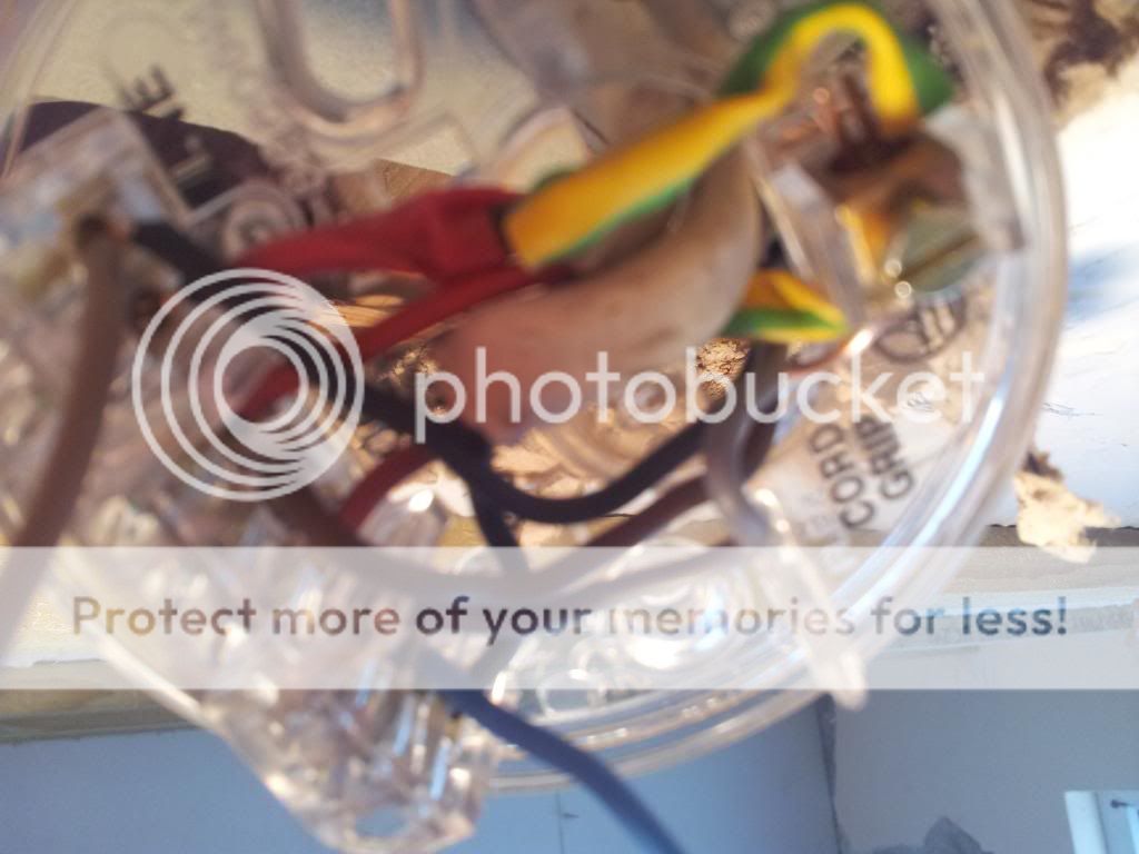

Hello folks
Fans working but only when I turn the light off :oops:
Any ideas?
[/URL]
I put in a Loop-In Batten Lamp holder, and copied existing wiring
Tried the wiring diagram that came with the fan isolator and got the same result, turn the light off and fan comes on :confused:
