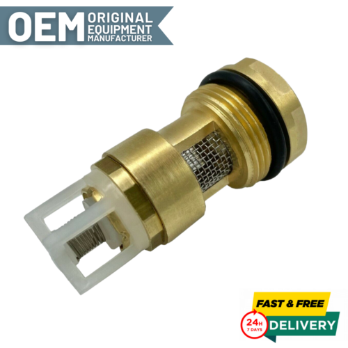

Personally i would be stripping out the venturi and probably discover that it has fell apart and needs changing at same time i would change the diaphragm
Had both out already. Diaphragm is not that old and looks fine, venturi looked old but OK.
It does seem associated with a lower flow, you could just run the hot only downstairs and keep reducing the flowrate very gradually until the HW goes cold and then measure this flowrate, the flowswitch probably operates at 2.0/2.5LPM so if the HW turns cold at > 3/3.5LPM then maybe worth renewing both the diapragm and the venturi.
If the d/stairs tap does flow hot at < 3.0LPM then maybe some xover occuring in the single lever u/stairs mixer?.
Edit: ensure DHW temp control turned to max when carrying out above test.
If its a baxi 80ECO then its minimum output is 9.3kw which means the HW temp (from mains at a now 20C) will be 57C at a flowrate of 3.61LPM so temp control should be at max or near it to avoid o/temp burner trip.
venturi looked like this ?
