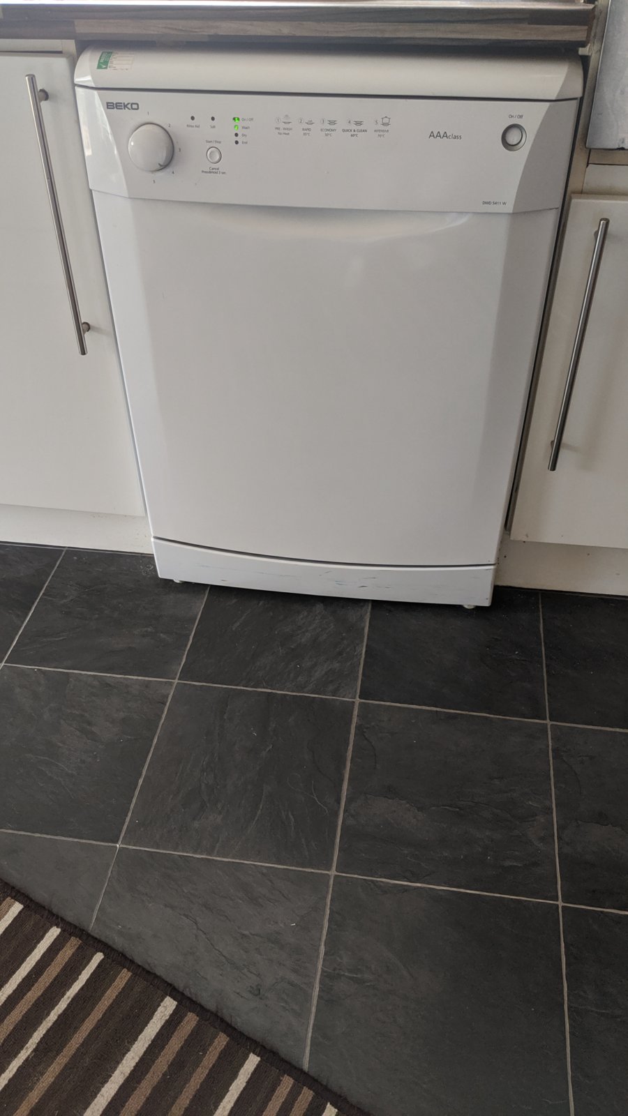

Ok just recently got a Beko 5411 from a friend as he is moving abroad.
All was working fine with cleaning and draining away
Now after 30+ mins after use ... water slowly appears inside

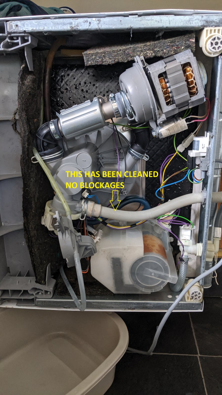

Have cleaned all inside filters and checked waste pipe with no blockages.
As I say it washes and drains fine but water slowly appearing inside after a bit of time
Try and upload pics tomorrow of what I can see

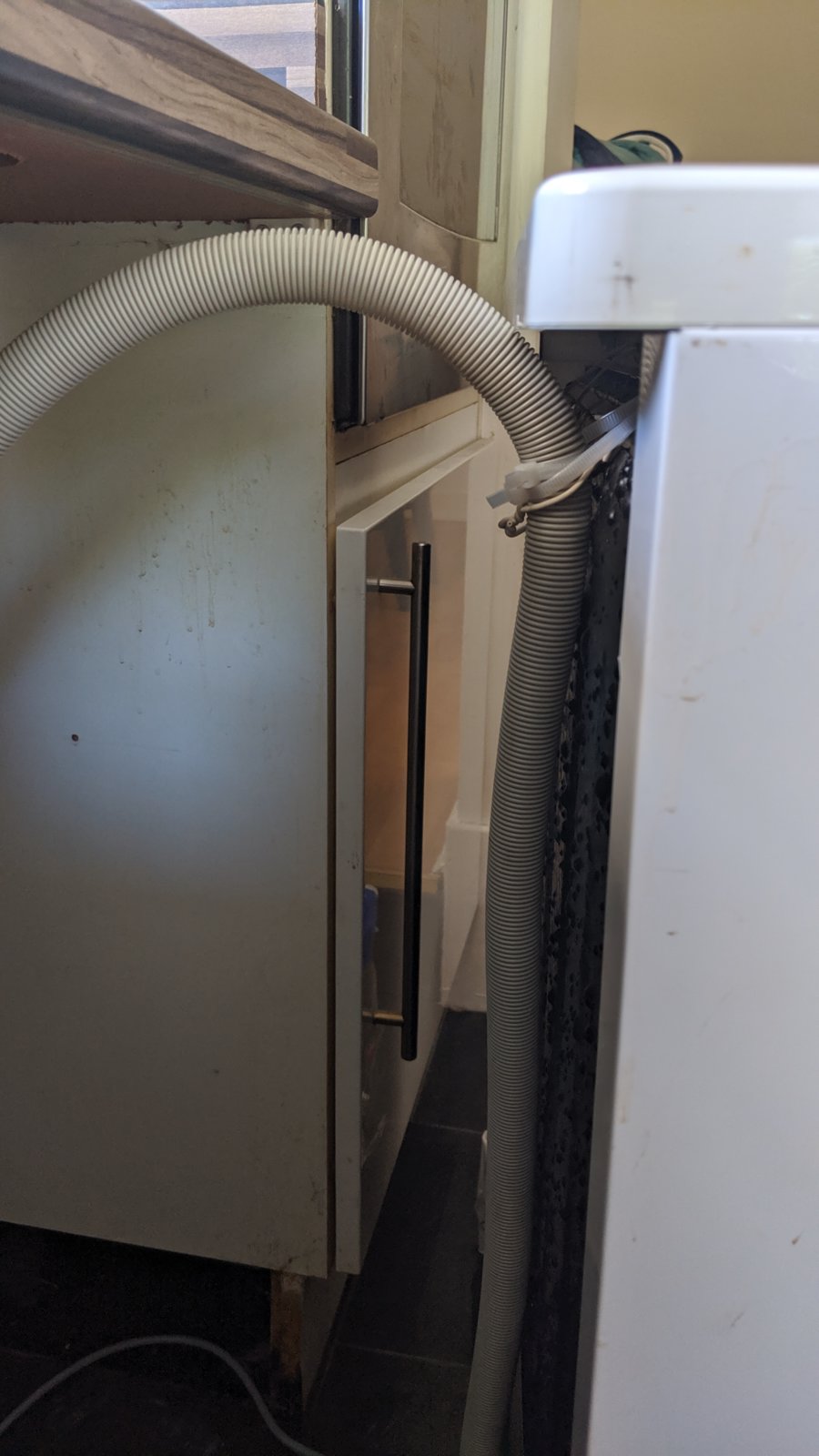

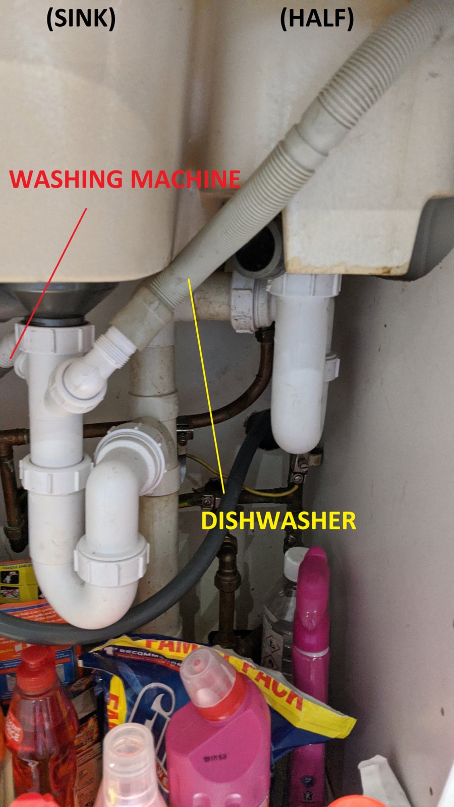

photos of the route of the waste pipe, and how it connects to the sink trap, are especially important.
Have you got some food colouring? If not, use tea.
Fill the sink with water, add some colouring, pull the plug out.
Watch the dishwasher (with the door open). What happens?
For some reason I could not log back in so had to make another account, sorry

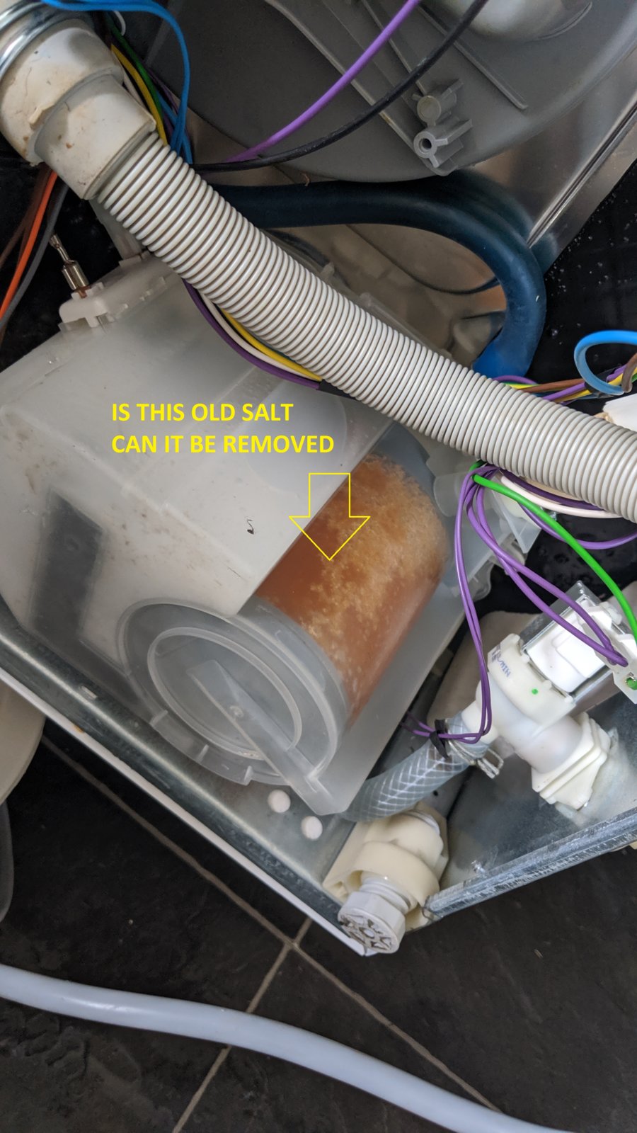

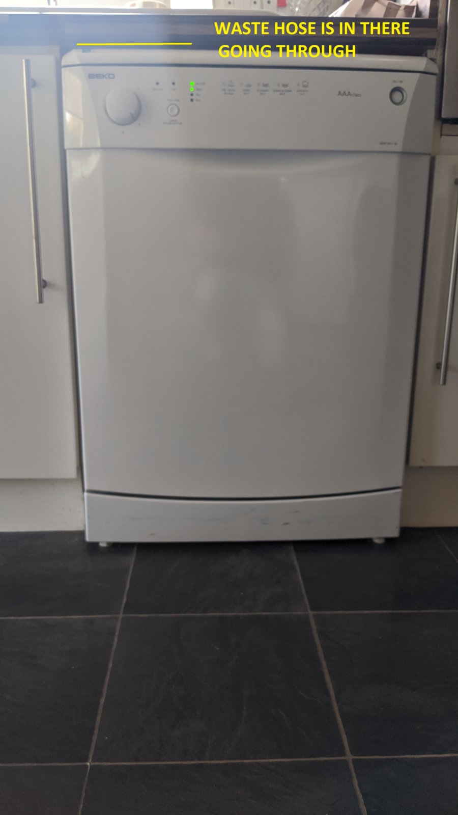

These are the pictures I have taken
Not sure where to start...

Most likely the inlet valve on the machine is letting a small amount of water in. Shut the water supply off and you should find it stops seeping in, then change the inlet valve on the machine. The brown part of the water softener is the crystals and that is the colour of them leave alone.
