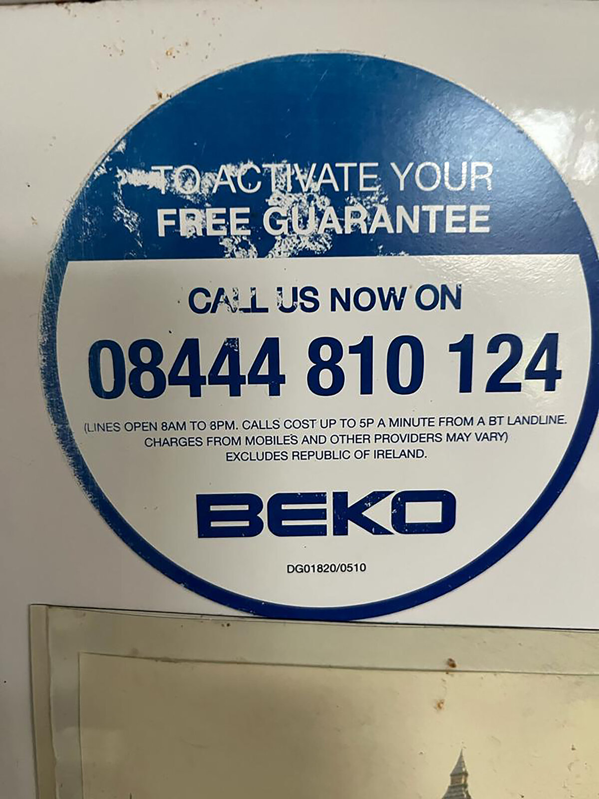

I'm having a major freeze issues with my BEKO Fridge Freezer where the fridge compartment is freezing over and acting more like a freezer than a fridge. Changing the temperature in the fridge compartment doesnt seem to make any difference. It is supposed to be frost free. Granted it is old but I would lik to try and fix it rather than buy a new one right now. Problem is I cannot find a product code/ model number for certain. There is a sticker on the font (attached). With the following code : DG01820/0510.
What I would like to try first is replacing the gasket seals as they are looking perished but the model number which I have is not being recognised by any internet site I have tried.
Does anyone have a sure way of identifying the correct replacement seals ? Thank you to anyone who can offer some advice.

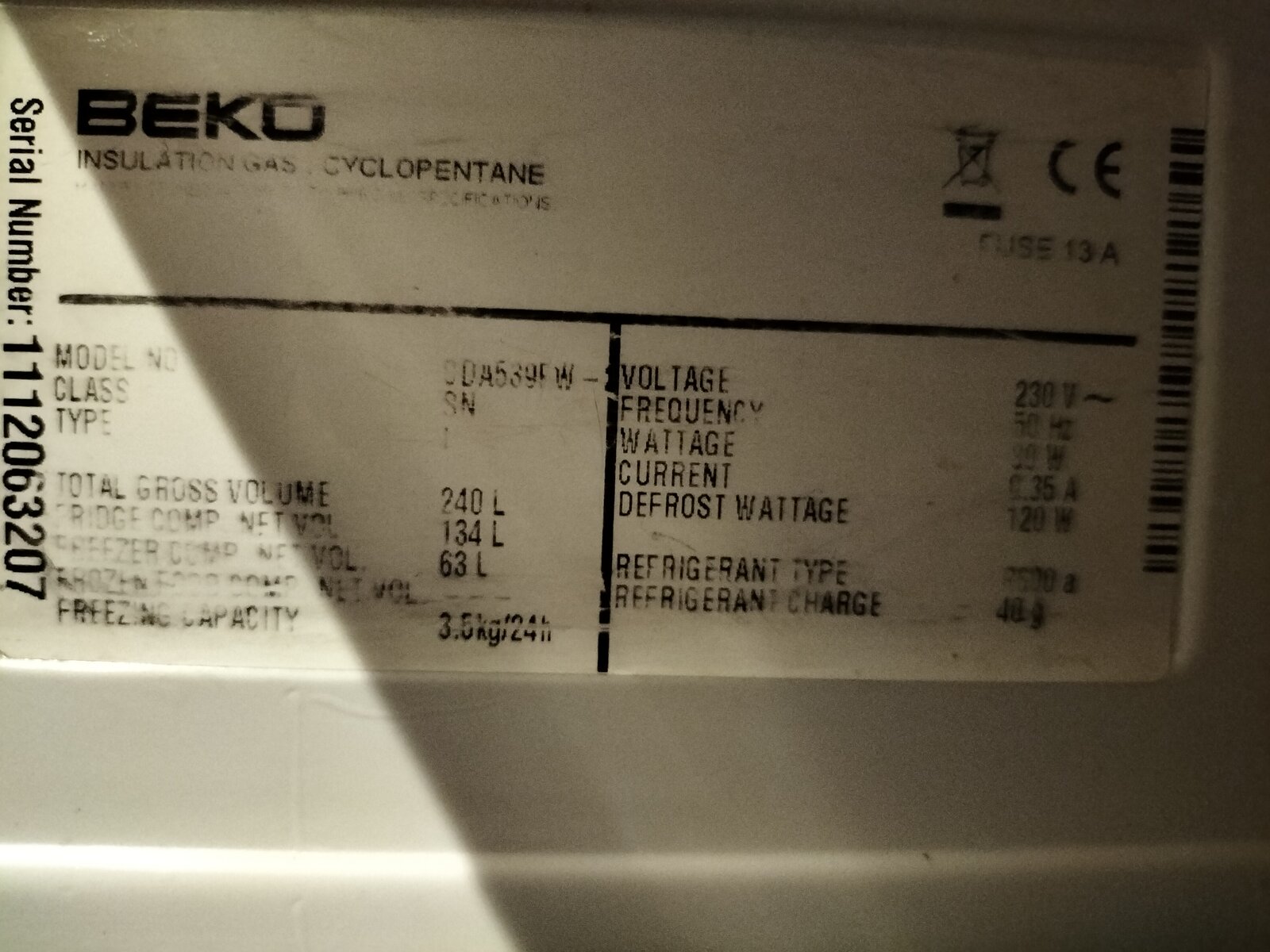

My data plate is on the LH inside of the fridge compartment just above the salad drawer, if that helps
That alone, reads as if it is the thermostat which has failed closed, rather than the seals.
UPDATE
@footprints thank you. On opening the fridge I double checked for any info panels as you suggested. And yea there was one. I would have put money on there being nothing in there, but there you go. Pays to double check, triple check. The tag is a bit ropey but I think I can make out the number. Now to see if I can get hold of a new thermo (thank you for suggesting @Harry Bloomfield ) and some gasket replacement. I'll update when I have any news. Thanks again.
