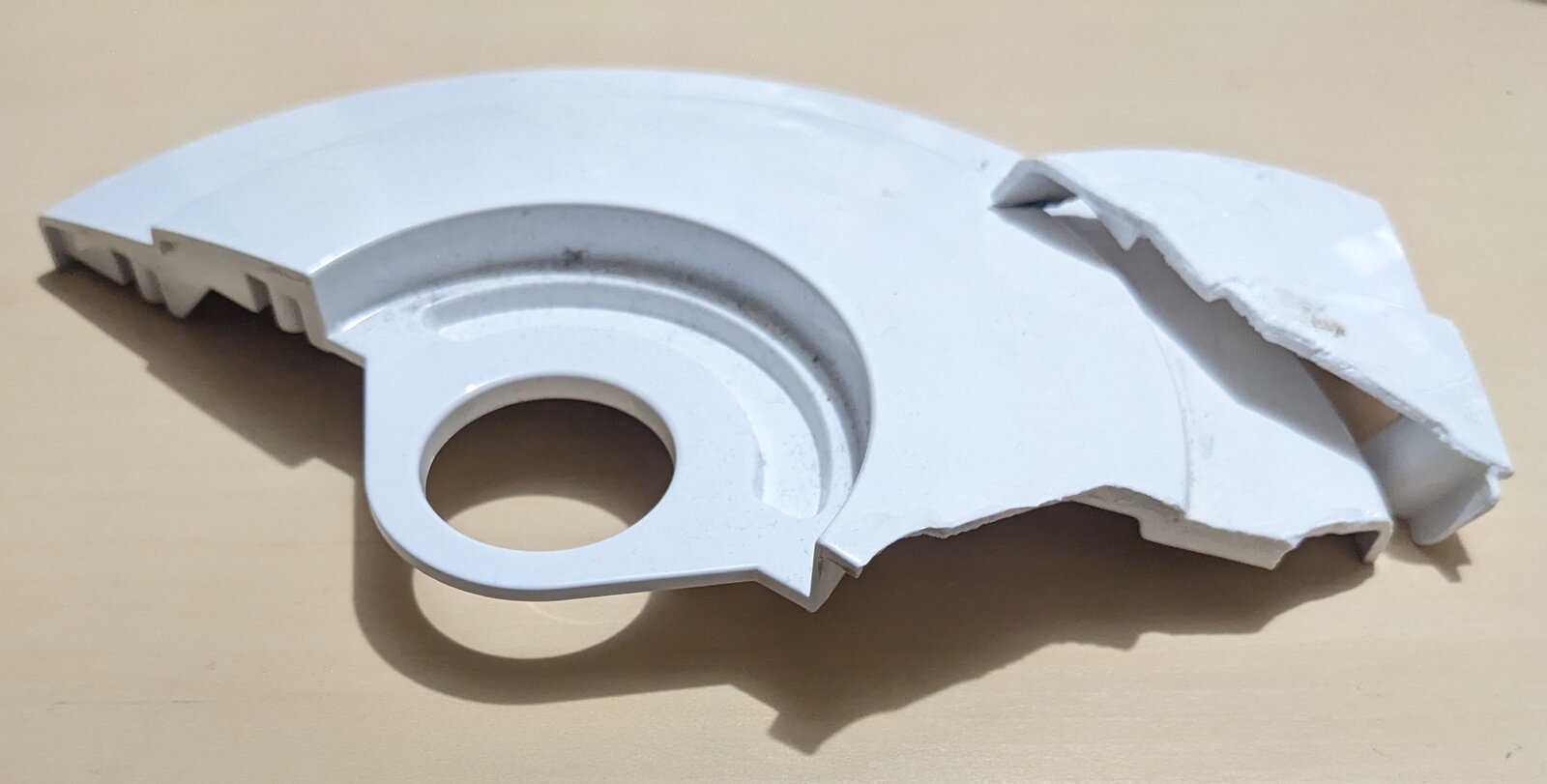

Hi all, what the best glue/adhesive for joining plastic together, need to join a plastic together that has snapped off/broken into two?

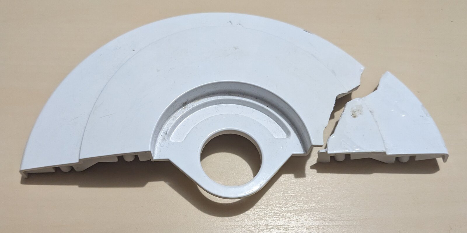

See the pics.. not sure what type of plastic it is..part of the bottom base of a tower fan
I tried standard super glue with no really success.. fell apart after a while
If there are voids in the design of base you could superglue then fill any voids with Fixall or similar glue which sets hard forming a stronger base.
Looking at the edge of that break, the outline looks a little powdery.
I've come across similar broken plastic, where the plasticiser has leached away, leaving the plastic powdery and very brittle.
As above you can try some reinforcement and super glue, or even epoxies. But if the base is getting brittle, I'm afraid this may just be a temporary fix.

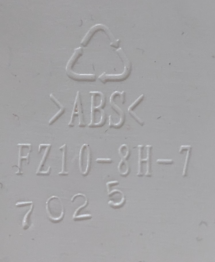

Turn the base over and look for a marking that indicates what kind of plastic it is, like "ABS". Without knowing what is it you'll be trialling and erroring a lot. Some plastics can be glued, some can be melted, some can't be repaired at all

ABS can be glued with pipe solvent cement - the glue melts the plastic on both sides, causing it to fuse together and the end result is typically around as strong as the original plastic was.
The problem you'll have is if you've tried glueing it with something else already and failed, you've now got a surface contaminated with other glue remnants. These need to be removed first if they've formed a layer that won't melt with the solvent cement, which then means the mating surfaces might not be such a good fit.
If you're in that situation I'd clean up the surfaces without changing their shape as best you can, apply glue to one side then press and hold together for a minute (solvent glue works amazingly quickly) then, using some other ABS pieces sourced from elsewhere, glue them across the crack on the hidden part of the foot to provide extra reinforcement
